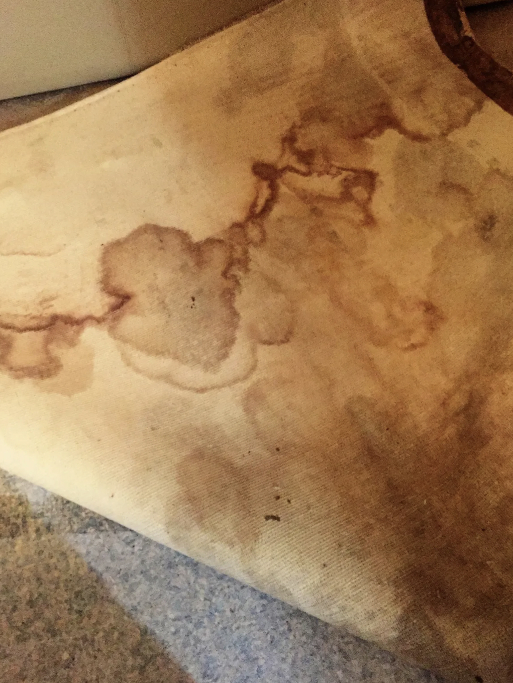

I easily avoided all of these issues yesterday morning on an older, white, dog urine saturated, residential carpet by using plenty of peroxide and a microfiber under the Phoenix.
I knew from experience that there was a strong chance of this stuff reappearing if I tried to HWE it. Because it was bone dry in 30 minutes, I reduced that to zero chance.
Why do I still own a truckmount again?
View attachment 118302 View attachment 118303
Were you using a peroxide encap or a separate type of peroxide? How did you apply it and how long for the dwell time?
Good job! To which encap juice can you add peroxide without interfering with the encap process?
Awesome Encap and GoOxy. 3 OPG each. Laid it on slow and heavy with the Phoenix onboard sprayer.

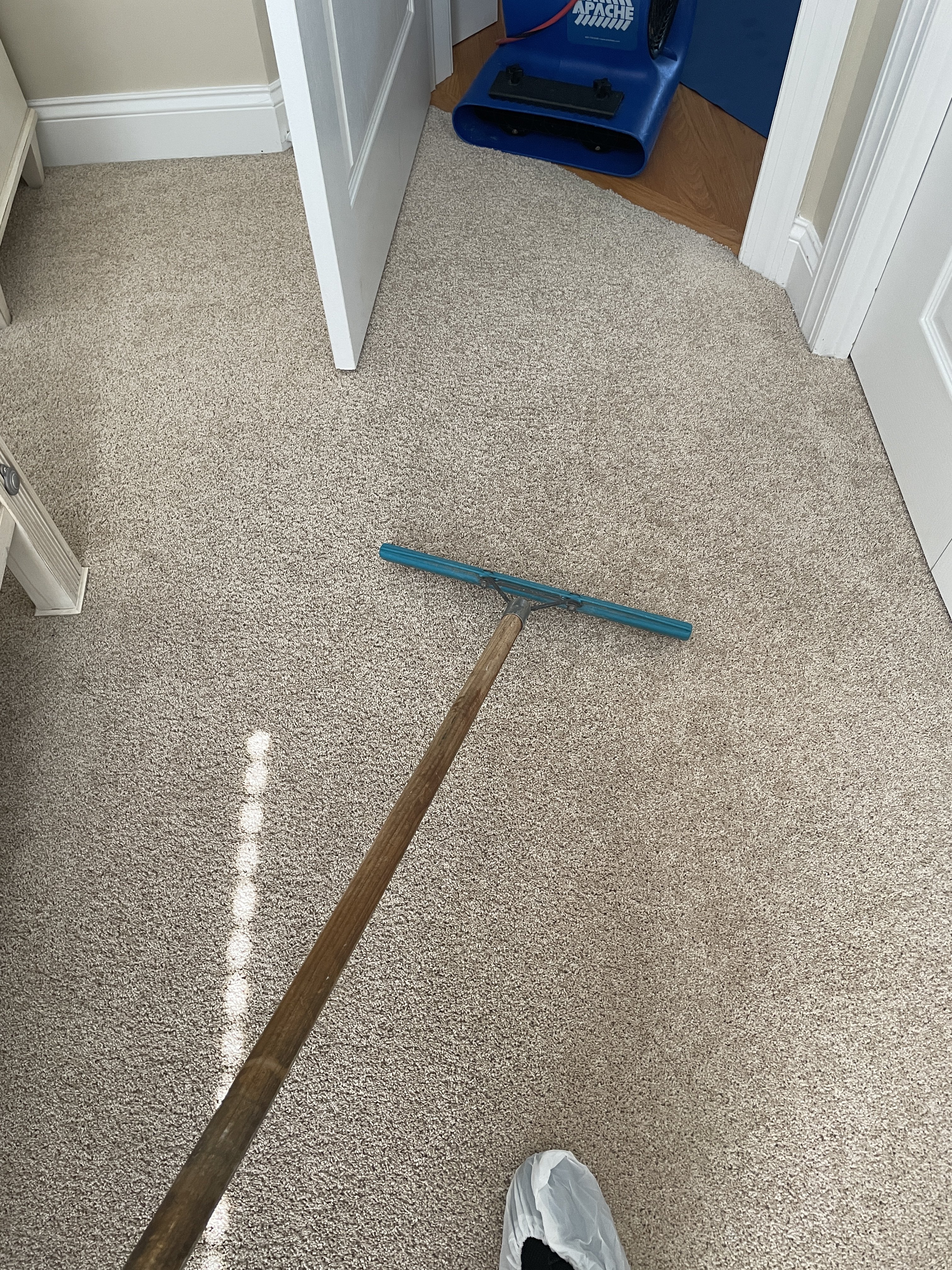

Was just over there a few hours ago, the clients are people I have known for years. Still smells like baby powder Awesome Encap. They're definitely happy with the result and the carpet was bone dry before I left. I run air movers in each room at every job, I have had dry carpet in less than 10 minutes using VLM.

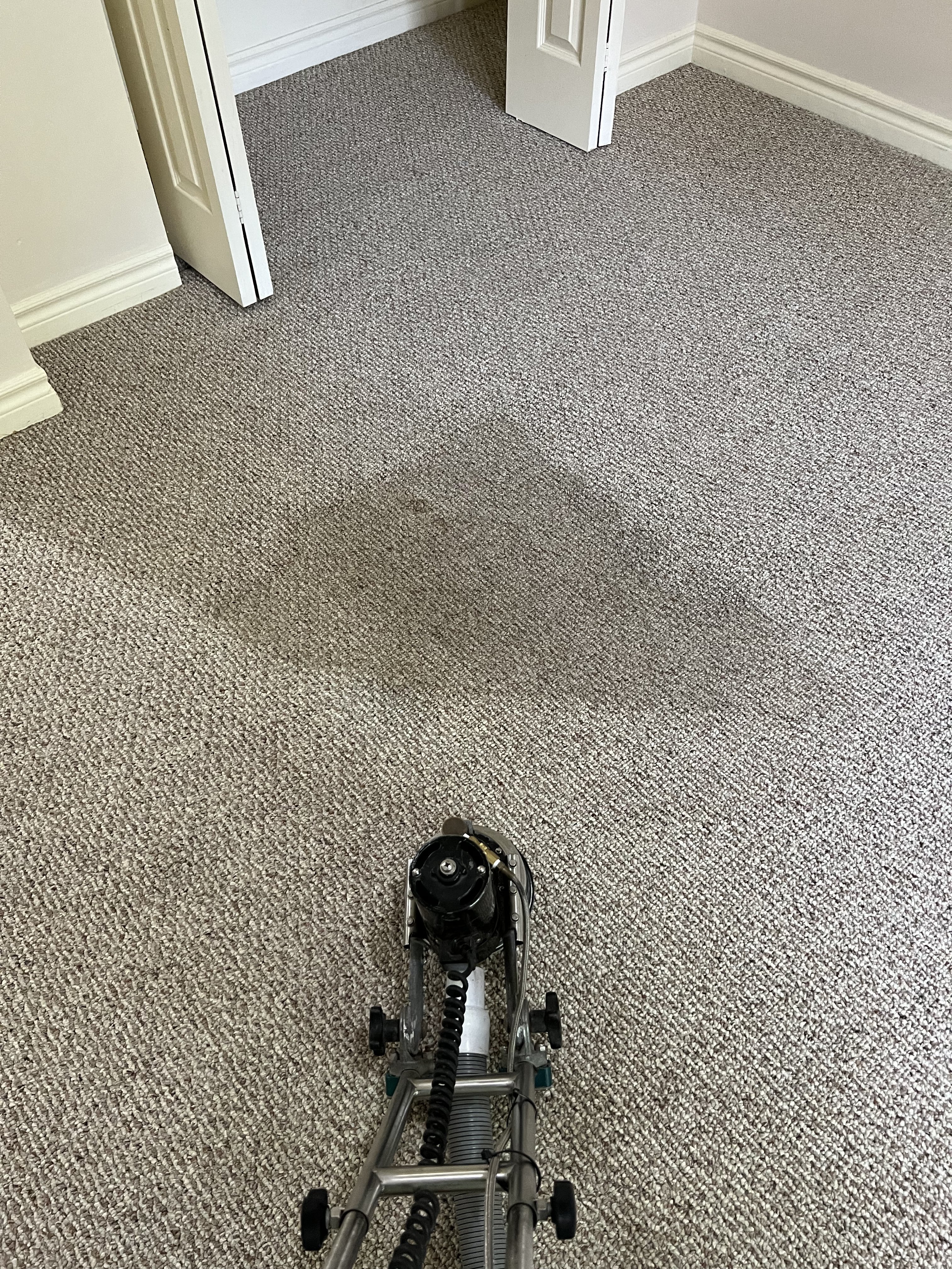

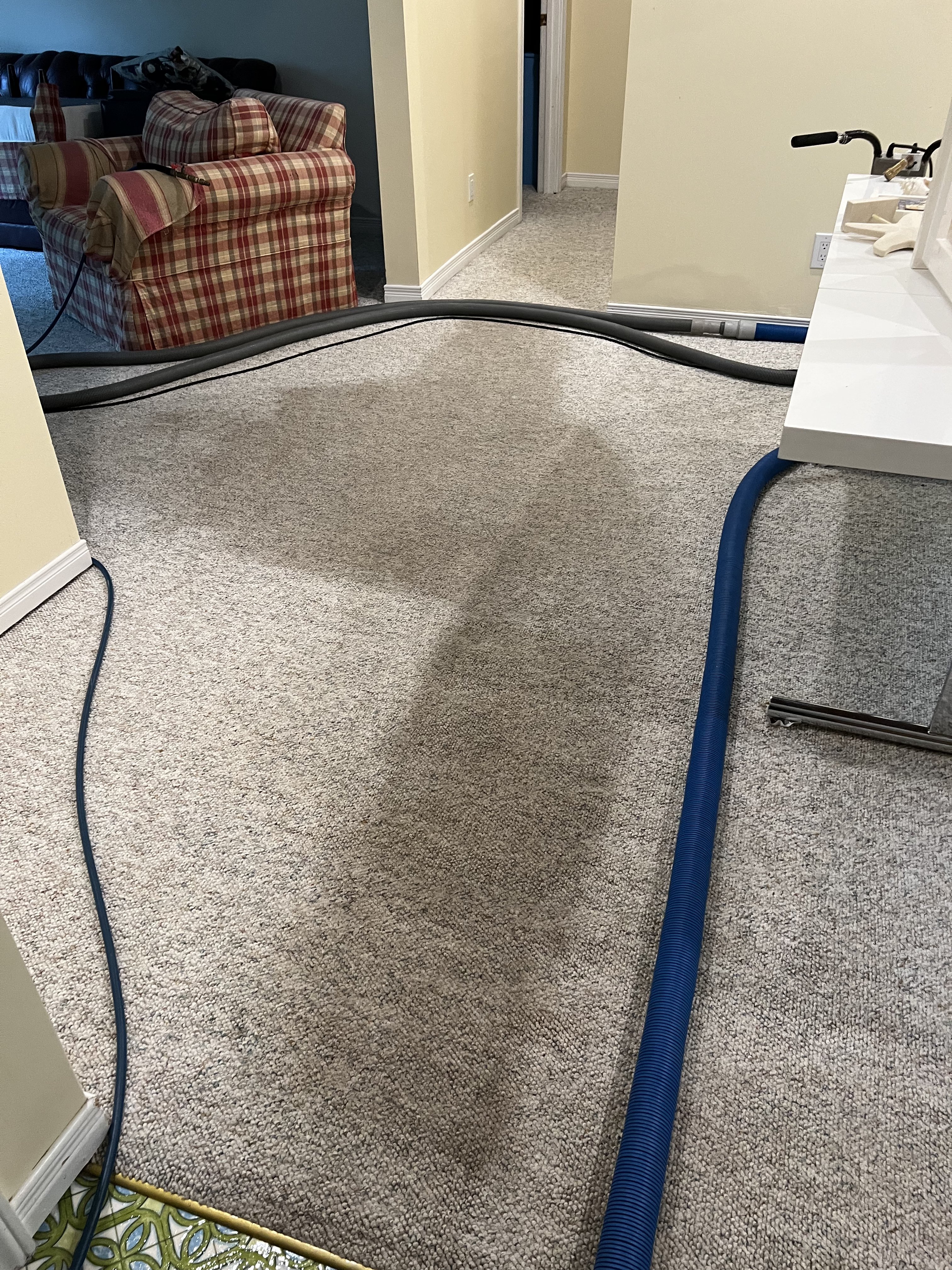

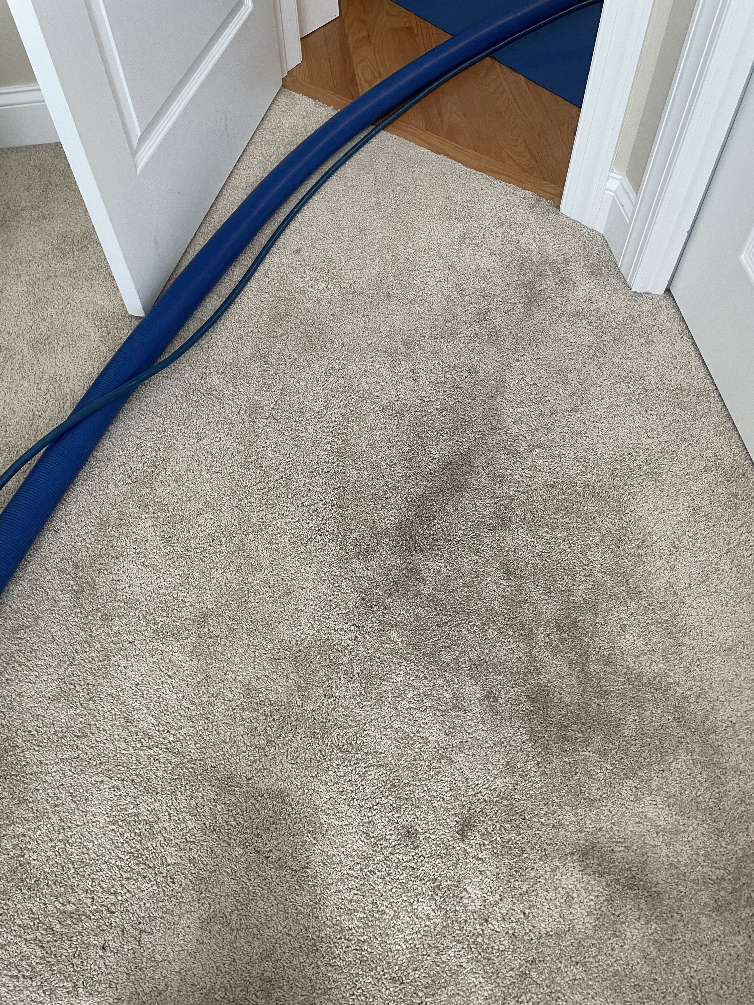

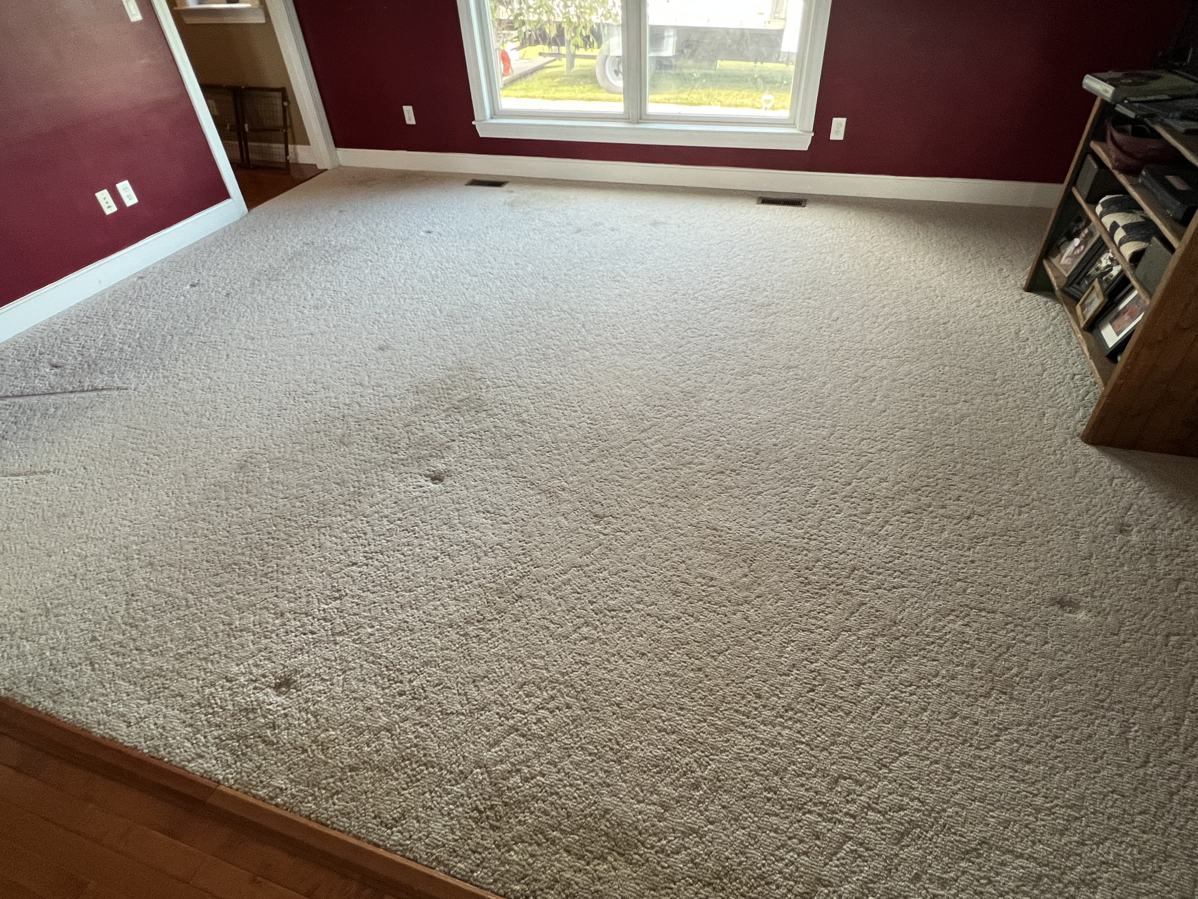

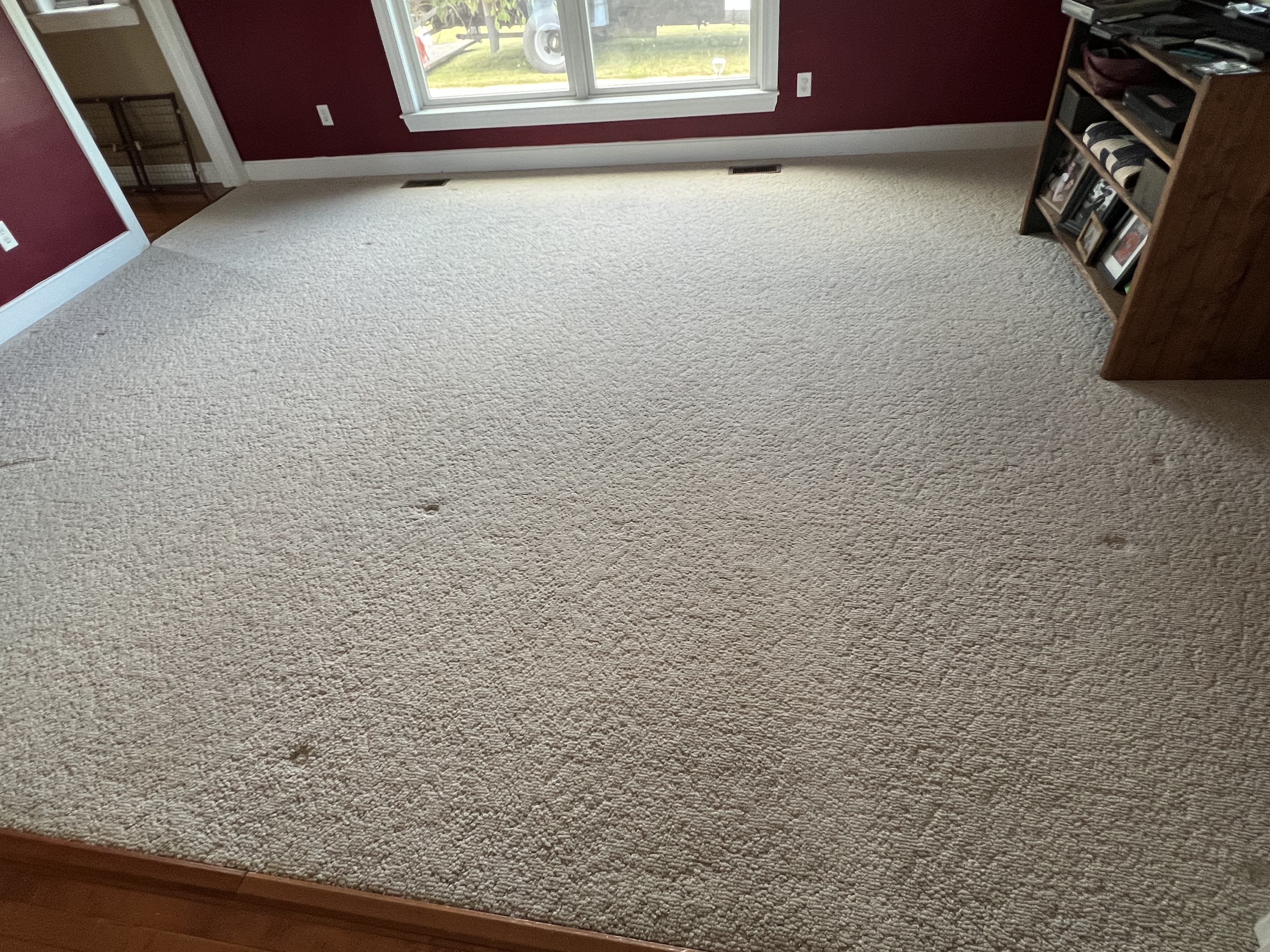

Went over this more times than I can count wet, and even more dry passes. Very stubborn, maybe somebody fumbled a big bong? Air mover key, even for 10 minutes.
No wicking, tip in payment.
