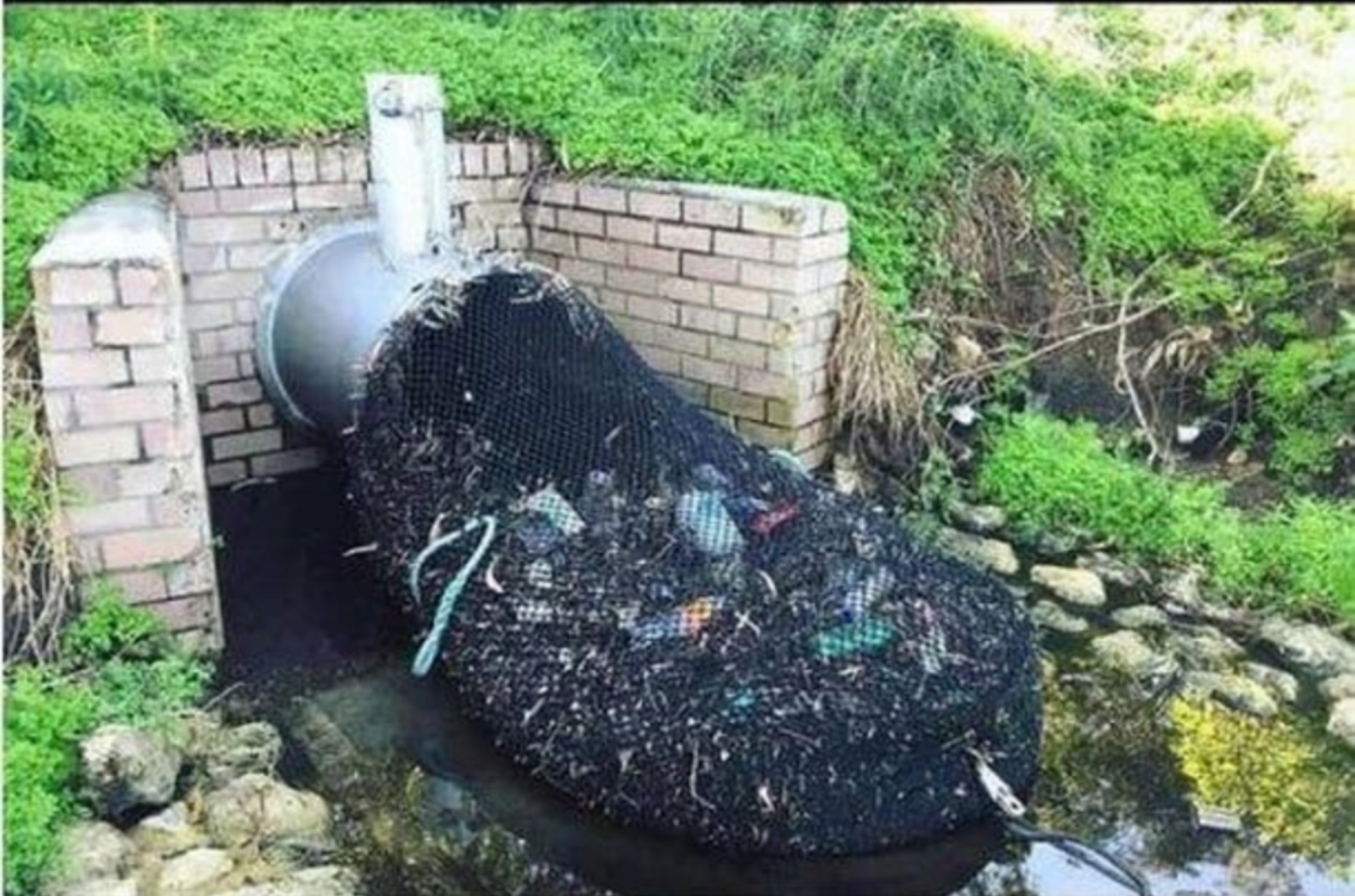

I padded a home for abused kids yesterday.
Check out what came out of the lint trap...
