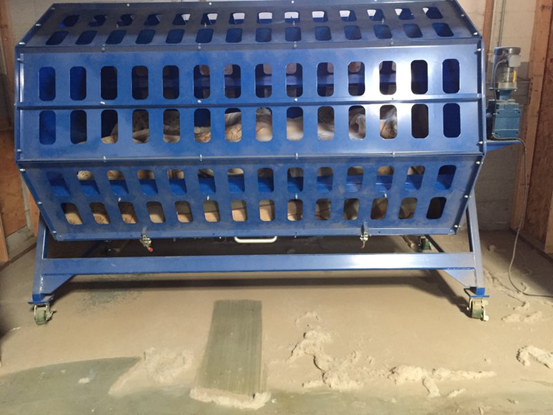

Does it get as much dust out as a regular duster?
It actually gets out more.... As the rug fibers flex and bend, it opens up to shake/tumble dust the dirt/grit at the base of the rug.... That's one of the most time consuming things when cleaning rugs.... It makes it the pile soft to the touch.... Pre-dust and post-dust is awesome when you have a tumble duster.....
We've had the cement style mixer one that D.A. Burns has.... My pops trashed it when we moved to our new shop.... We didn't have the space or electrical to run it....

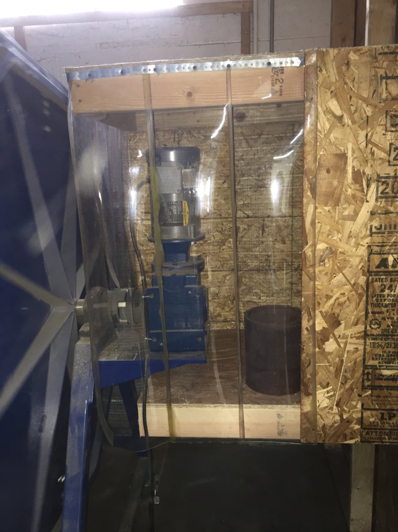

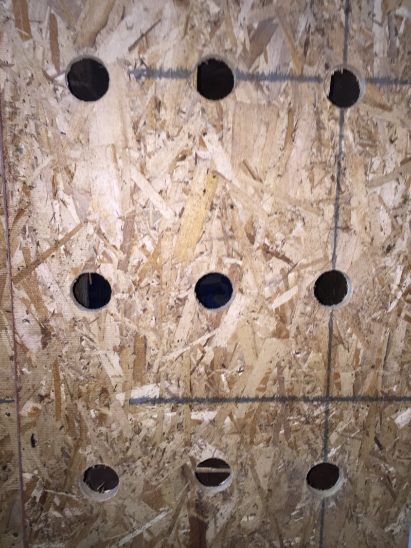

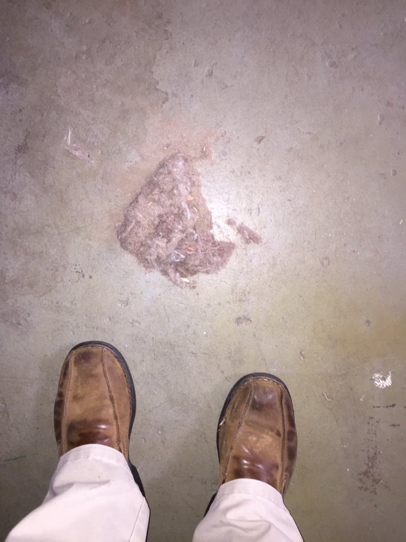

It sure gets more out than I thought. Give me some time with it. We've built a box around the motor with plastic strips allowing us to wheel it out. The holes are on the side of the box for venting.
