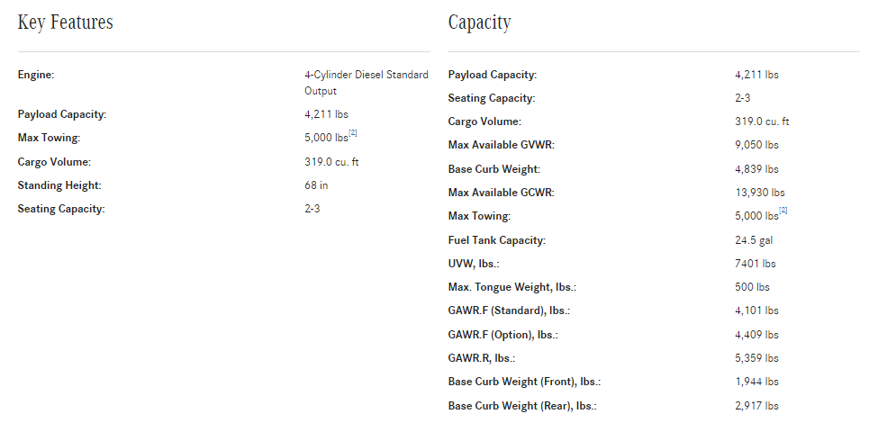

Here's the math I'm doing:
Water weight: 90 gallons = 750 lbs
Apex 570 TM (Standard Install Package weight) = 1420 lbs
Hoses, Reels, Wands, Accessories = Approximately 800 lbs
Driver = 200 lbs
Total = 3170 lbs
Sprinter Payload Capacity (below) = 4211 lbs
According to my math, I'd still be about 1100 lbs under, but the key question is, does the math look right? Or am I missing some key items?

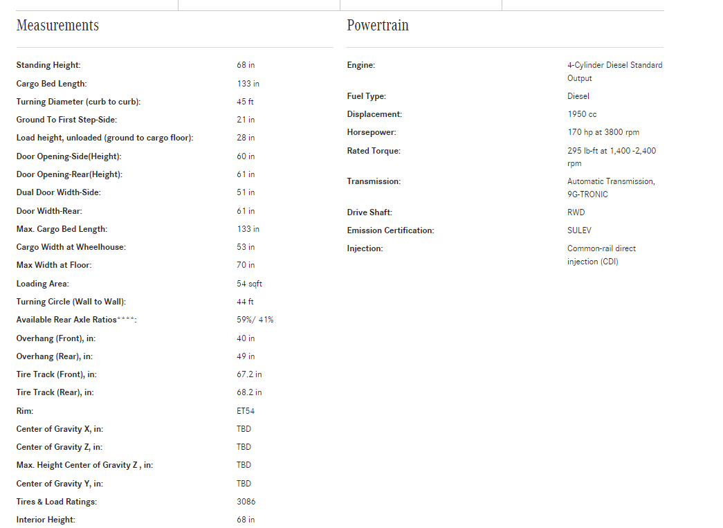

Another factor to consider is the diesel engine of the sprinter. This 4 cylinder vehicle, but because it's diesel, has a decent amount of torque (specs included below).
Overall, will this setup work? 3/4 ton, standard length Sprinter van, with the Apex 570? I just don't want to be in a position where I have to upgrade the entire vehicle because my math was off, or I overlooked something.

I think the happy medium is possibly having a smaller tank and not going with 120 gallons, which is quite a bit. Perhaps a 90 gallon which is what the 570 already comes with standard. If I do that, I could possibly go with a Mercedes sprinter 2500, correct? It’s a 3/4 ton 4 cylinder diesel NOT a 1-ton.
Driver = 200 lbs
Total = 3170 lbs

Thank you for your response. A couple of points:
i.) For the fuel tap, it wouldn't apply as I would be running diesel for the vehicle but unleaded for the Apex 570. That probably means I need to figure out a safe source of unleaded fuel for the Apex 570, if I go with the Sprinter.
ii.) I checked out the specs on the transit 250 and it seems to be 3/4 ton. The GMC 3500 has a payload capacity of 4,280 lbs. (regular); 4,090 lbs. (extended)†. With the setup I described earlier..... will the 3500 extended work if I get the v6 engine... or will I have to go with the v8?
iii.) How much water are you carrying?

19 transit 250. 3.7 liter
Keef has a 2017 transit 3.7 non turbo, and carries 165gallon water tank to supply his Prochem Apex.. It handles fine, funny to see when stopping though, it looks like a couple of midgets wrestling in the back.. He also fills up at home because of water quality..
