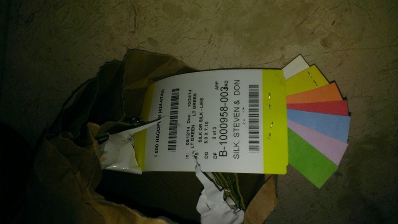

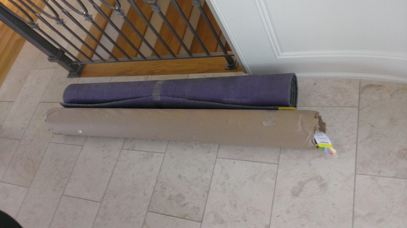

I think this interesting, I saw this rug in a clients home when inspecting some other work. Our competitor cleaned this rug and I know that they get 1.00 a foot to clean and 1.00 for every additional topical treatment they sell and apply to it. The little tags stapled to it are each worth $1.00 additional per square foot. This rug apparently was cleaned for about $7.00 per square foot. They have a system where a salesperson calls every client and tries to sell them additional services and as you can see they have a very good salesperson.
We can all charge more than what we are charging and the customers are ok with it as long as you perform a great service. I see a lot of these flag tags on my competitors rugs all the time , this is not an isolated incident.
This photo shows the rug with the tag attached.
This photo shows close up of how many additional tags it has on it.

Now now Chet, all you had to do is call and I could have explained it all for you. Your post almost makes you sound jealous. :lol:
Yep, there are a lot of flags on that tag. It's a 5' x 7'10" silk (kind of funny since the customer's last name is Silk) Turkish Herekey with an appraised value of $8500. It was noted as being heavily damaged with urine when it was brought in.
The cleaning price on that rug was $156.00 less 25% for them bringing it in or $117.00.
Flags:
  1. Protosil- soil and stain protection $24.99
  2. Deodorizer $12.99
  3. Microban disinfectant $19.99
  4. Specialty stain removal for urine stains $95.00
  5. Appraisal $75.00
  6. Pad $66.00
  7. Special Handling (silk rug) Included in price
For the cleaning, odor treatment, specialty stain removal and stain protection of that 39.5 square foot silk rug = $269.97
Of course the padding and appraisal are elected and have nothing to do with the cleaning.
All those services were discussed and agreed upon at the time the customer dropped them of in our Birmingham showroom. The only system we have to call and offer additional services is done by our pick-up and delivery crew when the customer is not home at time of pick-up.
Chet, what do you charge to do the same type of work?
Also if you have any ideas on how we could improve our services, I am open to suggestions. :biggrin:

I think that is a really decent price, especially with the reputation you have. I was in one of my customer's home and they had a 6x8 silk rug cleaned by one of our local rug cleaners and they charged $800.00 without having to remove urine or any serious stains. They badly distorted the fiber as well. The rug was valued at aprox $8000.00. These people have a rug duster/washer/centrifuge/etc. but obviously don't know how to use the equipment. The only thing I would question about your pricing is you charged separately for deodorizer, microban, stain removal. Wouldn't it be better to roll that into one category and charge one lump sum?
