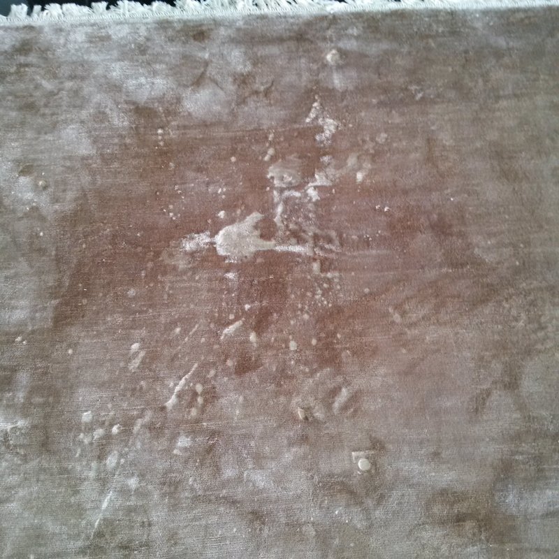

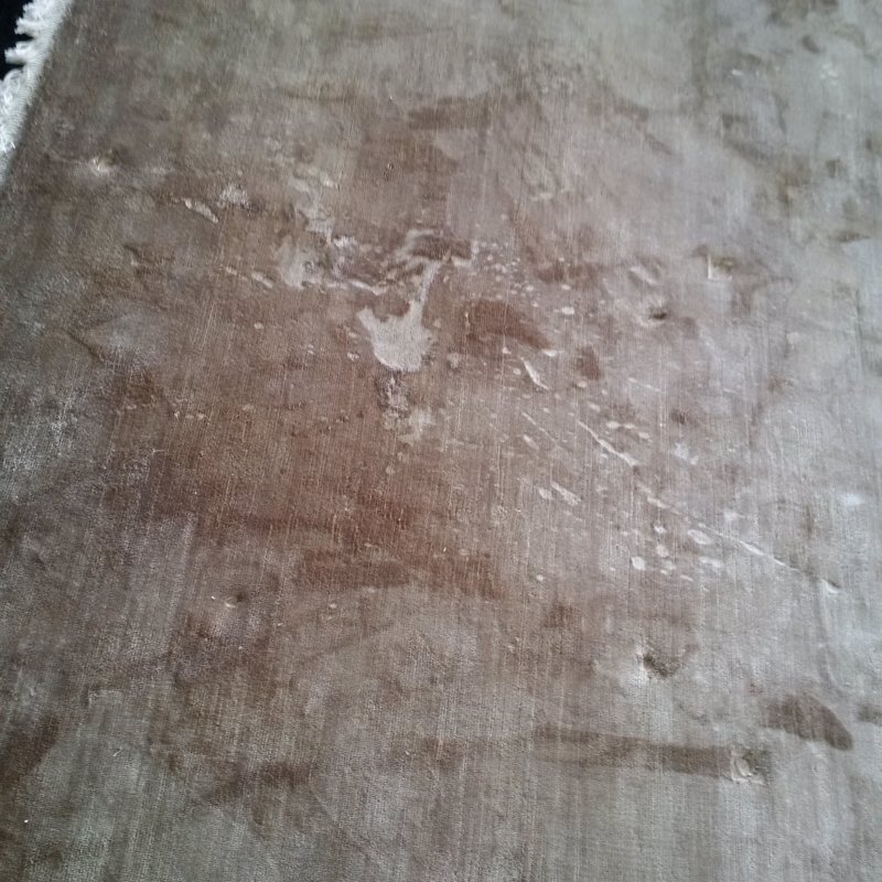

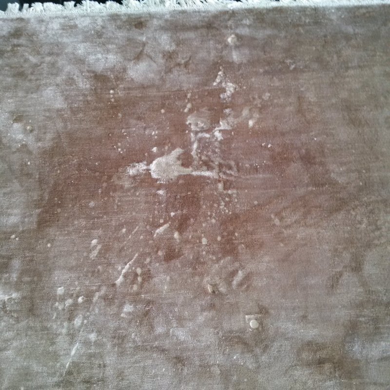

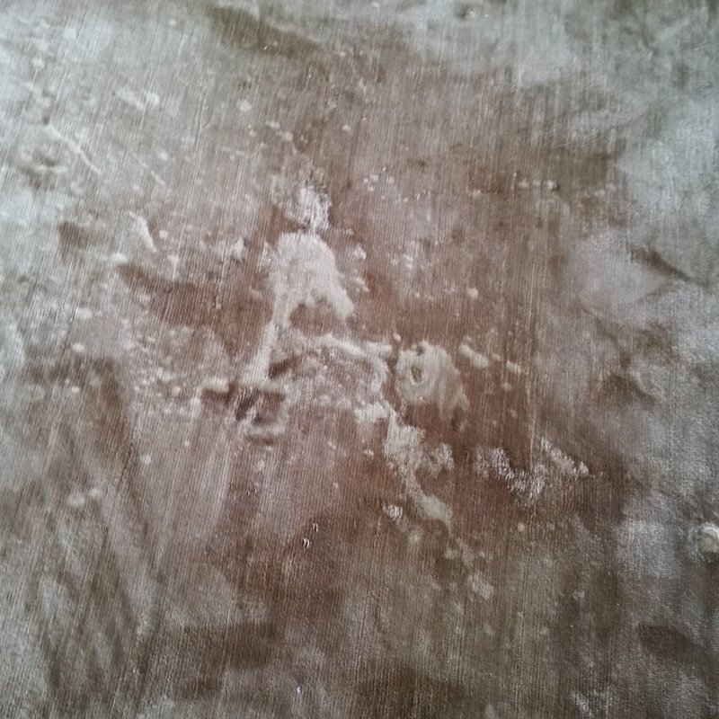

I was that customers today and here is what her silk? Probably viscose rug looked like. One rug has been price tag of 79,000.00. I'm sure the other one is about the same

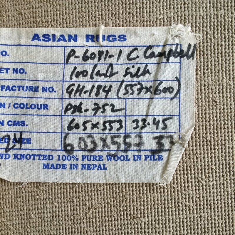

The label says 100% wool?
If the customer isn't lying about what they spilled, a little steam and picking the nap up with a fine bristle carding brush should do the trick.

27,863
When you look closely at the label, second line, what does it say. Seems to me like 100% art silk or something like that. We brushed it out with a carding brush and a little steam and it seems like it's gone and theres the rub, is the customer lying and to what point. Maybe they just don't know. Perrier water is just carbonated water, you wouldn't think it would leave a mark like that. It had crusted a little on top. White crusting.
