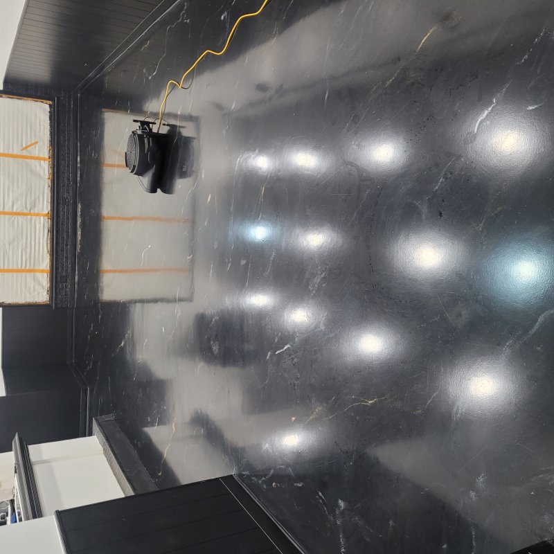

I refused to take on a job to remove the flaking sealer from said materials until yesterday when my customer of 10 years asked me to help him with his floor in the Bar/ grill he's bound to open tomorrow. He applied a water-based sealer (Zep) to the epoxy floor in the hope of bringing up the luster and covering up minor imperfections.

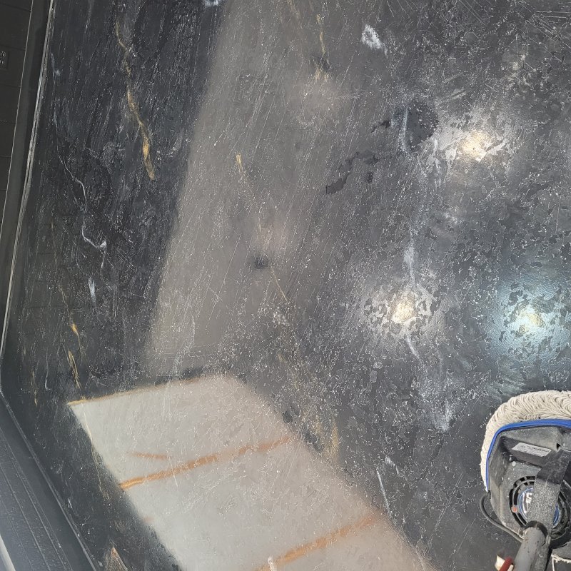

One thing about it, it might’ve shined it up a bit but it won’t for long. It (Zep) probably won’t last a week in
If you zoom in , you'll see flaking off already in the progress. I wanted to spark curiosity and responses, so I didn't mention that I took care of the problem for old time's sake. To make matters worse, they applied sealer with a mop head ( I'm not even sure it was a clean one) , and didn't let it cure before the subsequent coats.
Hopefully, they learned a lesson.

Too many things went wrong. I was hoping for one coat only , but I was wrong. Scorching hot water mixed with ZEP stripper, and a lot of TLC did it. I suspect that the epoxy floor wasn't done right to begin with,
10,256
That’s a big possibility about the epoxy. But, you can treat it like vct. You can’t hurt it. The Zep is just a cheap (not so cheap now) product that is not durable at all. It won’t hurt anything, you’ll either have to add more sooner, or strip it off and start over.
