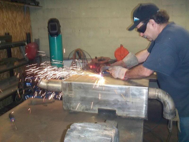

If you own a Butler truckmount system, there is a modification that we suggest for the blower silencer. We have had quite a few Butler systems come in for excess blower heat and low airflow issues. The heat issue was so severe that the heat would transfer into the pulley of the blower. This would cause premature belt failure. During our analysis of this problem we discovered a blower air restriction in the silencing system. In the pictures you will see that we cut the silencer open and discovered that all the air coming from the blower is being forced through a 4 inch long by 3 inch perforated pipe. This pipe has 1/4 inch holes. The end of the pipe is capped, so all of the air is forced through these ¼ inch holes. On this muffler, the holes began to stop up with corrosion, causing excess backpressure on the blower. This excess backpressure will cause the blower temperature to increase considerably. The backpressure also diminishes the airflow.
We corrected this problem by cutting the pipe open to allow free flow air. We were concerned that if we did this it might make the unit too loud, but since we reinstalled the silencing system, we have not noticed any increase in sound level. It is our opinion that even if the holes were not stopped up with corrosion that a 4 inch pipe with ¼ inch holes is too restrictive.
If you own a Butler and would like to check to see if you have an issue like this, go to the auto parts store and get a pocket thermometer. Drill a very tiny hole in the pipe leaving your blower. Insert the thermometer in the hole, start the unit, allow it to run for about 10 minutes to come up to operating temperature. Your blower exhaust temperature should not be over 275 degrees. If you are experiencing excess temperature, you now have a remedy for that problem.

Explain to me how extending the life of the Butler's blower's, preventing the clutch's from burning out and increasing the airflow is benefiting me?
If I was such a bad guy, I would just let this go on and not tell anyone who own's a Butler about it. So the units would then have problems and maybe they would buy a Judson. This is what you would call self interest.
We have repaired 3 Butler's with this same problem. All the units had their filters in the recovery tank.
The inside of these silencer's are not Stainless Steel. From what I can tell the Carbon Steel is rusting from hot moist air.
As you can see in the pictures the holes are completely stopped up.
The silencer's that we repaired were between five and six years old. As far as did these Butler's have proper maintenance done to them, I was told that they did, but you never know.

The problem is the use of a steel that is not stainless.
We have also seen many blower silencers on slide-in TM's,
clogged by corrosion of the internal steel parts.
It causes the blower to overheat.
All blower silencers should be made of stainless steel ...
if you expect them to last more than a year and a half or so ...
with wet detergent run thru them every day.
Stainless steel forever.
