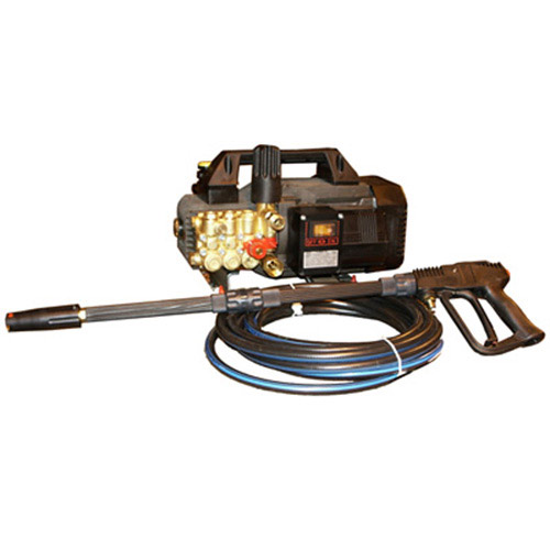

I am not endorsing any particular system or manufacturer...but by way of example...what would be the drawbacks of multiservice TM setup like this? It Would seem to handle Carpet, Tile, and Floodwork.
Vac: $6000 http://acceleratedtruckmounts.com/FloodMaster.htm
Heat: $1400 http://www.***************/store/little-giant-120000-propane-heater-pressure-p-4942.html
Pressure: $850 http://www.pressurewashersdirect.com/Cam-Spray-1500ADE/p1062.html
Looks good to me...but I am a newbie...what the frack do I know?
Vac, Heat, Pressure...it seems simple and to the point.

Need gas, propane, and still need electric for the PW. Also lack of calibrated chem metering. All of which could be overcome, of course.

Yes...since I work empty rentals...I tend to forget residential customers might be PITA.... do you think that they would be resistive to even a single plug in?
Do you think a guy could get a "feel" for the pumps syphon chemical feed? Or would you have to take other measures?

No, I was just thinking of moveouts, etc. where the power had been turned off. You could certainly bucket calibrate your chem feed, but then changing chems or dilution would be a huge pain. Are you going to add fresh and waste tanks, or do autofill/APO? Hose reels, etc? On the one hand, you start to approach the cost of a regular TM, on the other hand you start to sound more and more like a porty, what with the electric and all.

With the "warm water" pressure washer mentioned...you could if available... connect to on site "hot" water...less than 180 degrees...turn down the pressure to less than 600psi...and then run to #3...for "scorching" performance at the wand... when needed....like in a greasy restaurant.

If you want simple and reliable, and your planning on having to pulg in a cord anyways... why not just buy a nordic unit?

I think the "one plug in" complaint is kind of disingenuous..I mean really...you never plug in a 175, or rotovac?
