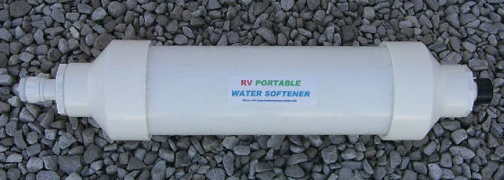

This is the softener I use Its mounted up front and has to be manually charged weekly.
