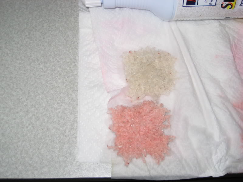

So I did some testing on protector. You have to see this.

I rushed the curing time on the Maxim. Air mover all night. Test same red dye that comes in the kit and I have to say that my pieces of carpet was better then the one the put in the kit. This was after 4 dunkings.
Maxum on the bottom. Pros on the top.
I was going to film it but the kids are home from school today and you think I could get 15 min of quiet around here? :)

Some people, Greenie, say that people are getting defensive about this but I don't want people getting the wrong idea on a very good protector. I might not make it but I do sell it and back it's quality. These are test results I've had with Maxim Advanced.
and that is after about 12 rinses.
As I said it's good to see you testing these things but I didn't believe the results as mine were completely different.

Jeff I do sell Stain Guardian also but believe in Maxim Advanced much more because of the results I've seen using the product and the reviews from my customers. I'm not rying to tell him his experiences aren't real I'm just saying my results are totally opposite and I don't want people to only see his test results because that gives the product a bad image when it is a very good product, that's all.
