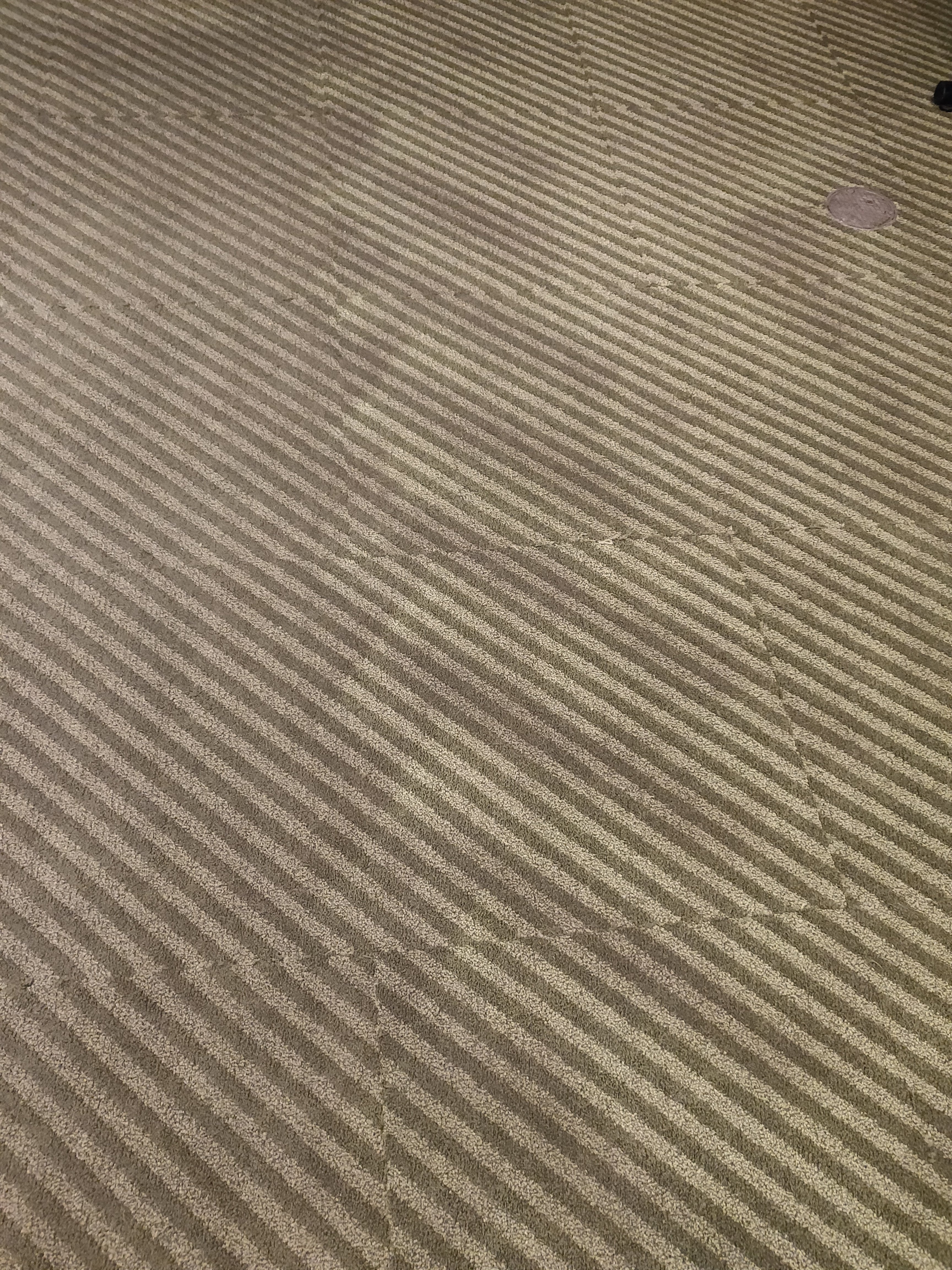

I received a new SS 14" and tried it out Saturday morning.
Compared to my Prochem quad it's like pushing a stick.
I'll have to try and figure out why it left these marks.
Any idea?

Seriously though, If those are 12-in carpet tiles or larger, I'm not exactly sure what's going on there, but let's see the back of your wand. And are you using a glide on it?

It's came with a slot glide.
I was using the hybrid for year's I think I like that better, I'll know more after a couple days.

Your problem isnt Glide related but our internal fit version for that wand is a huge improvement.
Way easier to push and pull and no air leaks from the rockering off and on of the external fit

wanding technique and jet spray pattern. make sure you have an even spray pattern and let off the trigger at the end of the stroke.
14,637
The sudden change in color looks like color loss.
Were you able to get that to blend in?
