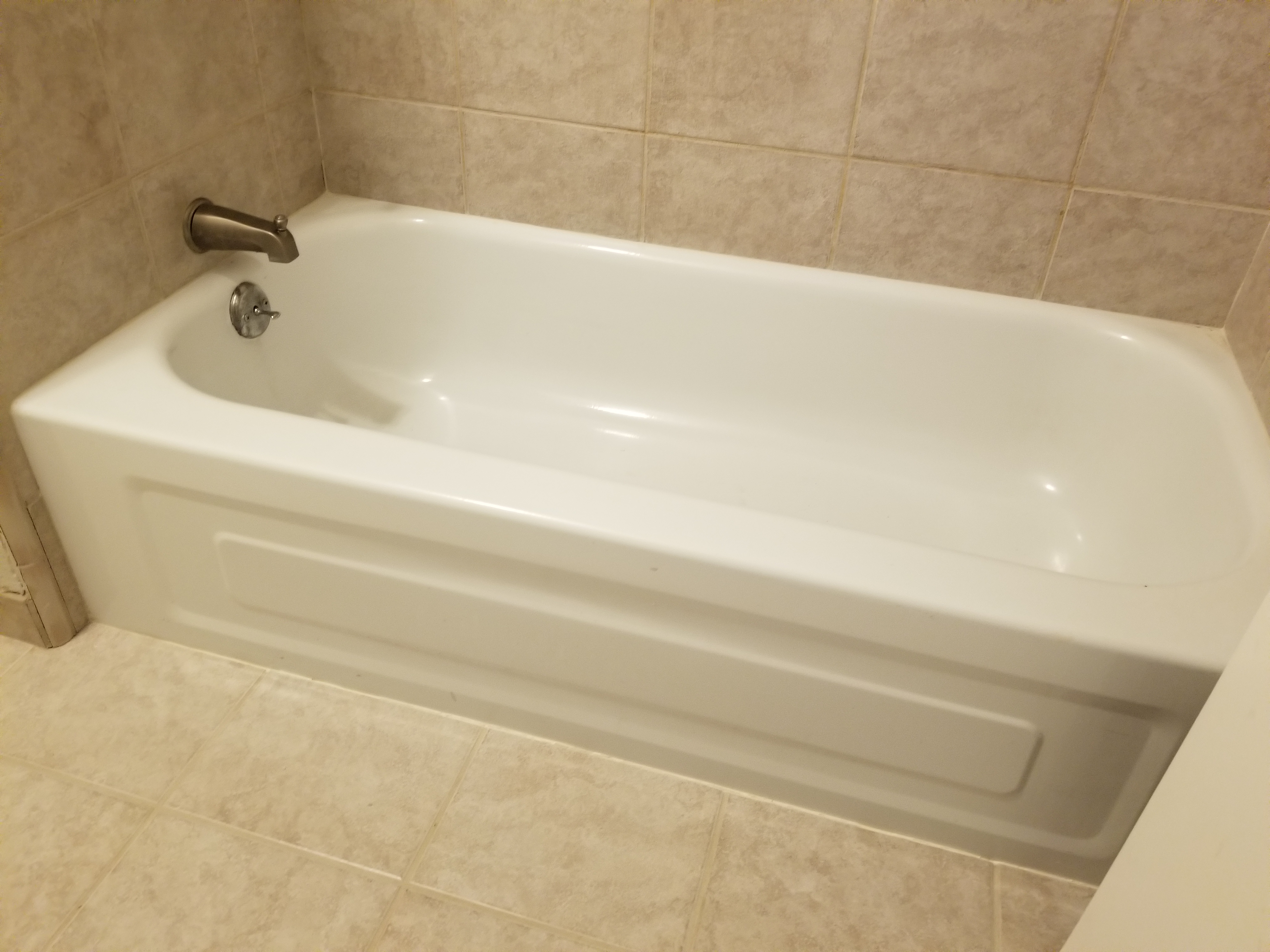

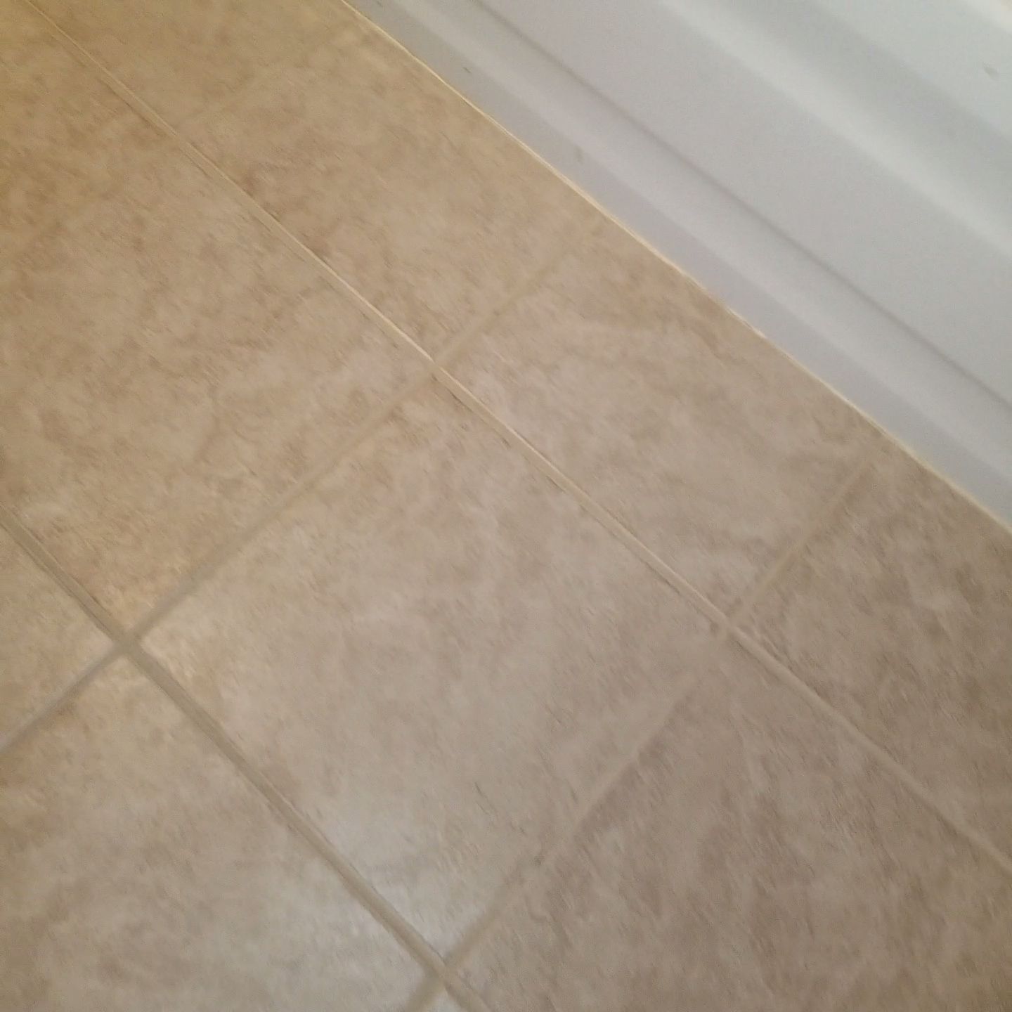

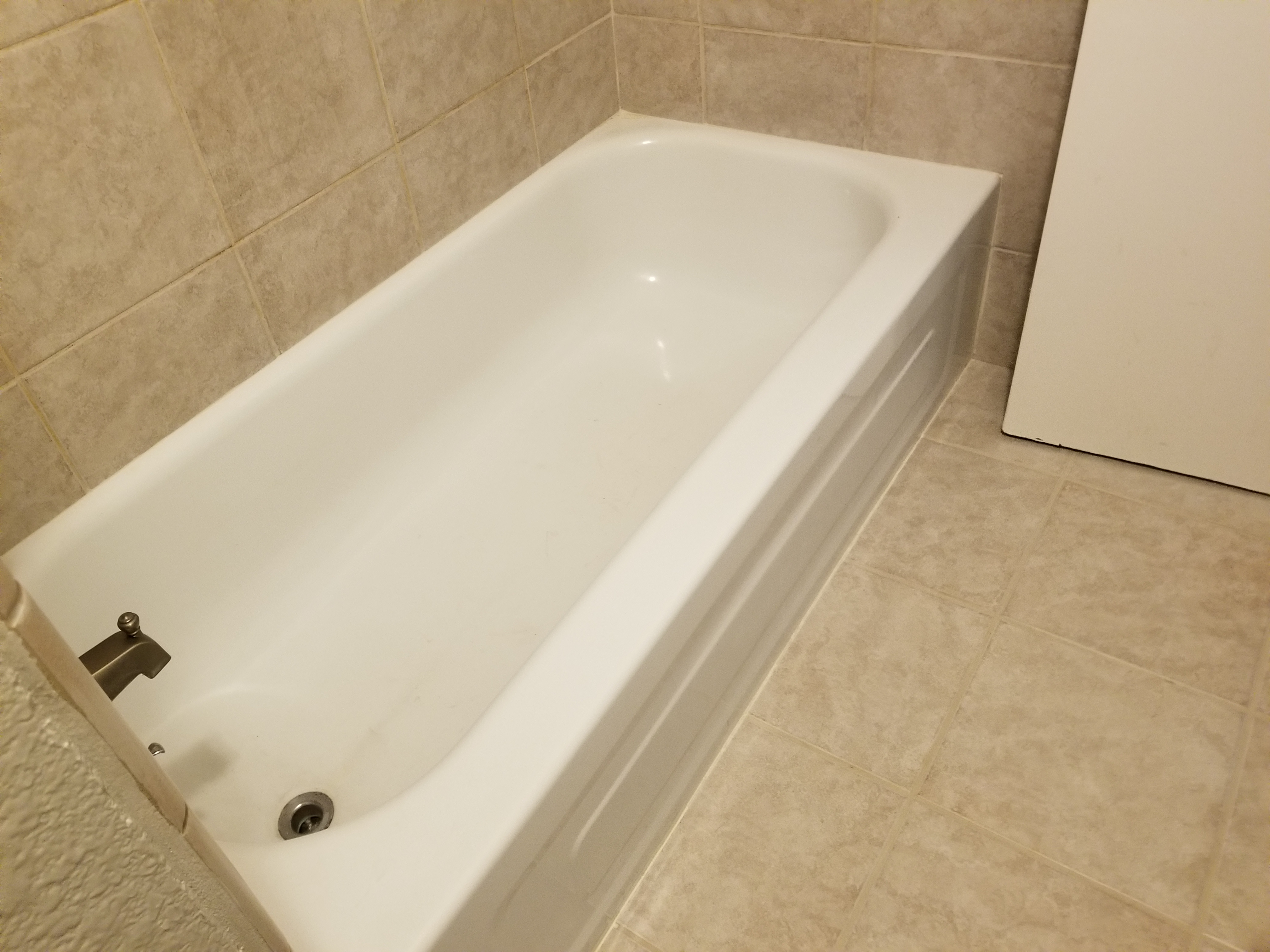

Those are the after shots?
I would have picked a different color...
Yeah, Brandi realized that. She was trying to match grout color. I kept saying that it needs to be darker. Standing from doorway, it doesn't look that bad of color..

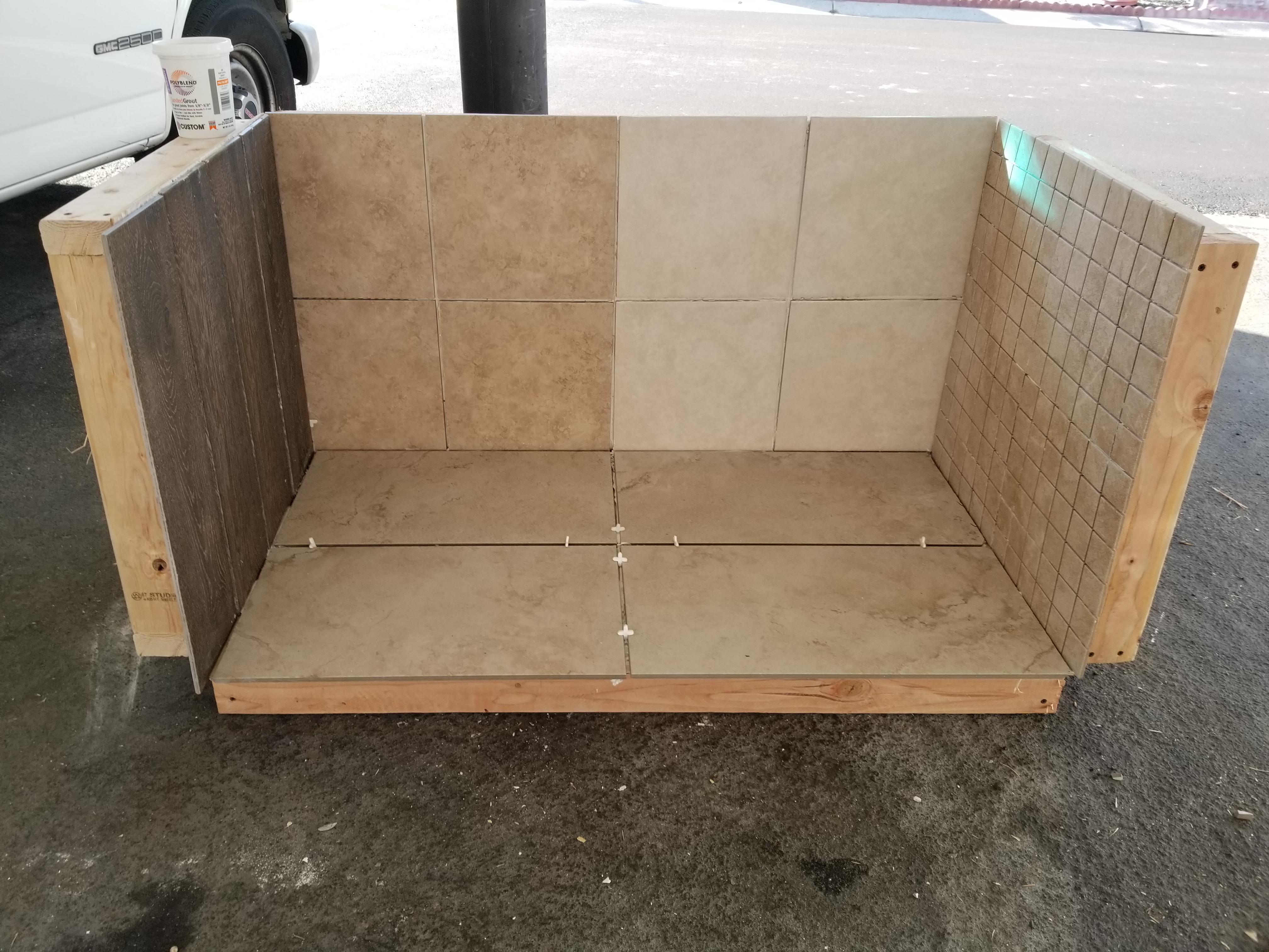

Built this for Brandi so she practice as often she want. Grout repair, tile repair. Cleaning. Wax/Laquer removal and etc. Probably get some color seal so she can practice.
I made this demo to have movement in joints so the grout will deteriorate often. Also, use SGA and try to learn how to remove it, if possible.
