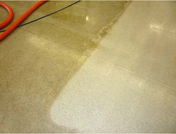

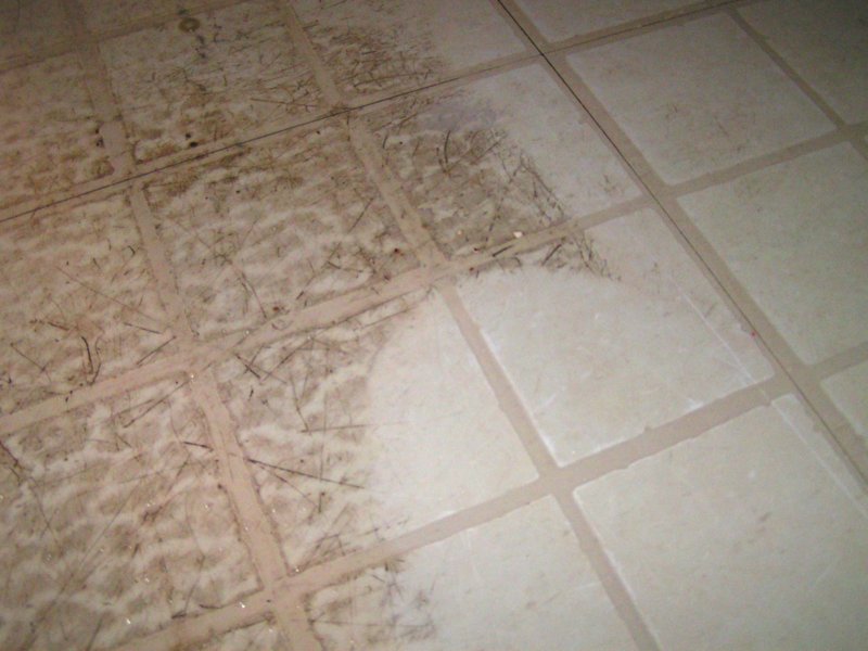

It's good to keep an open mind so you can discover new products, methods or techniques for solving old problems. VCT never got me excited but I get then occasionally and charge from .65 to 1.20 per square foot depending on the complexity. Dental office on Tarkett sheet goods where I have 45 minutes prep time just getting ready to strip. (dental equipment, Charis etc) Since designing the Turbo-Hybrid I appreciate it even more at doing wax stripping as a thorough suck & rinse tool before applying new finish.
View attachment 11715 View attachment 11716
You're using your TM to rinse and extract with? :eekk:
