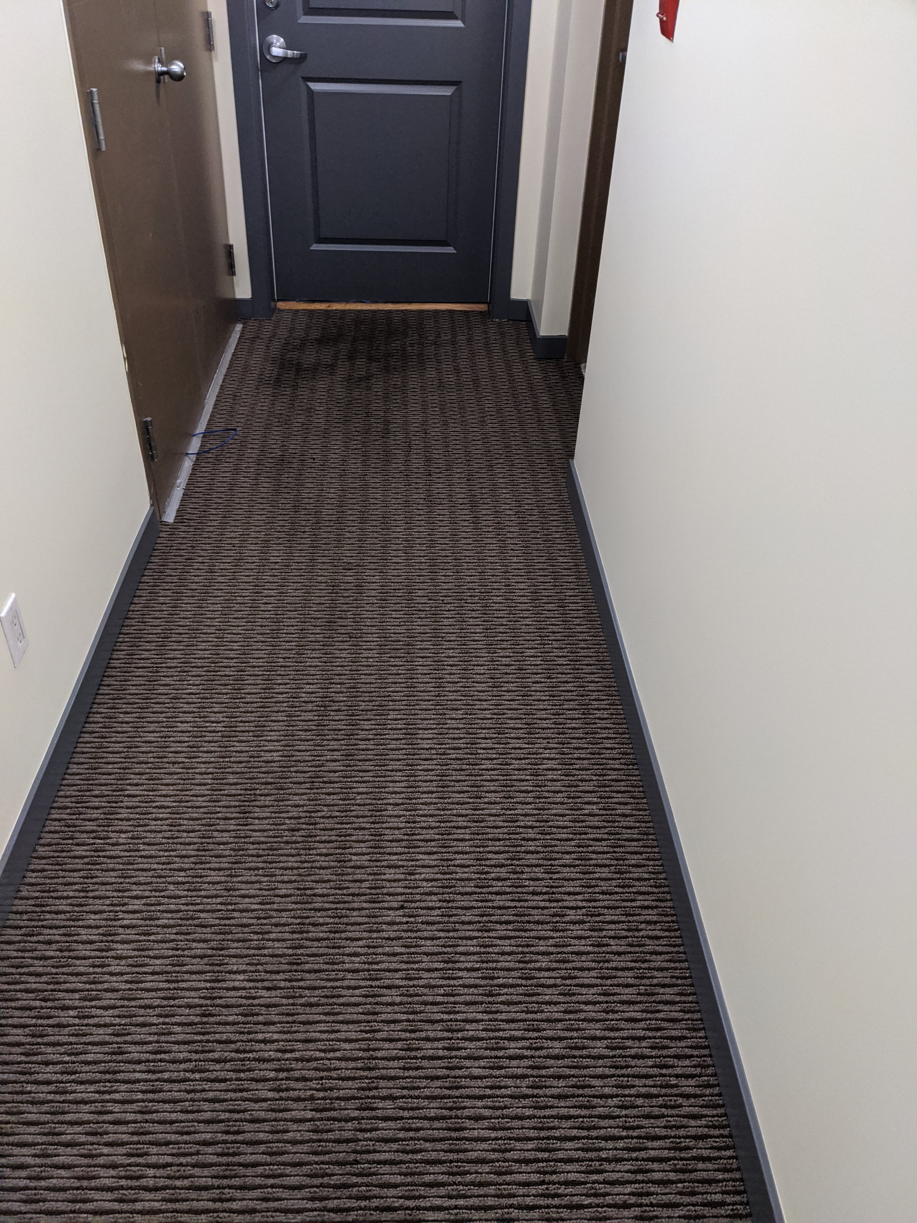

Scrub and walk away. Seems like you're only doing half a job but the carpets come clean and seem to stay that way. That's what I'm doing today in another 30 story building. This is the third time encapping all of their carpets. They have a great janitorial and the vacuuming is top notch. Today I will be using the sprayborg, fibre pads and esteam crystal encap. The hallways are usually lightly to moderately soiled, mostly around the elevators.

I don't think you want to vacuum afterward. Even if it feels dry, the product hasn't had time to crystallize yet. Let the maintenance people do the vacuuming at least a day after. 12 hallways done by 11am. Started at 9. $720 and I am having lunch. I'll do another 12 hallways today and finish off tomorrow. Couple of amenity rooms to clean as well.

Today I'm using Esteam Crystal Encap. I got a case for free. It seems to do a good job. Dilution rate is 4 oz per gallon but at the end of the day it gives me a headache. The hallways are vented, the odor is ok but the fumes seem a little strong. Overall, the customer is happy. The council president was inspecting my work and pronounced it good. Can't ask for anything more. Did 27 hallways today, tomorrow I have 3 more and the amenities rooms.
