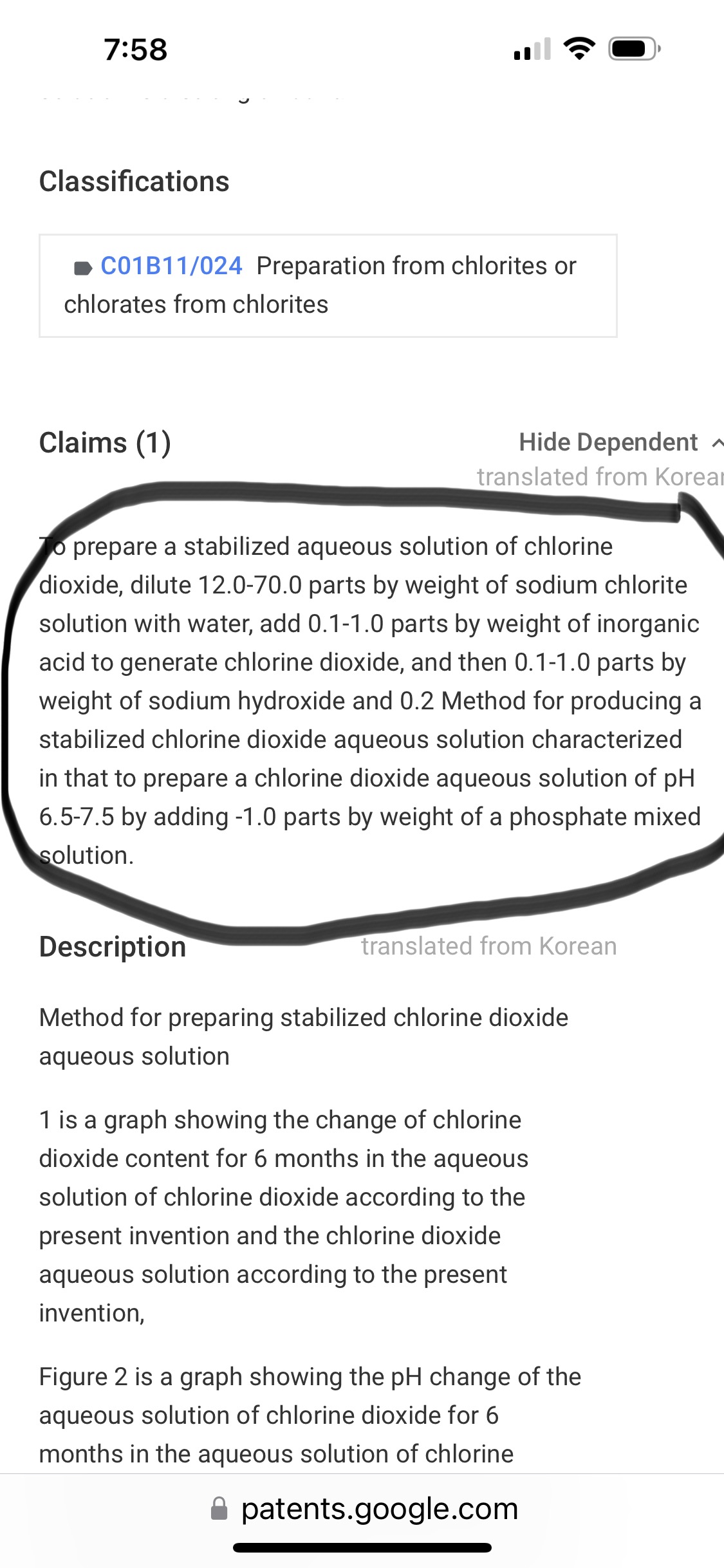

So in my quest to find out the active ingredient in a " Cide" I sat in my recliner and went into a deep trance. I then reached out to the spirit of Shawn Forsyth and asked him about "Cides". He said that it's all just bullshit hiding the simple fact that all it is ...........is.........ALCOHOL.
And you can even fog hvac ducts with it because it's not toxic.
So all you stupit MOFOS that's it!
