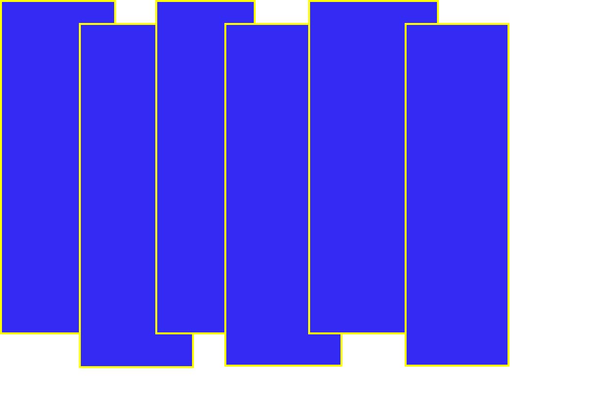

that is one third (or at least representative of)...it leaves the center third without the second flush
1/3 of the width of the wand. Your wand is 12 inches wide. 1st stroke is against the wall. 2nd stroke, move the wand over 4 inches. 3rd stroke, move the wand over another 4 inches. Repeat until you reach the opposite wall. The majority of the carpet will be flushed 3 times.
that is a 2/3 overlap not 1/3...........and dumb
