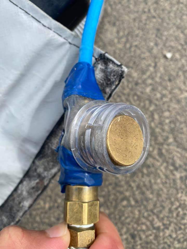

Tired on your Sapphire Uph Tool flow valve turning on you?
117,368
Heres a cool idea I stole from an Australian..
117,368
Explain that as if I’m trying to understand it
SOME of those valves are loose enough that if the technician doesn't have it completely encased in the attached vinyl wrap included with the tool, the valve tends to rub on carpet and re-adjust..
Said vinyl wrap is a bit of a PITA on the SSUP.
RV's answer (a bag) works better

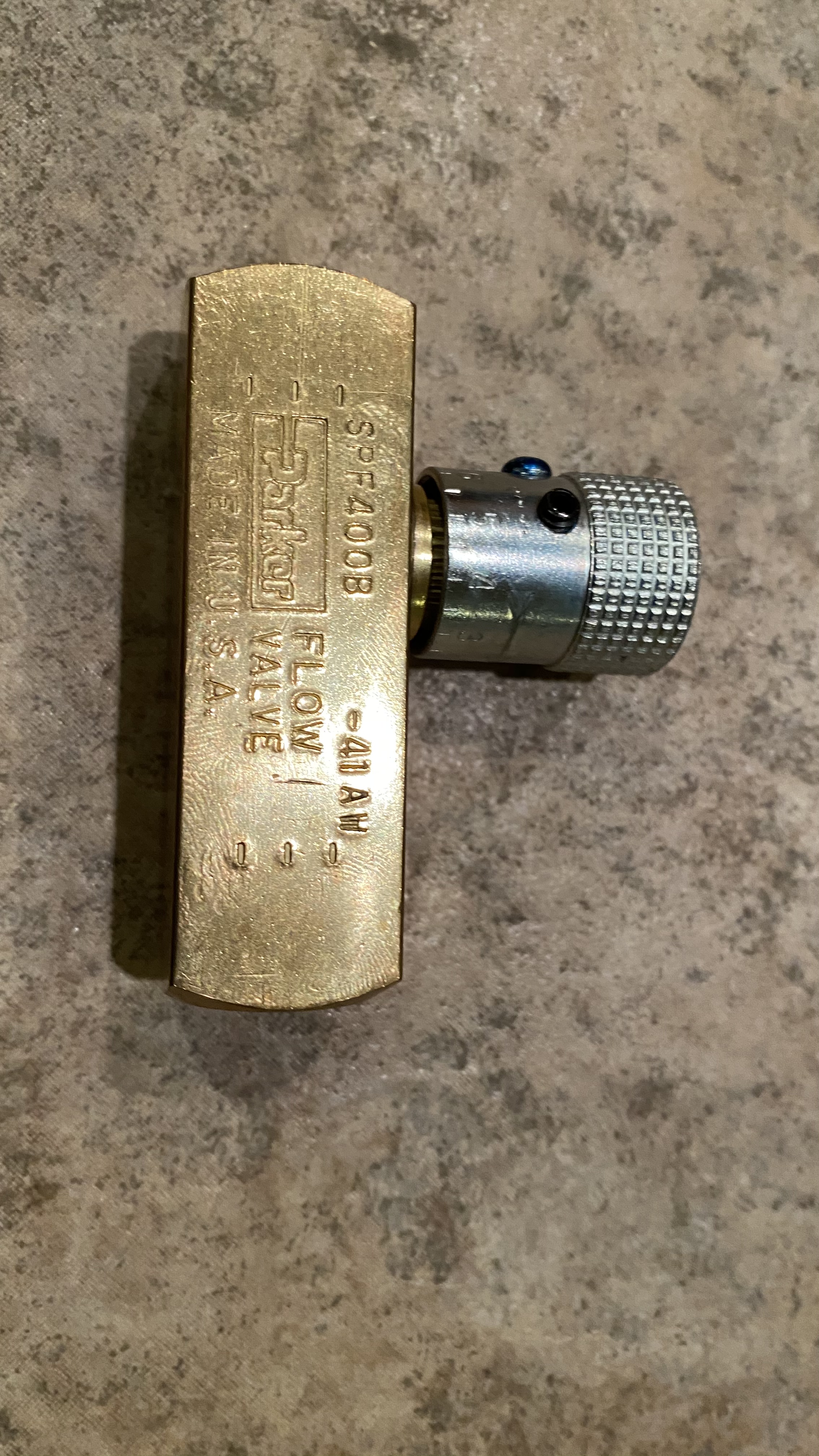

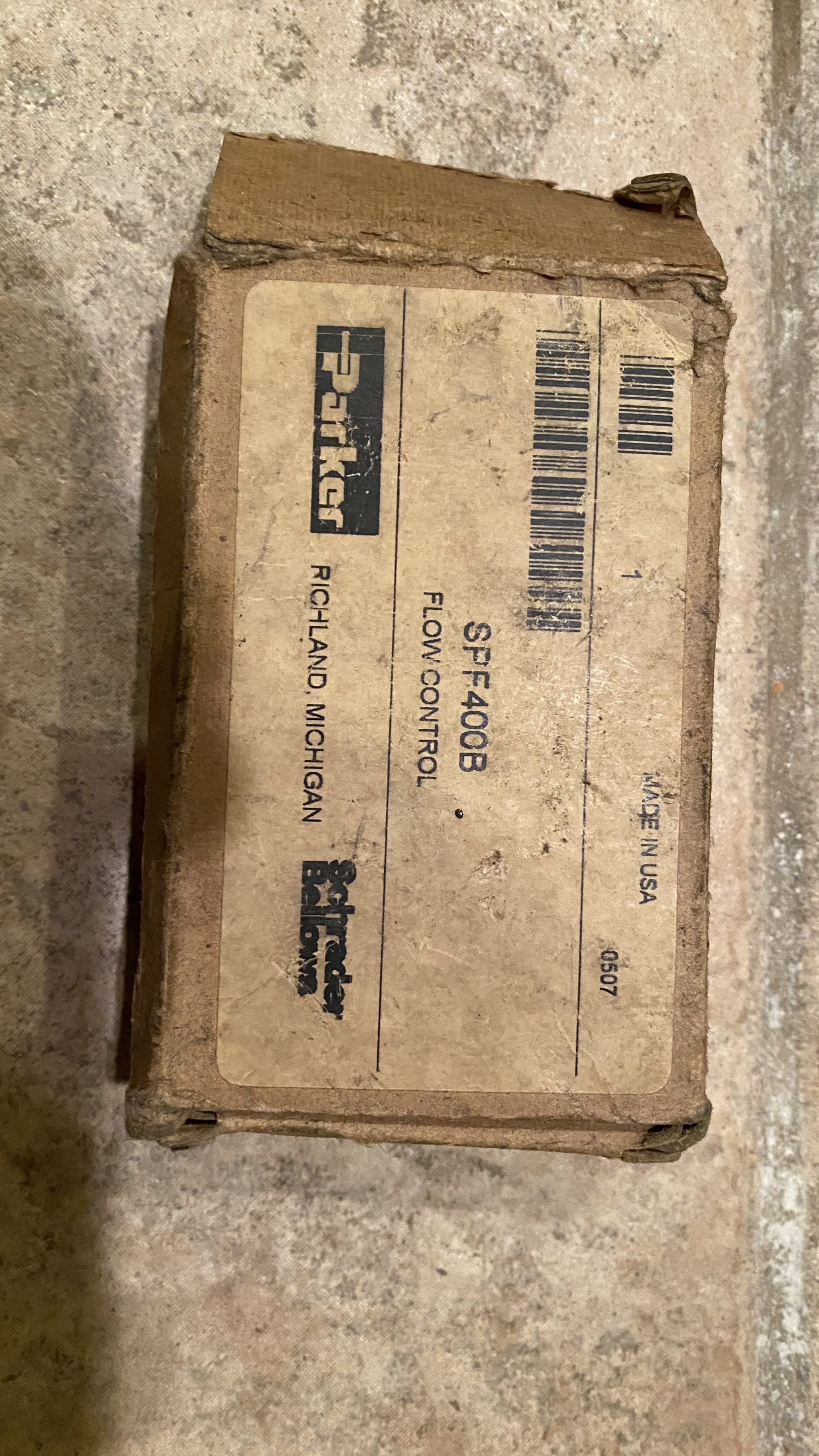

A locking Parker valve was all the rage here for a while, until reality settled in and using that tiny 2mm Allen wrench (and not losing) became tiresome.
I think there is a packing nut on the SS valve that can be tightened up to help keep it from turning so easy, I'll look later
