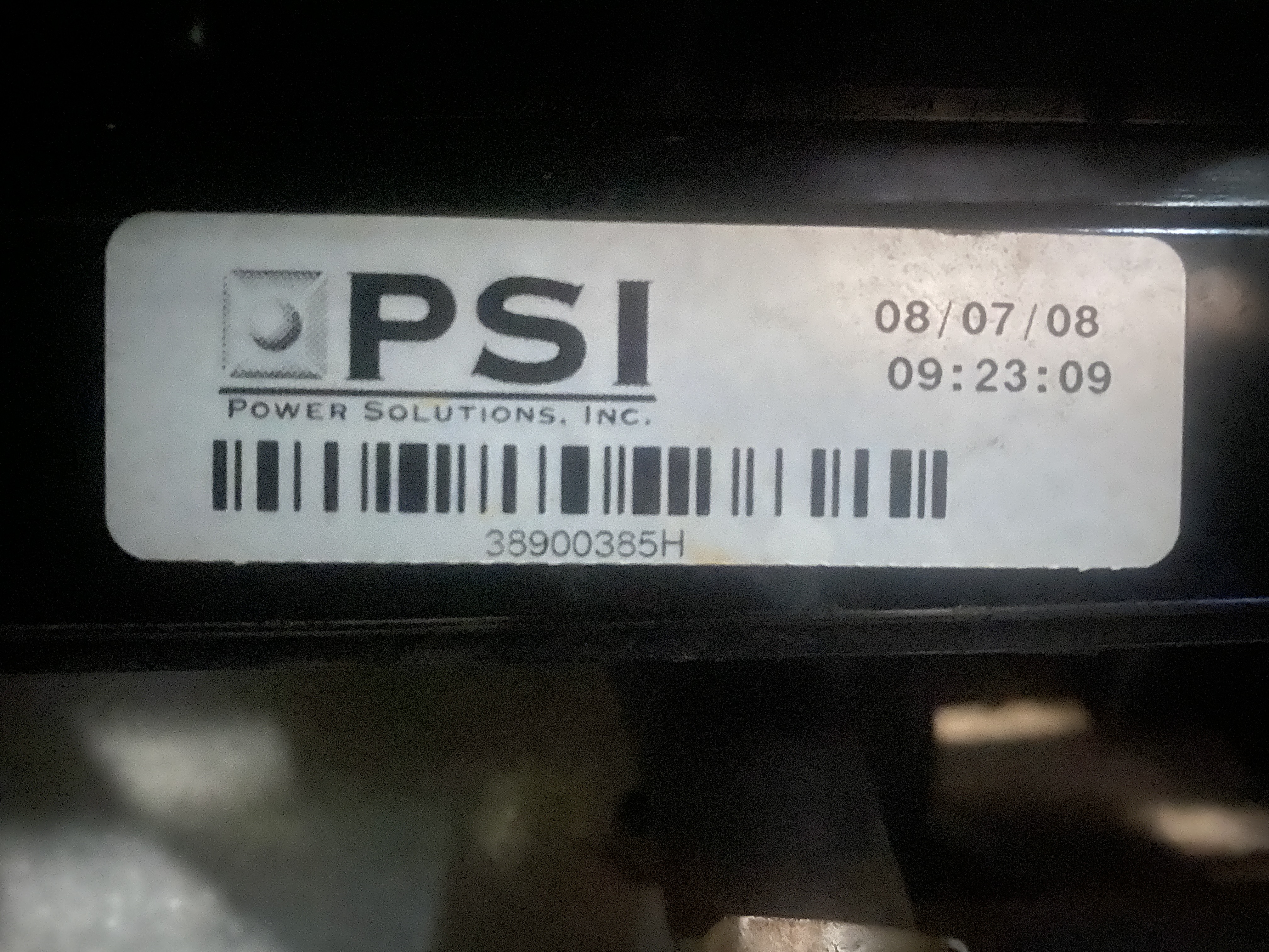

Is that a zenith engine? If so, I’m certain they can helpUpdate I found that some forklifts use same engine. Psi suggested that they may be able to help since no hydramaster dealer in my area could work on it. They replaced the fuel pump, o2 sensor and fuel filter but still same issue. I need help any suggestions would be appreciated. The bogging starts as soon as the thermostat opens .

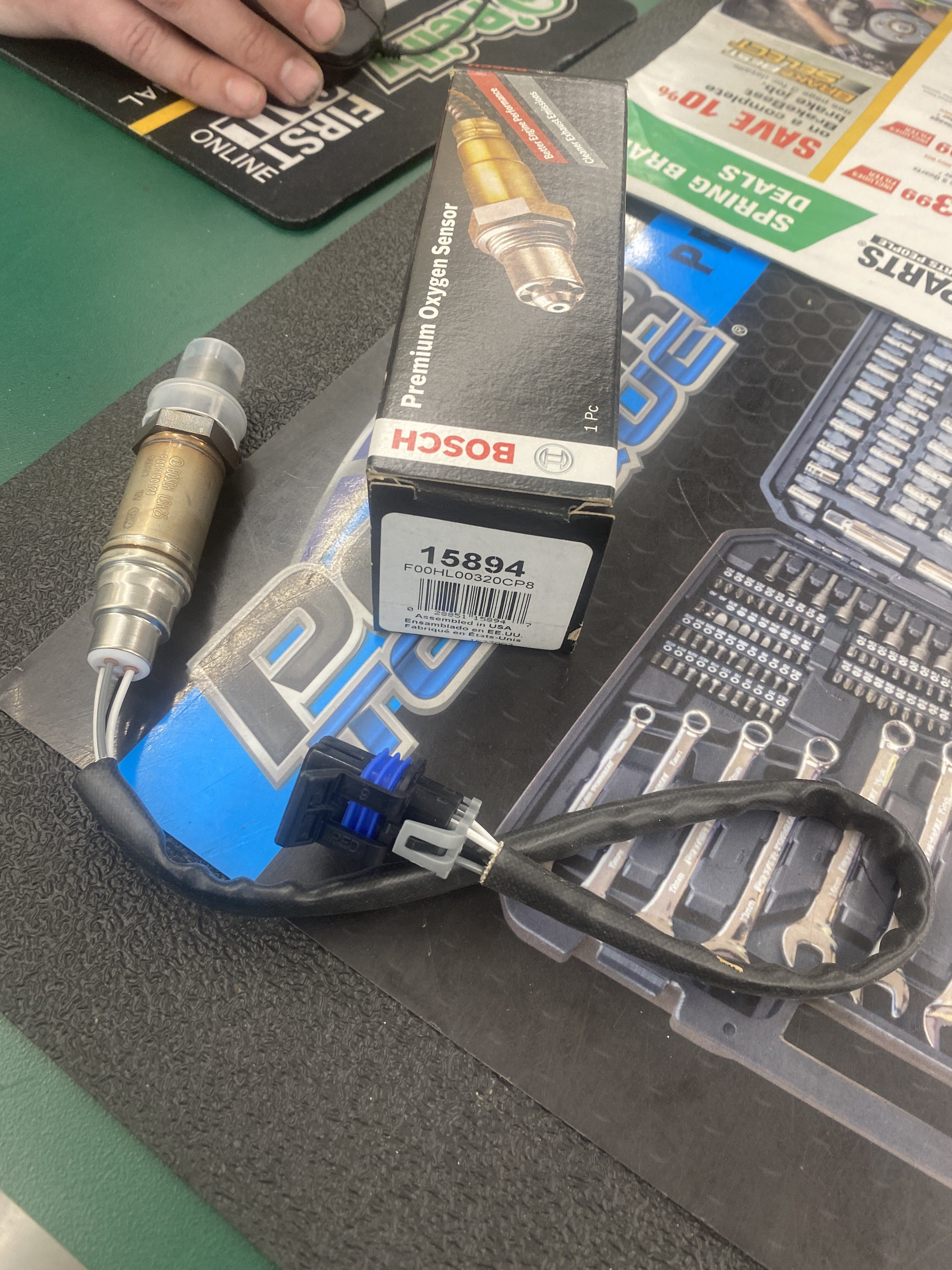

I am still having trouble but have a work around. Btw I also have a Thermalwave 11 . Psi engine for parts but pm me if you need some parts numbers do Orilies cross over . But if you run into any problems the guys at cleaners connection (gene) have been a life saver. My problem looks to be an o2 sensor and ecm. Tons of trouble shooting and actually was able to get the computer diagnostics cable to connect to my laptop and see all operating stuff .Did you ever find out where to get parts for that engine. I think my new to me thermal wave 2 has that same engine and I might need parts in the future.
Attached is the part numbers for Orilies . Coil pack, o2 sensor 1 , wires ignition, plugs , secondary o2 sensor. If you get a problem missing or stumble try wires and plugs first .Did you ever find out where to get parts for that engine. I think my new to me thermal wave 2 has that same engine and I might need parts in the future.
Thank youAttached is the part numbers for Orilies . Coil pack, o2 sensor 1 , wires ignition, plugs , secondary o2 sensor. If you get a problem missing or stumble try wires and plugs first .
