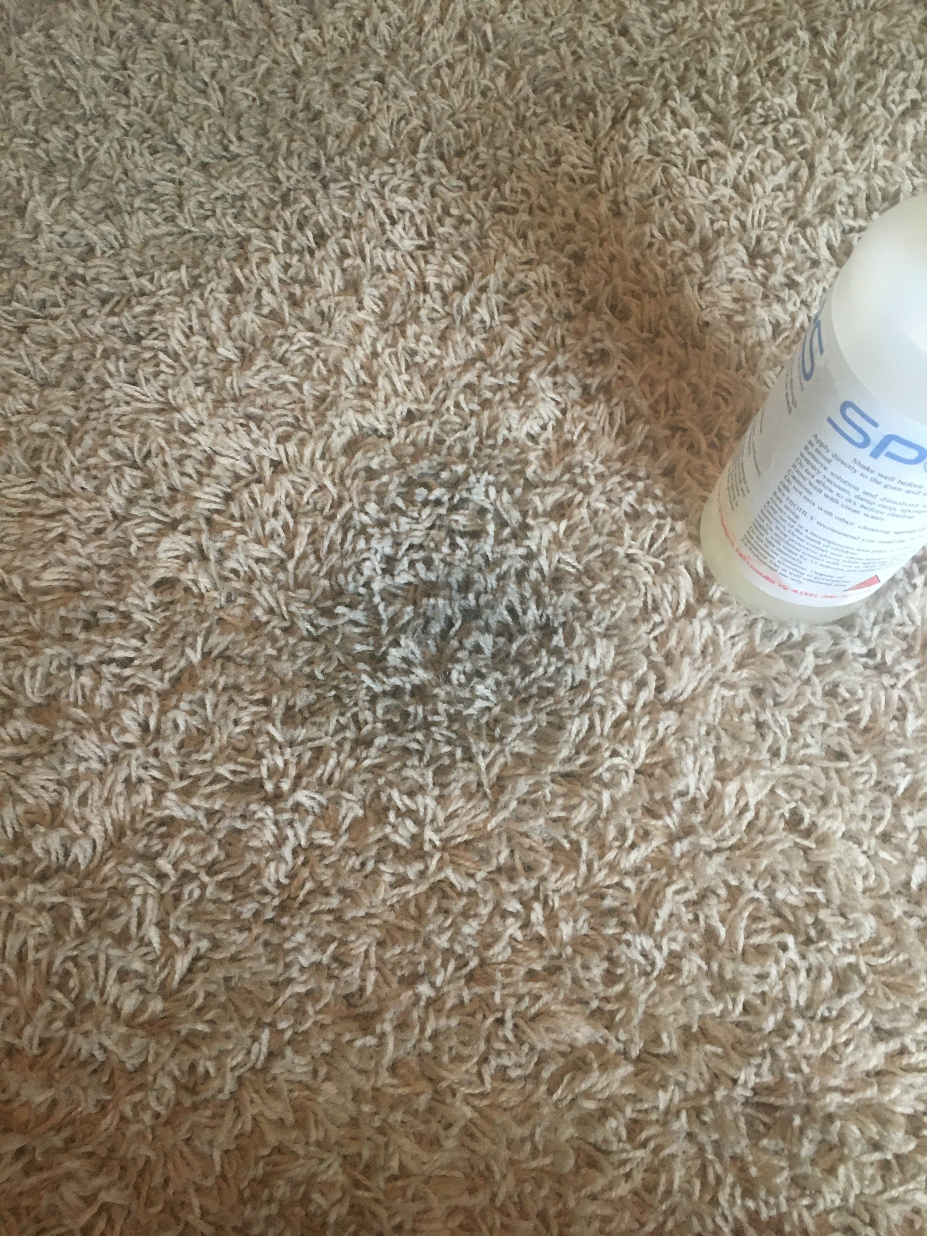

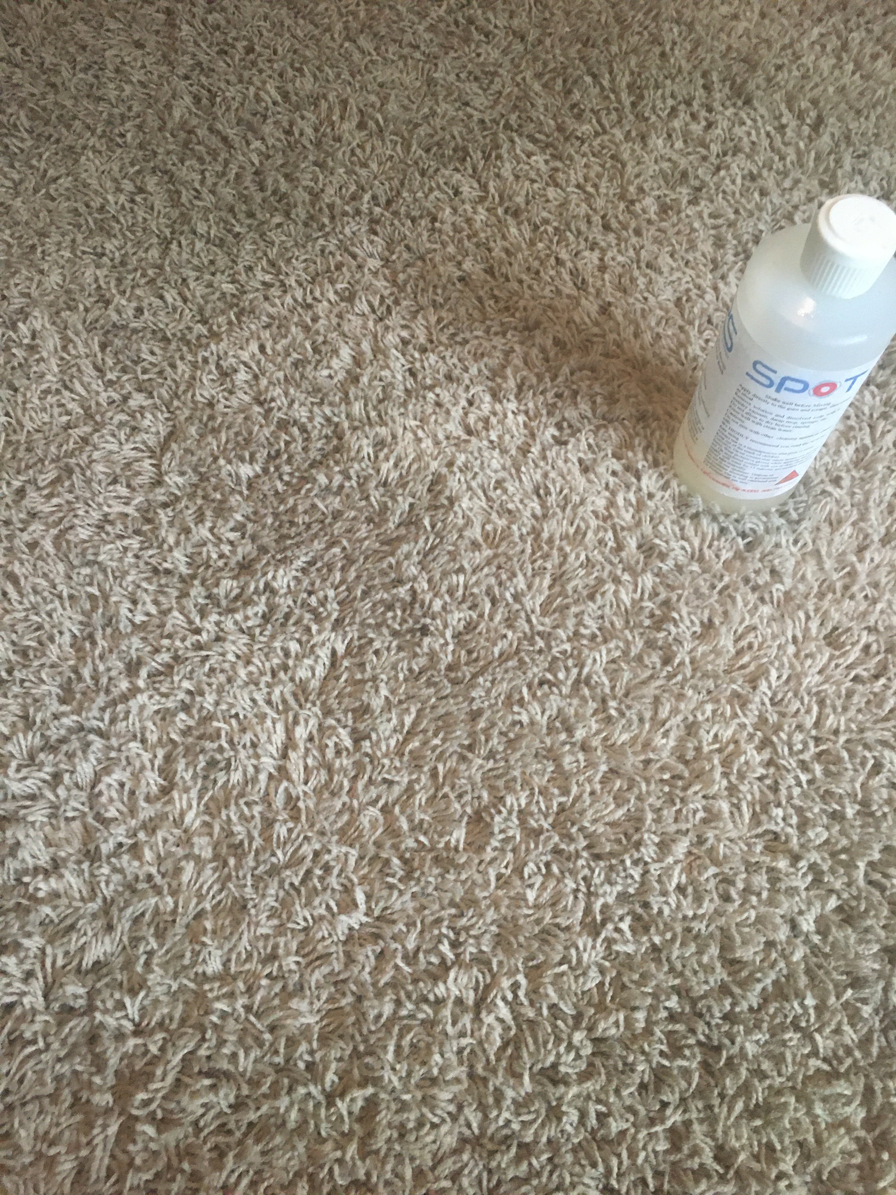

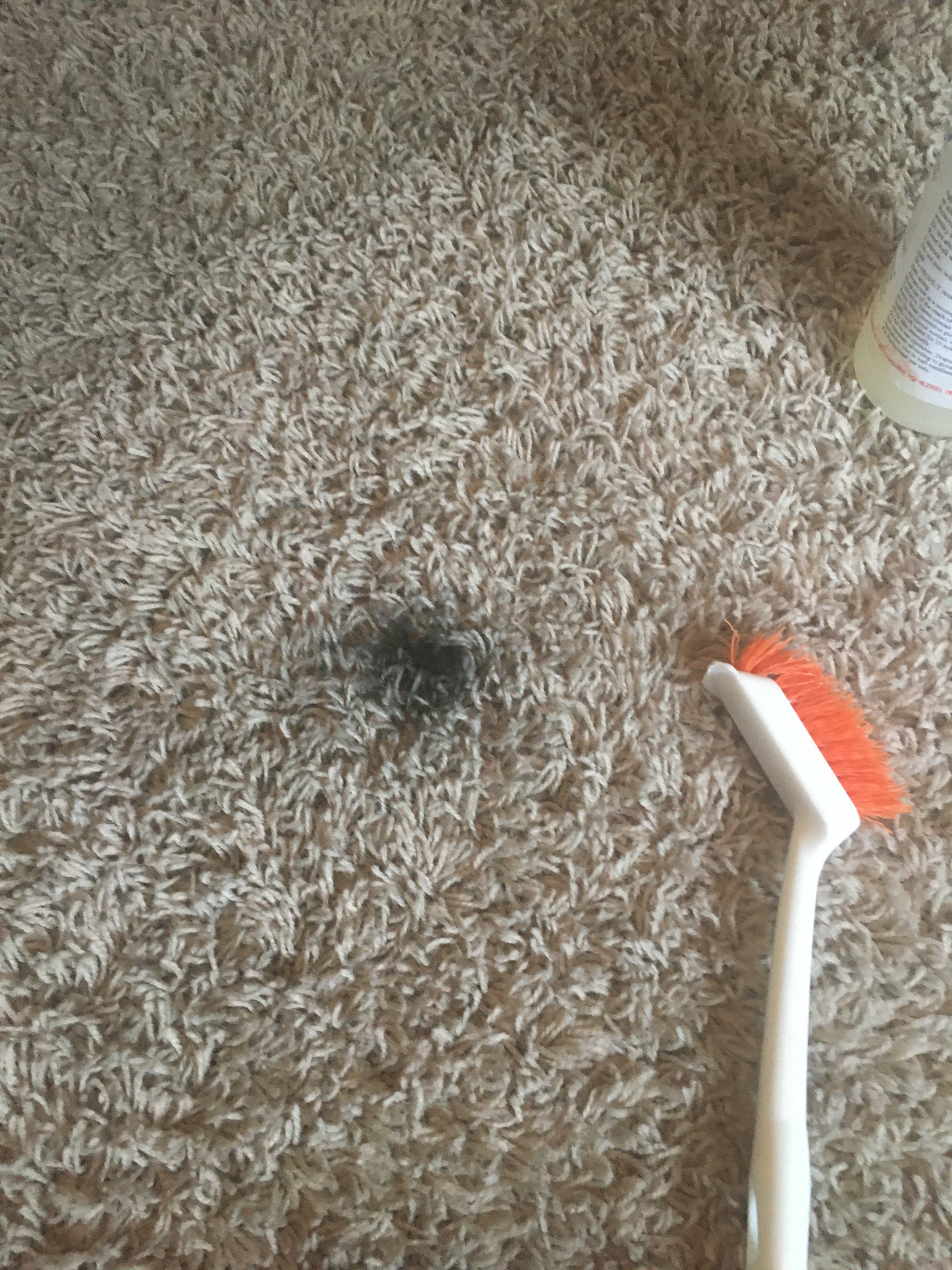

Stephen
Don’t you love cleaning and uncovering carpet leprosy? Even dilemonine didn’t take these black-as-Mikey’s-soul (henceforth BAMS) spots out. This one was big-as-Marty’s-ass (henceforth BAMA) and BAMS all at the same time.
Truly amazing stuff.
