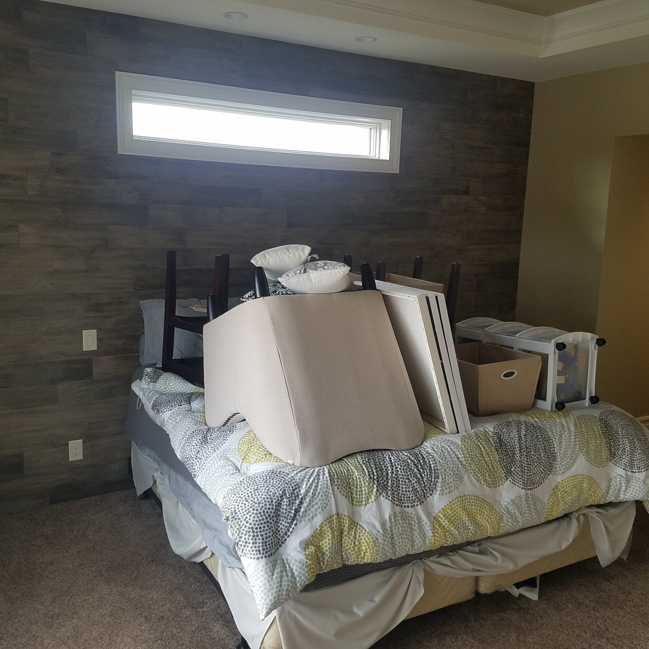

I saw this today..
That is vinyl glued to the wall.. I kind of like it..:icon_redface::eekk:
