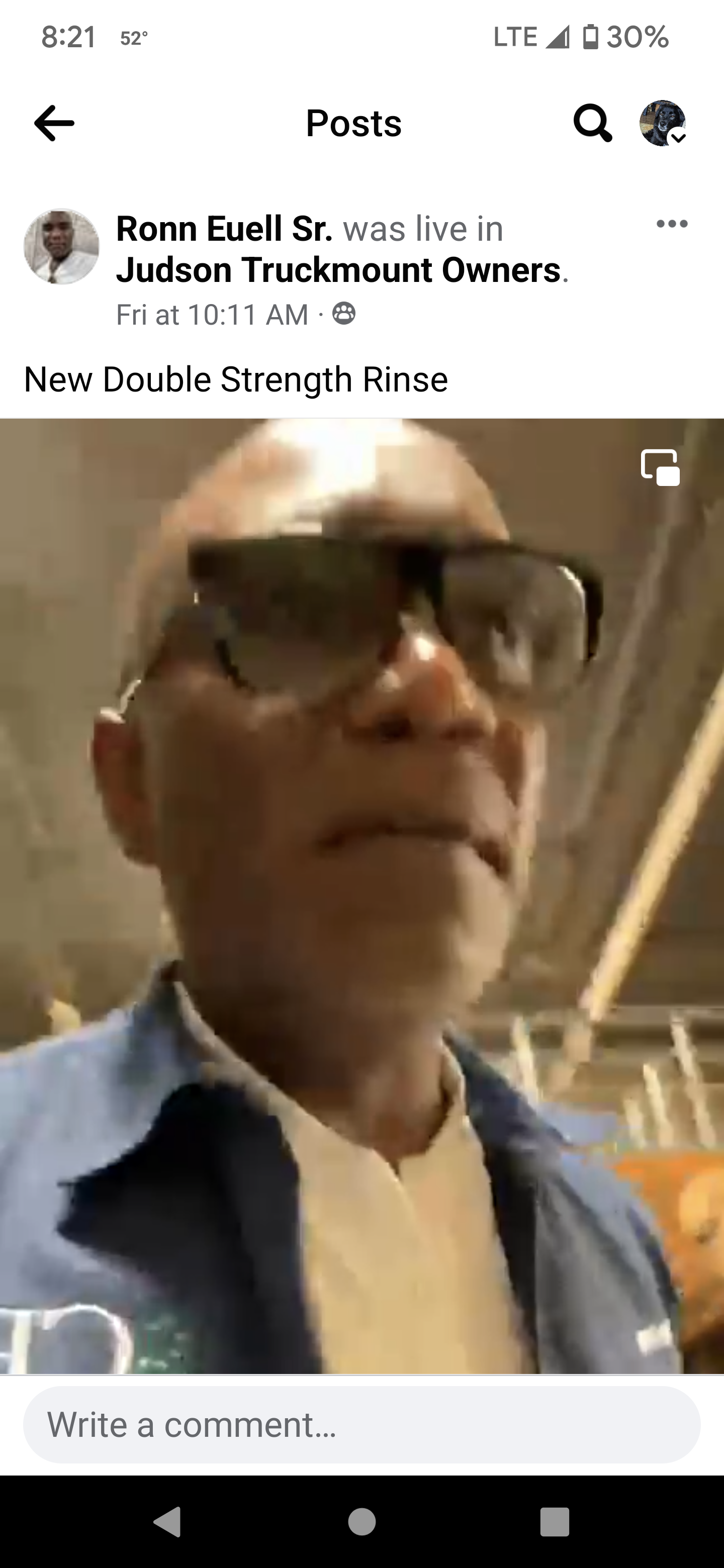

Video says double the strength

Judson 02 rinse is double the strength.
A 7 ph rinse new improved, but they basically made it more concentrated so it goes further.
It's not stronger surfactant wise?
It's a rinse I was hoping for a lower PH to neutralize ph.
117,338

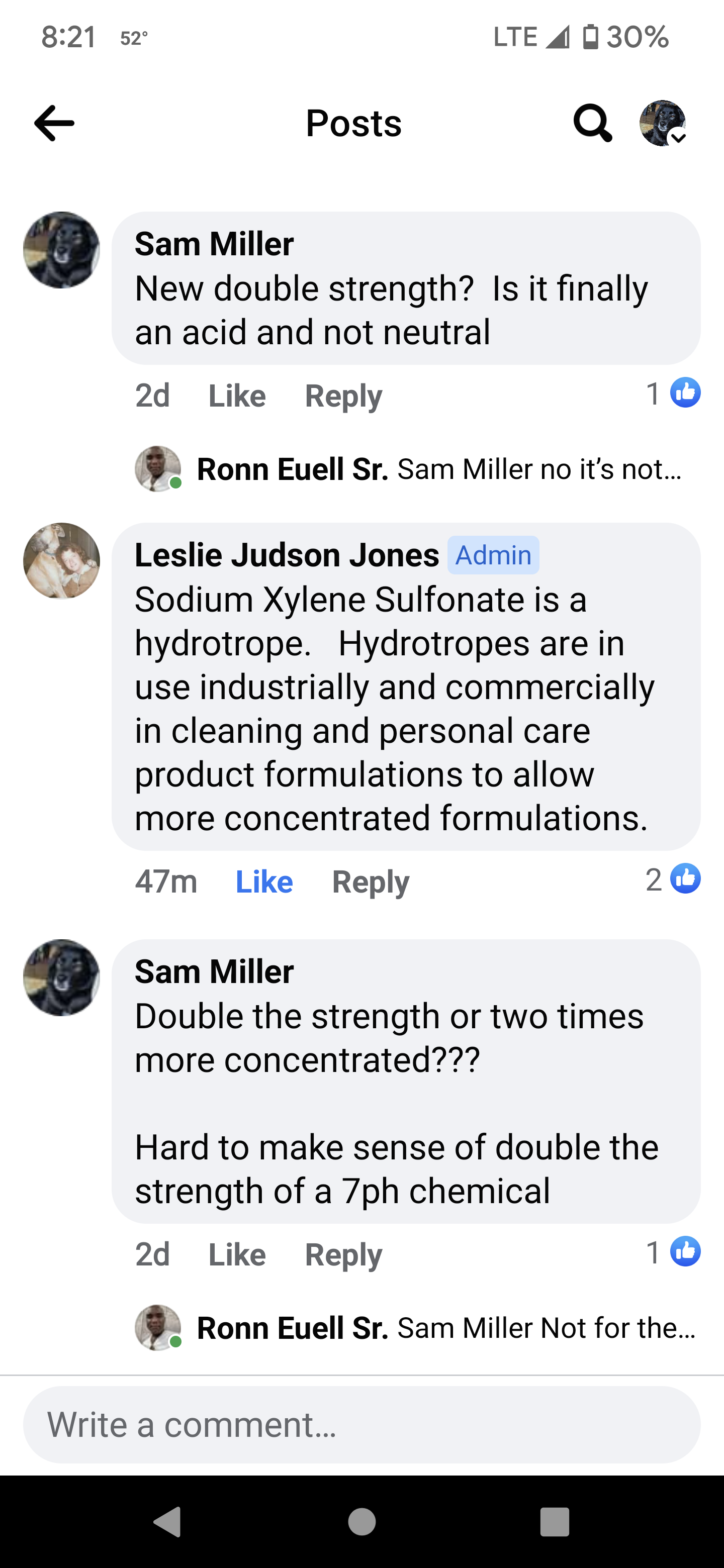

11,553
After all this time, shouldn't you have settled on a few time tested faves?
Well yeah last step or saiger rinse.
But it's being promoted as double strength.
Makes no sense.
Twice as concentrated is a better tagline.
It's still a 7 ph rinse

presumably it is double concentrated prior to recommended dilution, which would leave it as 7pH rinse..*

I'm not speaking for Les Jones formulation, as I don't know anything about it.
Sam, is your goal to rinse or to neutralize?
Unless you are cleaning natural fibers, or you are using a "nuke" prespray, a product that helps to rinse and remove cleaning agent residues is good enough, even if neutral instead of acid.
Acid rinses are dual purpose: They should help to rinse and remove residues, as well as lower pH on the fiber to prevent damage to acid dyes (fading or bleeding), prevent cellulose browning, or to leave natural fibers soft.
But if you don't need those functions, a neutral pH rinse agent should do what you need.
You could do a pH test reading on the carpet yarns after cleaning to see how well each product is working for you.

My father was contracted for a period of time to be trainer for Prochem and had that process as a part of the presentation, yes.
I just cleaned my carpet at home today today with Ultrapac Extreme and All Fiber Rinse myself today.
In any event, if you do like the pH drop, an acid rinse is the way to go.
BUT it doesn’t have to be an acid to rinse, it just needs to be an acid to neutralize.
Two different functions.

Video said double strength
11,553
I asked the question more concentrated?
And Les confirmed that with his post.
So it goes twice as far as before.
The wording had me questioning the product.
Not the product itself.
