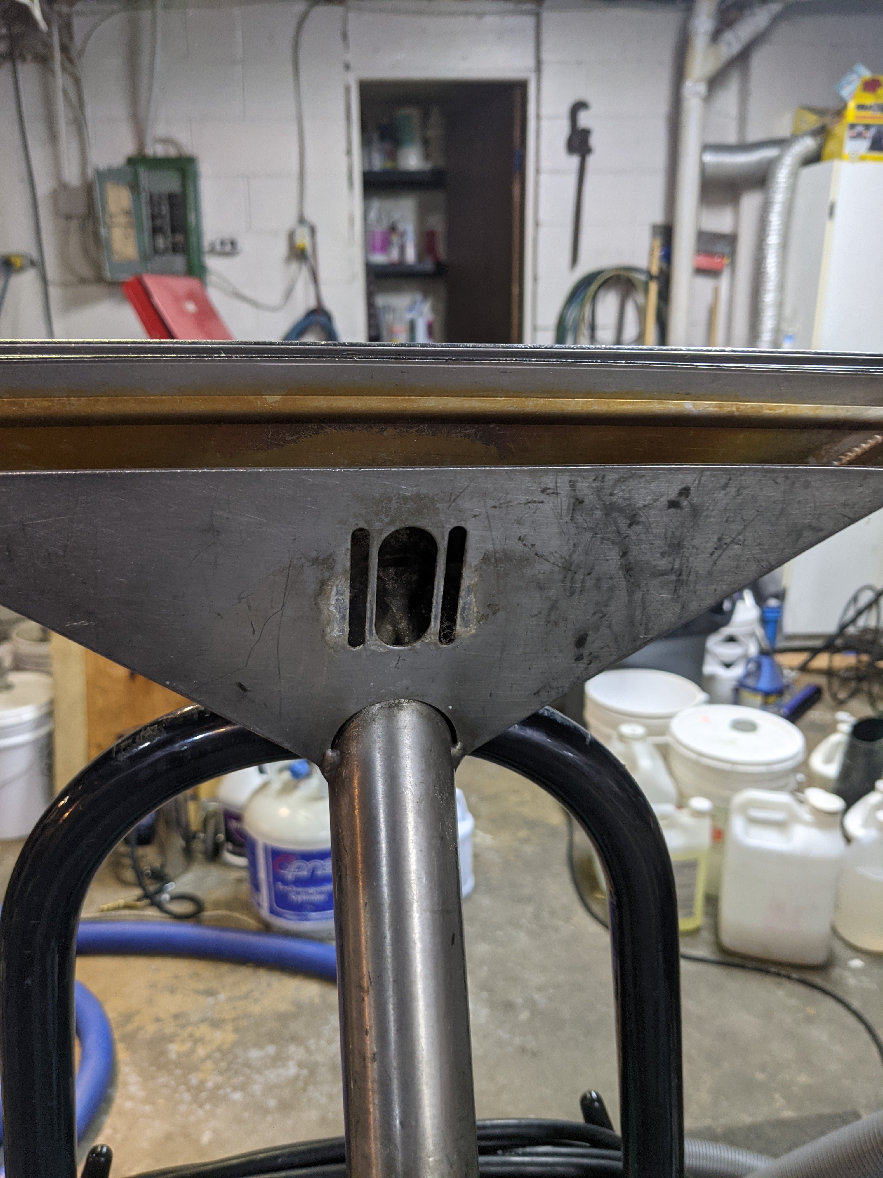

I still have a couple. I like the concept but they wouldn't pick up very well in the middle depending on the power of the unit and the style of the carpet. Very heavy wand. Probably an internal fit glide would help.
Can you tell me what the Jet size is on that thing
28,275
9 flow?
Can I borrow one?
I'm not sure how it correlates to a t or v jet but I remember it putting out what seemed a lot of water. There is some adjustment on the steamway wand to raise or lower the jet. Probably easier to find a jet locally but I could mail you this one. It is brass so probably worn out.

the slotted thingie on the wand head allows adjustment up or down jet height if needed
(for angle of spray)
I'm told the stock FJ is equivalent to 07 flow

With the back shield on the steamway wand you cant see the spray pattern.
Isn't that the wand I swapped with you for something or other? It came with Hirise Henry's gear with the little giant and the 2 steamway portables.
