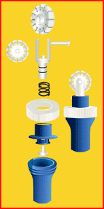

Please call the Grout Wand Company and ask them why they insist on using non Viton O rings on a tool designed to apply solvent based products.
I can't tell you what a treat it is to get half way through a 2000 ft tile sealing job and have your brand new applicator fail. There are two O rings on the plunger that swell up and cause the wand to let the sealer drip out non stop.
I have gone through way too many of these wands due to this exact problem. This could be eliminated with .20 worth of Viton rubber.
I think it was Olsen who told me to buy a new one for each job. BS! Our landfills are full enough.
I can't tell you how irate I get using tools made by fools.
Would you five gentlemen PLEASE call this company tomorrow and tell them the facts.
Its a sad state of affairs when the best sealer applicator for our industry only lasts for a 1000 feet.
Call this number ASAP :1 480 835 0582 or send Greenie 10 grand so he can design something that works AND lasts.
In the mean time, Olsen send me four more of those POS.
ps. Tell them to make the darn thing 6 inches longer and make it all one piece so it holds more juice.

Larry Cobb needs to be the first one to call those guys. His sealer kills that stock rubber.

I'm just a hair taller than Todd and I can hardly use it, I hated that tool, by the end of the job I'd have a blister in my palm from holding it way out on the end trying to keep a little angle out front and I walked.
There really is no excuse, it's just plain lame.
There is hope though....
The cap assembly has a simple acme thread pattern, and the stick relies on a flat rubber washer, so it's "possible" to make a custom loooong hollow handle and machine to match those threads. Then you could just buy the POS o-ring leaking plastic replacement heads and be at least one step ahead, and a LOT more comfortable.

I've already done it !
I complained to Hydro-Force after we discovered the problem a couple of months ago.
I asked them to install Viton o'rings for better durability.

Hydro-Force?
I'm pretty sure I bought mine in a hardware store somewhere?
Larry, how hard can it be to match the orings?
