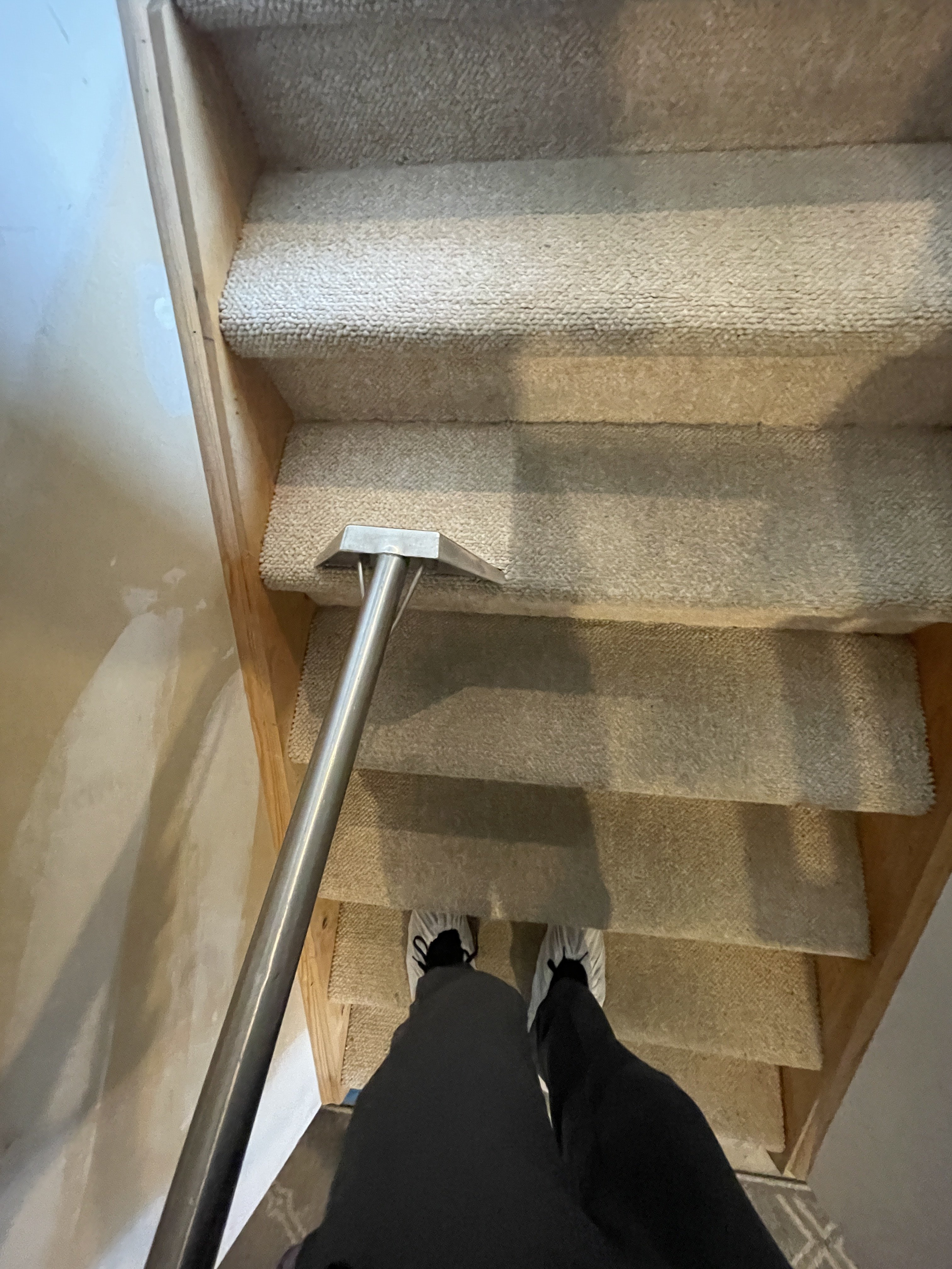

She totally understood and just went with the stairs (this time the ones to the garage for the first time), the little landing area connecting the stairs mid level, and the Master bedroom traffic areas. $220.

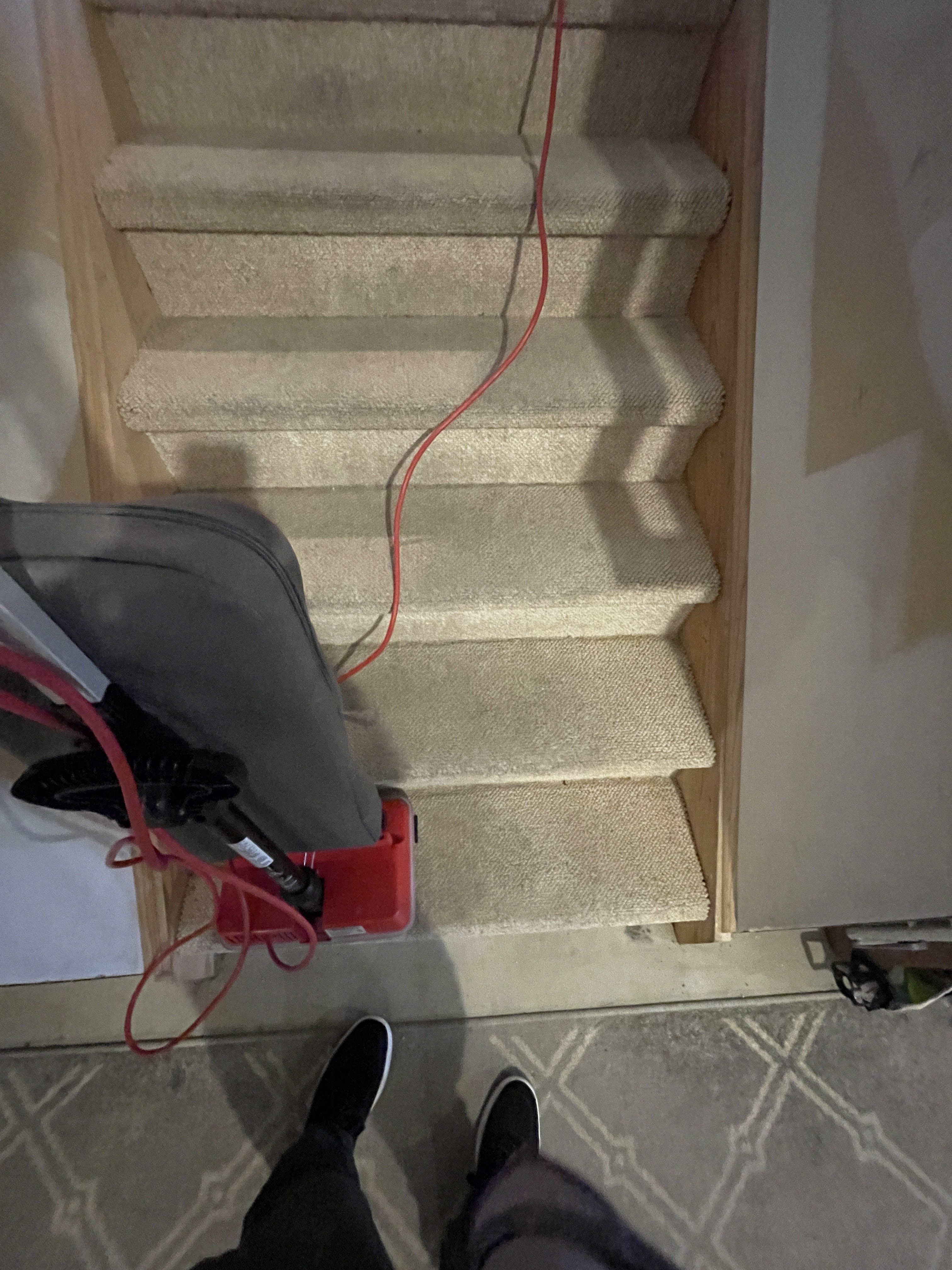

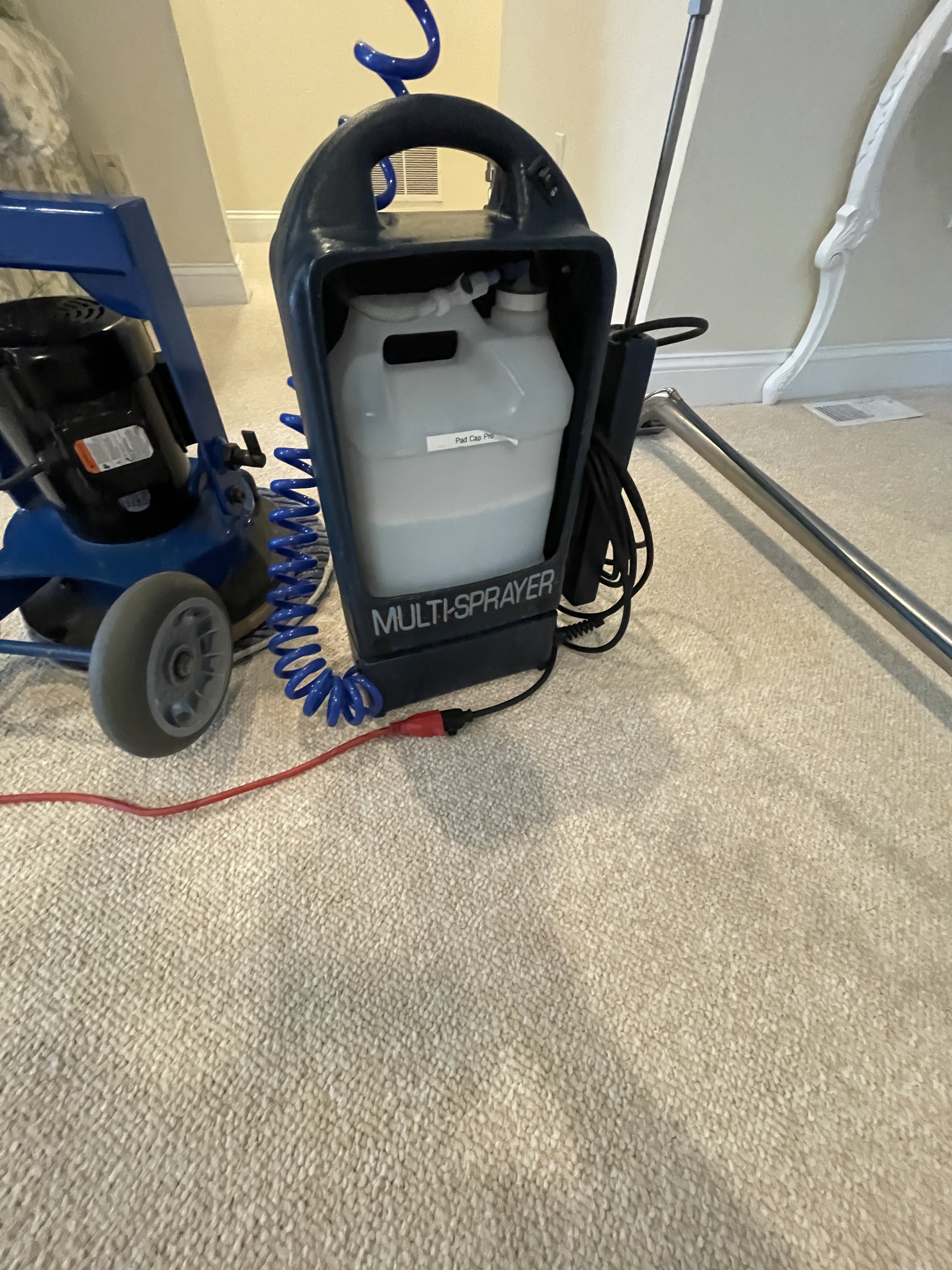

So I did my double vac of the Oreck followed by Kirby and used Tops Pad Cap Pro and the Odyseey to do the hallway and living room. She is so happy and has 4 freinds and neighbors, one let me in.

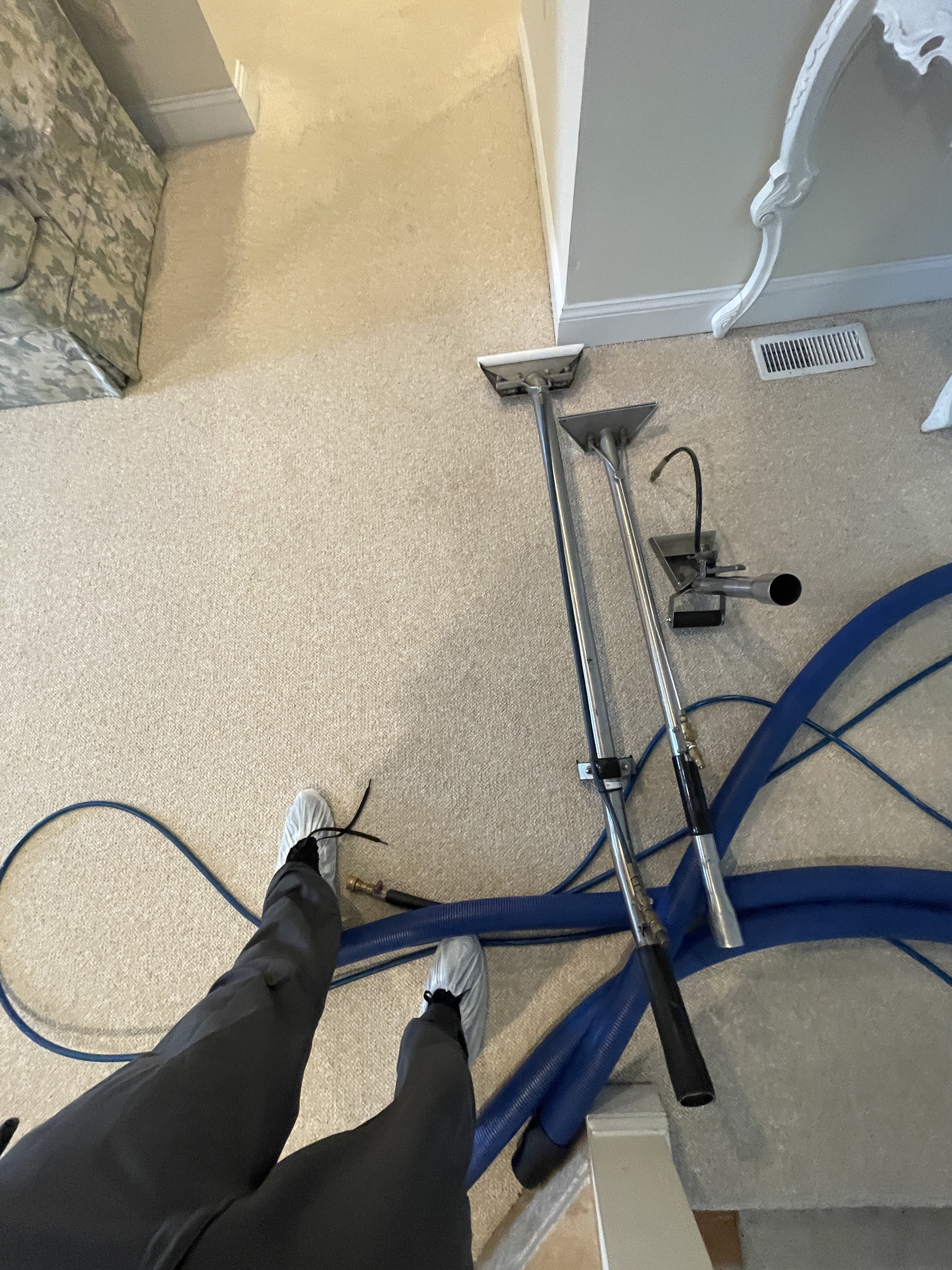

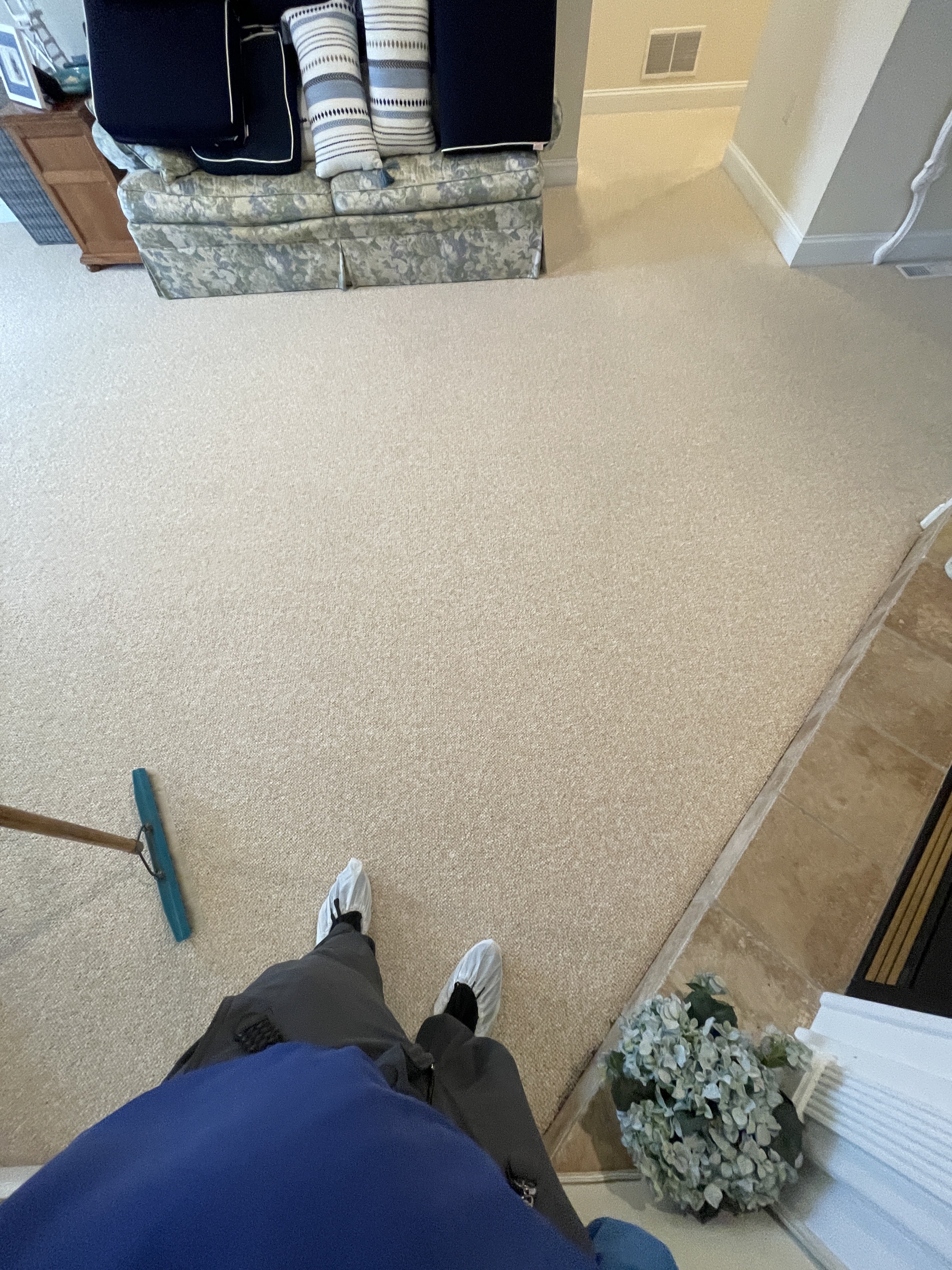

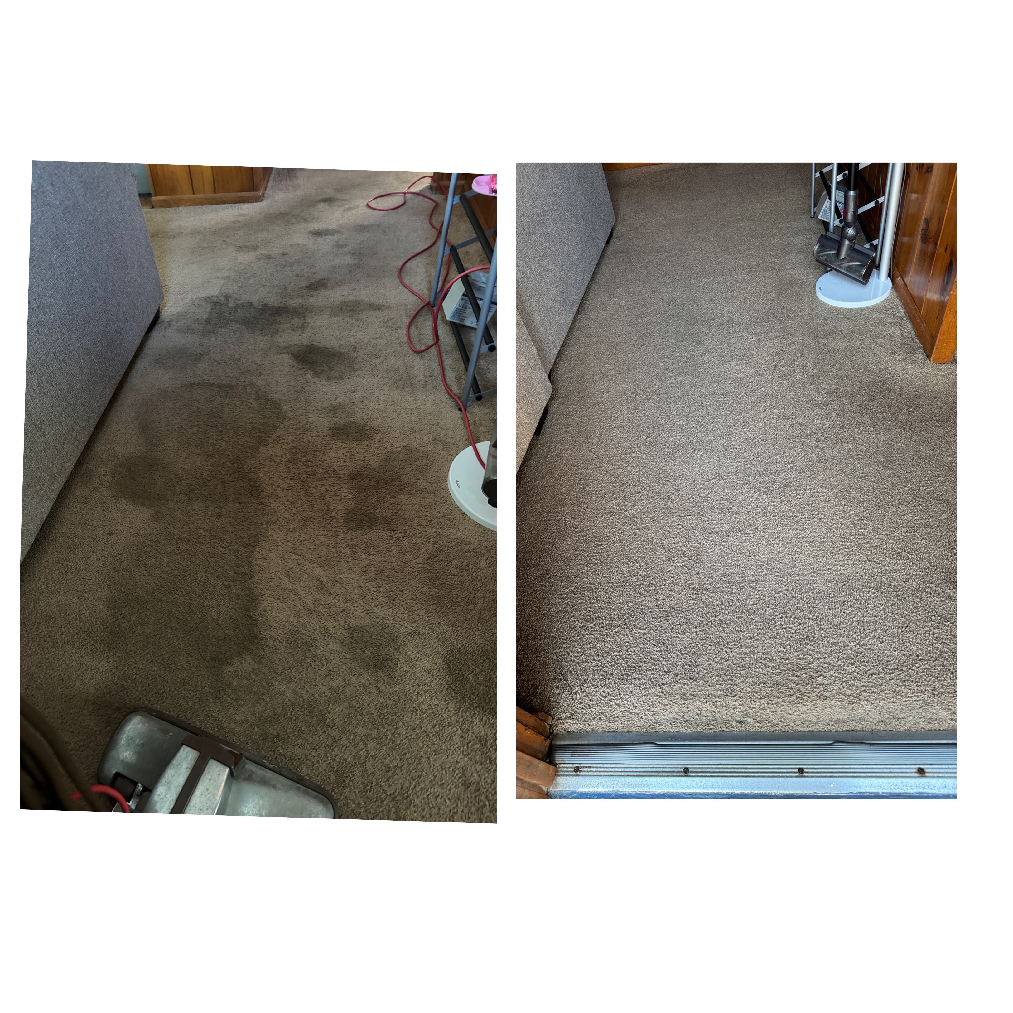

Results amazing, once again my camera sucks, and the lighting was horrible. But the pics show the area im talking about.
Where the PCQJ is and the other wands is where I HWE along with the stairs. To the left is just vacuumed.

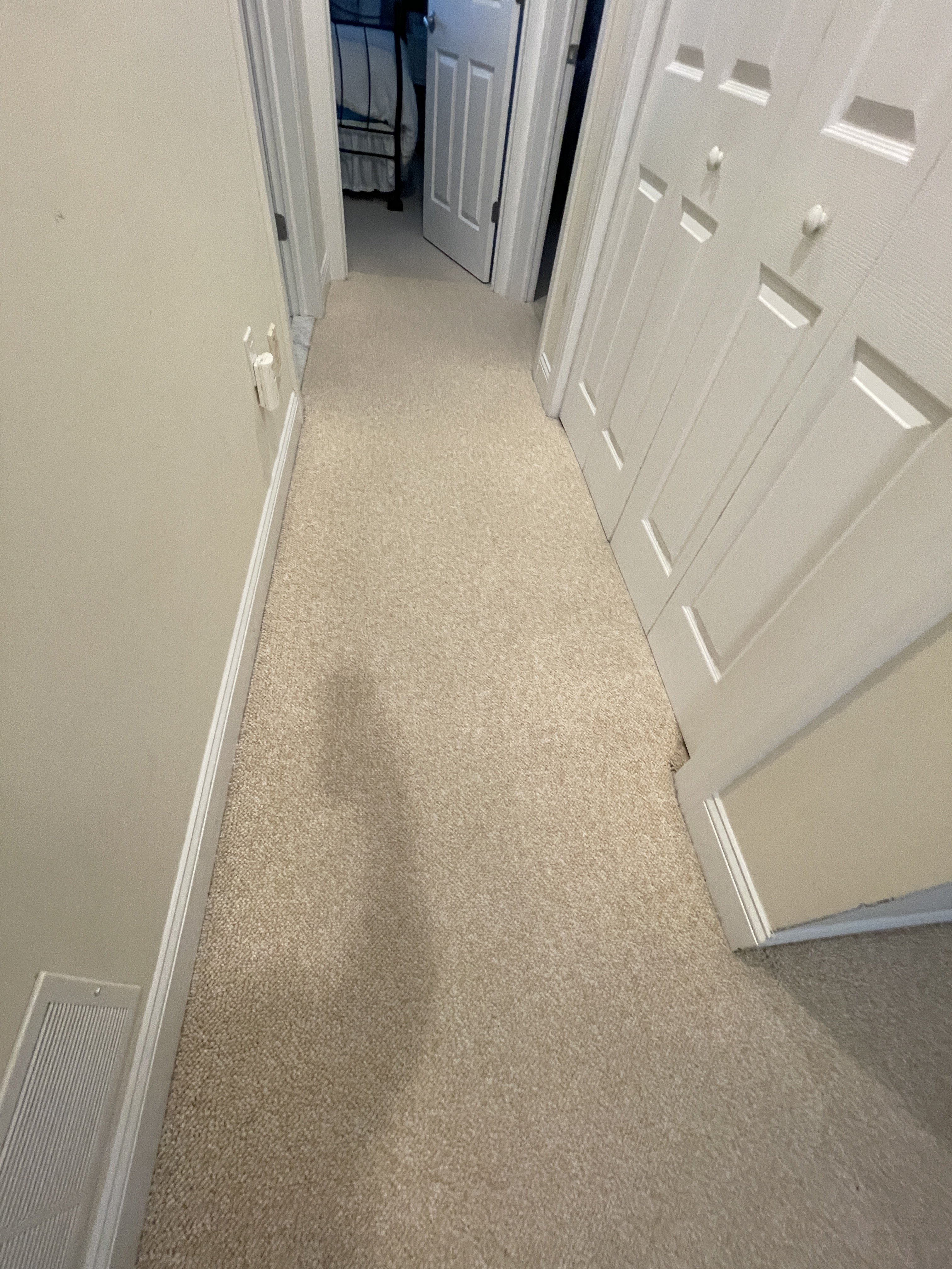

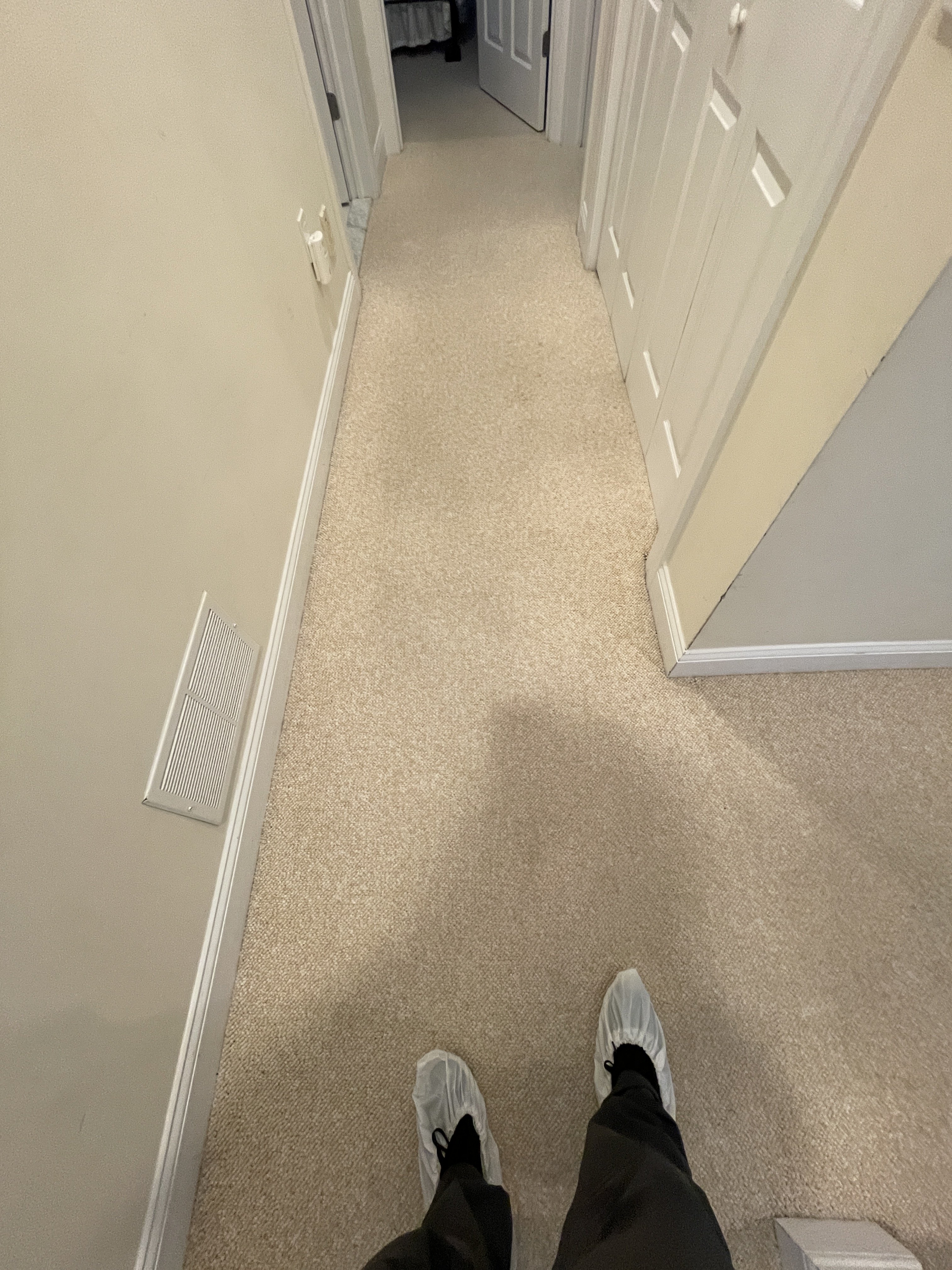

Heres the hallway she wanted but not in budget.

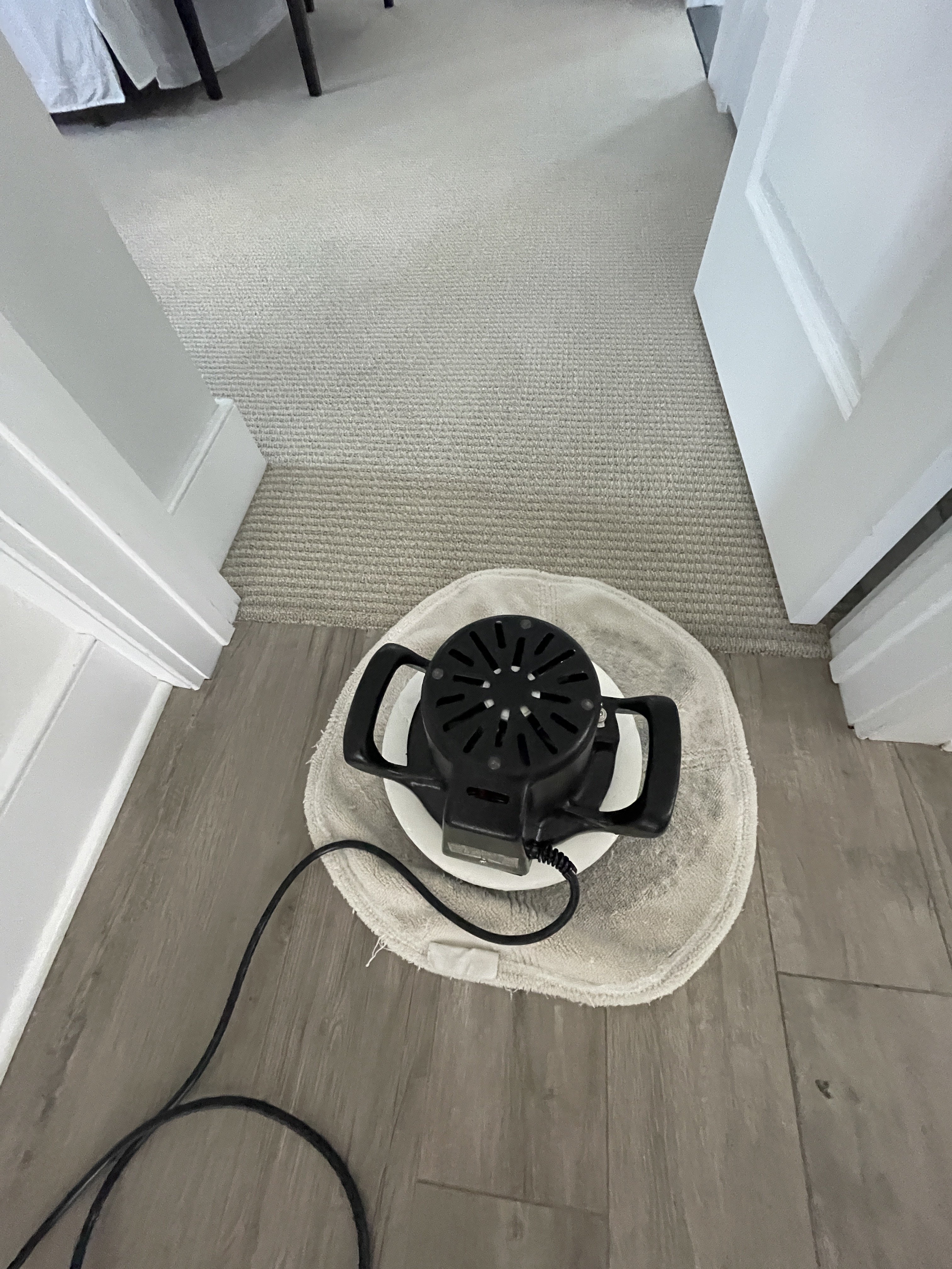

After Odyssey with Pad Cap Pro, agitation pad and cotton pad.
I also let the Pad Cap Pro dwell for 10 minutes as I was putting away my HWE hoses. I made certain not to touch what I padded and mess it up with water, lol. Seriously, she will give me and her friends the feedback of this experience. I feel good about it.

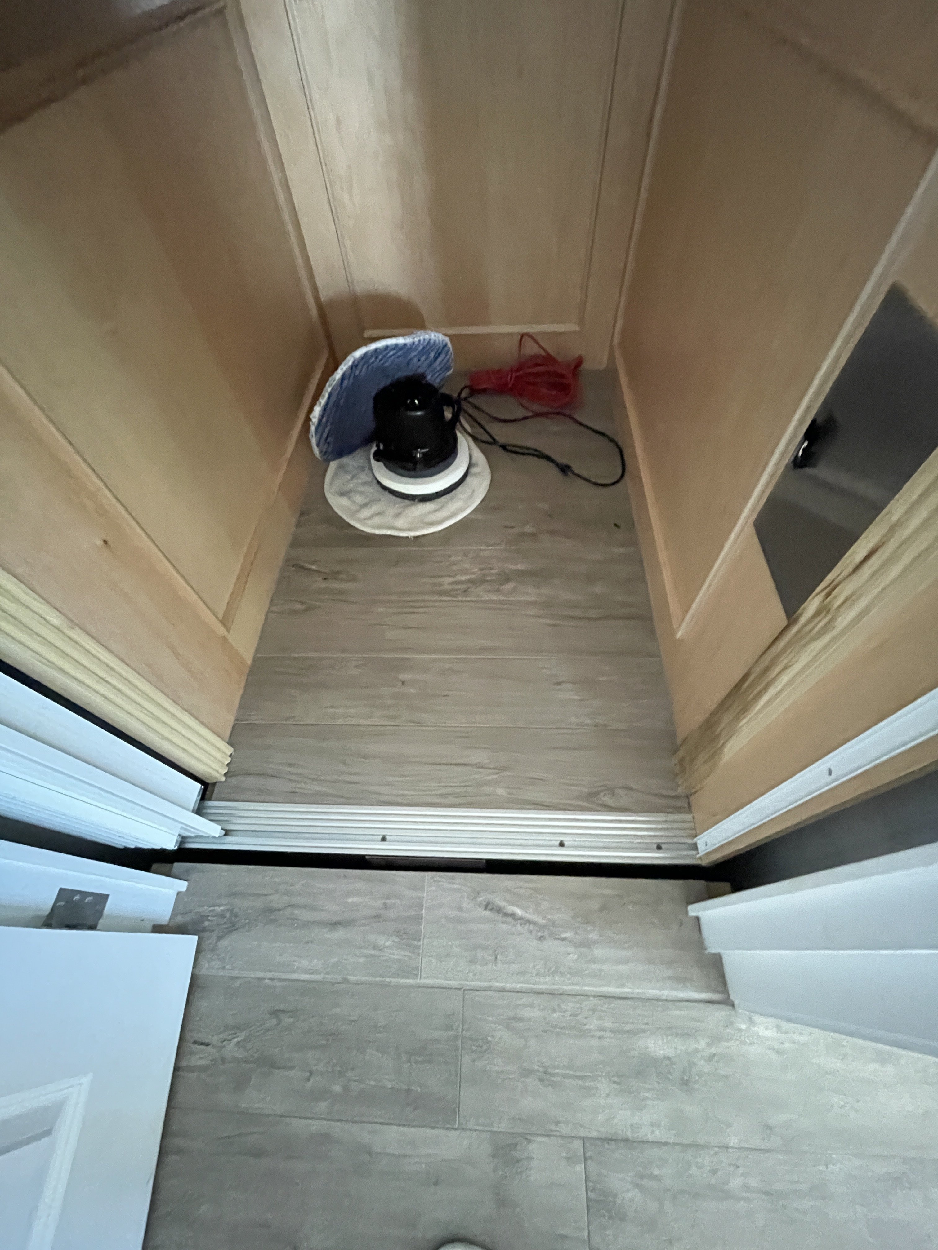

I had a 5 star waiting for me to clean a few spots on cushions and the Bedroom entrance and spot. Thank you Trinity Stepson. This house has no set up except inside using all the stairs. BUT there is an elevator. So I put the barstools, 5 cushions in the elevator. One section of hose into garage and HWE. Then I took my Stepson for an elevator ride.
Vac and VLM what was needed. Got paid with a good tip and was so happy I fit her in.

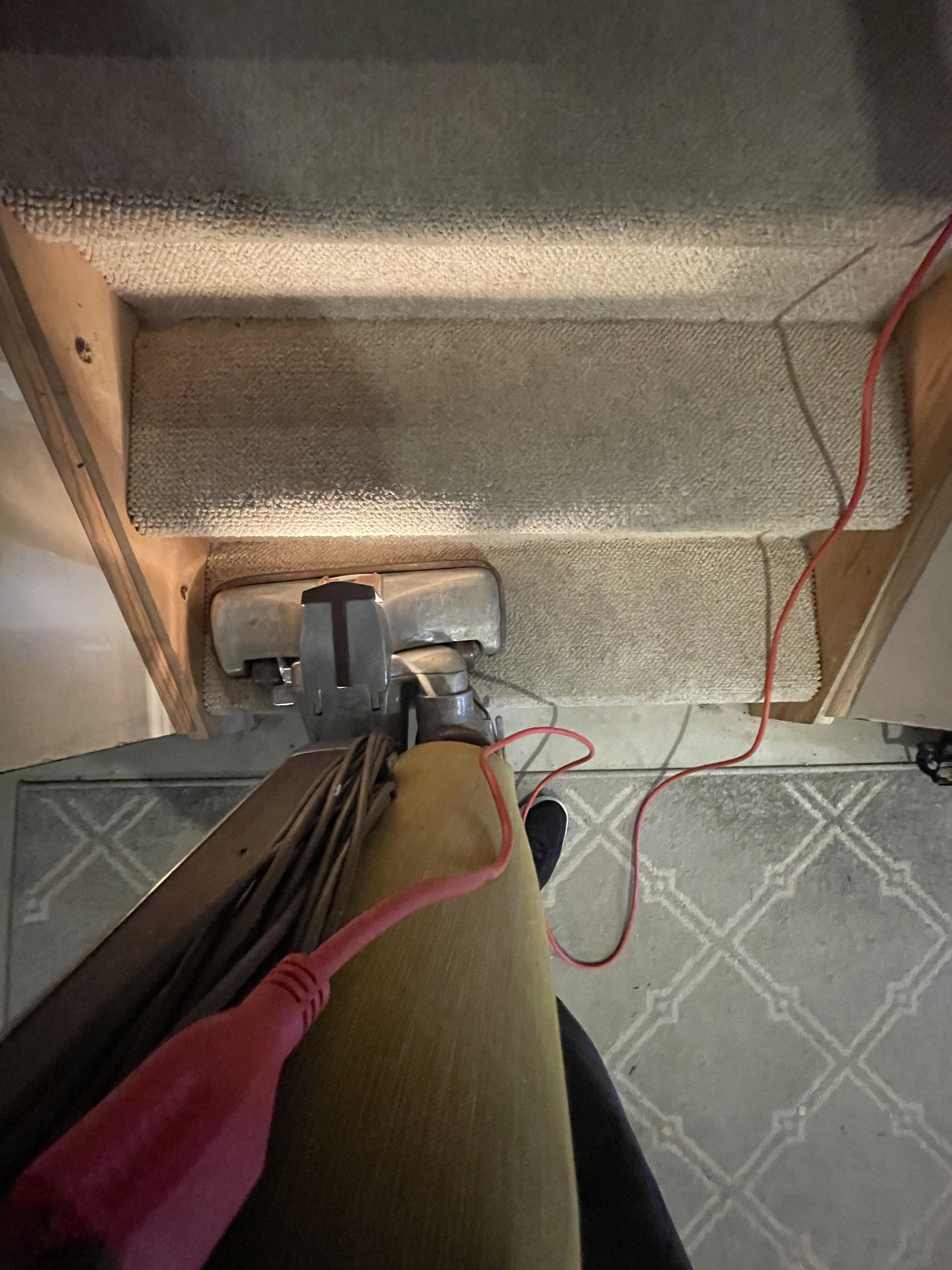

Nothing a RotoVac StairPro wouldn’t do better and dry quicker. Sorry Bud
Listen, dont be sorry. If it will do better and dry quicker, has a small enough footprint to carry, im in. I clean insane amounts of stairs.
I am ALWAYS looking for improvment.

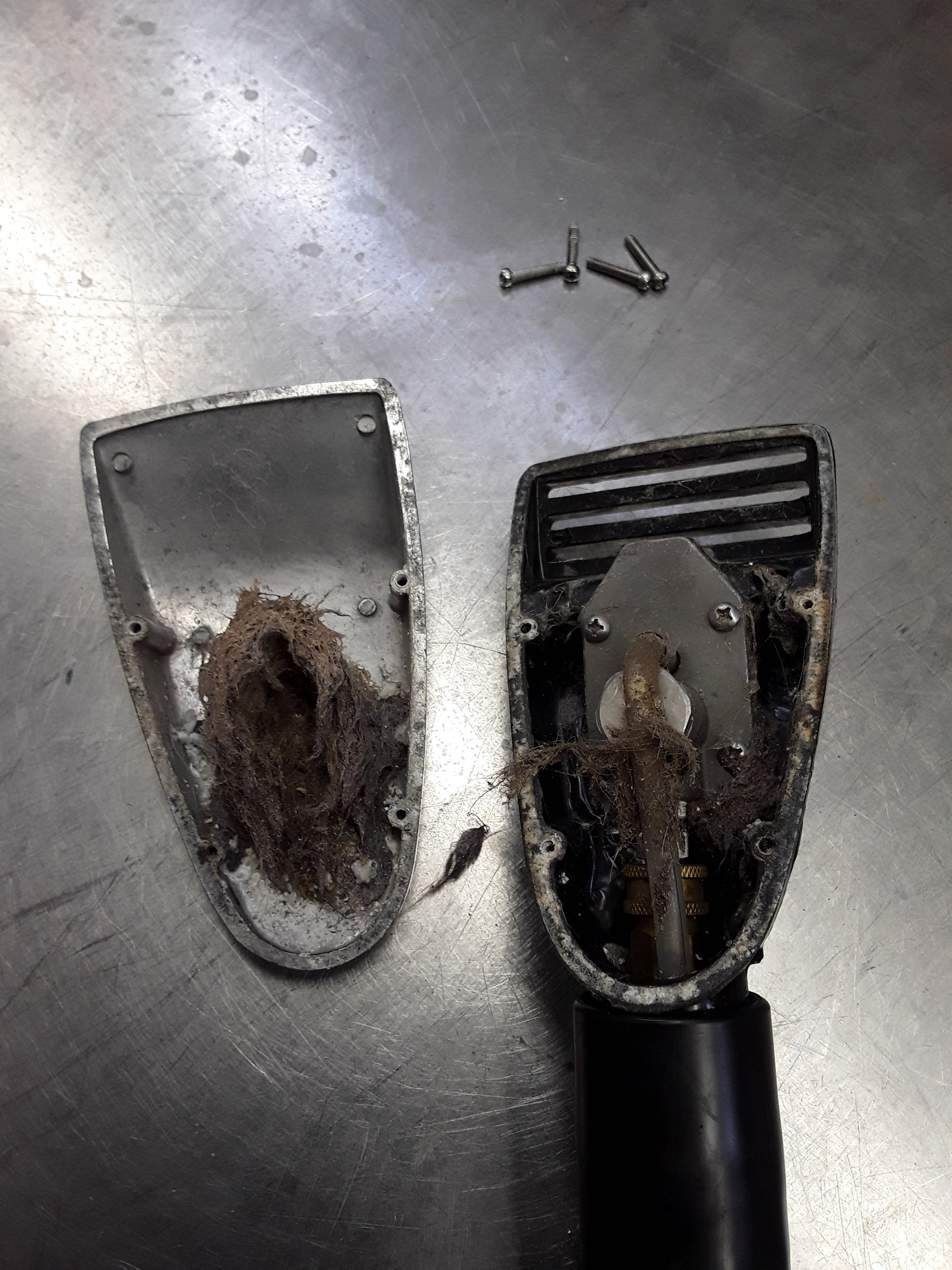

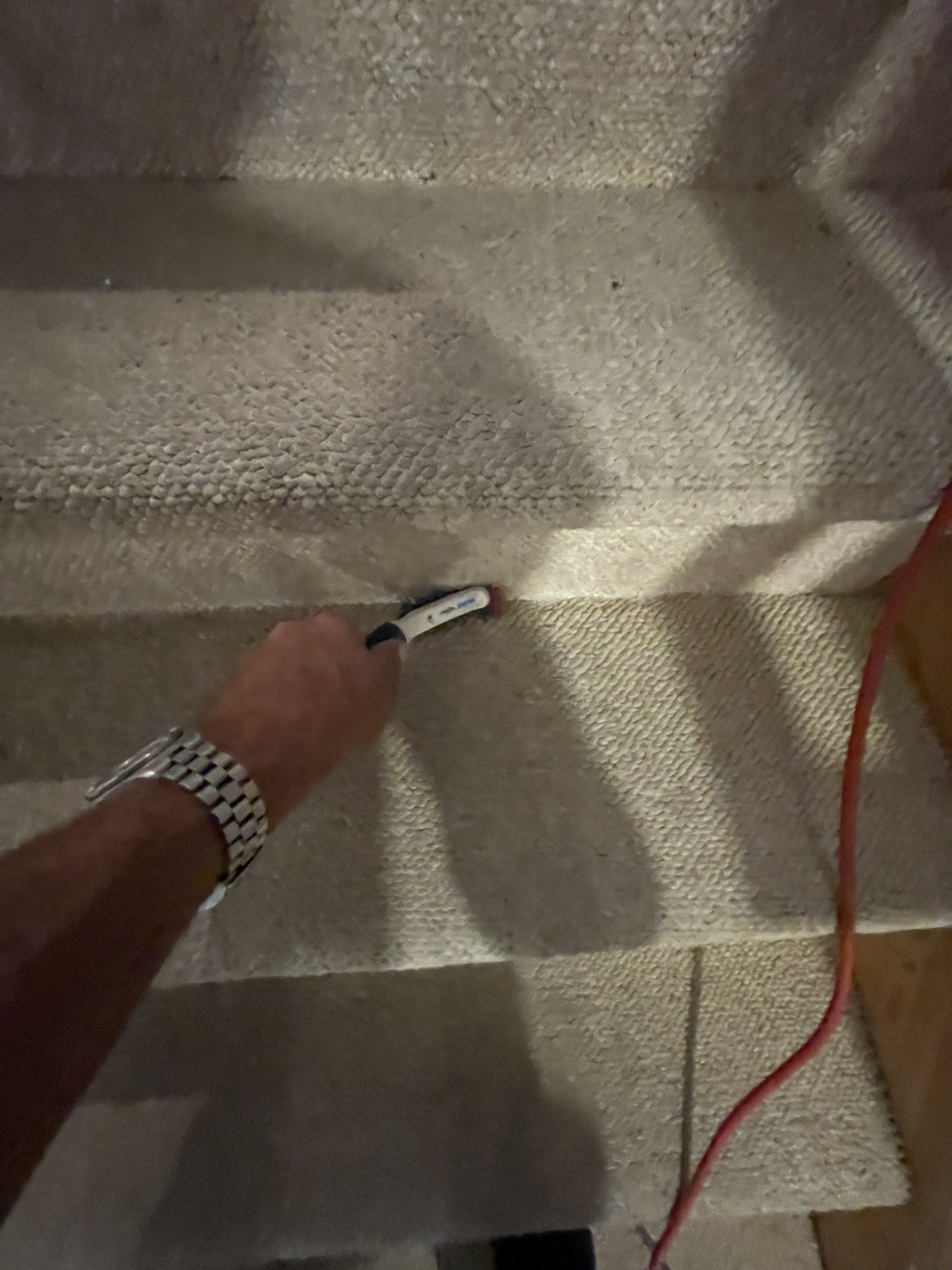

Works fantastic on the bullnoses. Rarely ever have to clean he risers, and when i do, use my Kleenright hand piece.
View attachment 124531 View attachment 124532
I always do risers, at least go over them to grab overspray. Sometimes concentrating on bullnose gets em and sets me up to extract. Im not a fan of the RX 20(?) either. I had one.
I like seeing whats going on since most my carpets are not trashed, I keep an eye out for residue foam from homeowner spot cleaning. This just seems easier with my PMF 1530 or PMF 1530DBL for tighter staircases. Plus they have many other applications. Outdoor cushions, sometimes indoor, that PMF gets it done. Same tool. Under beds, same tool. Cubicles same.
I would like to try one of these someday, but definatley not ordering until then. Thanks for sharing.

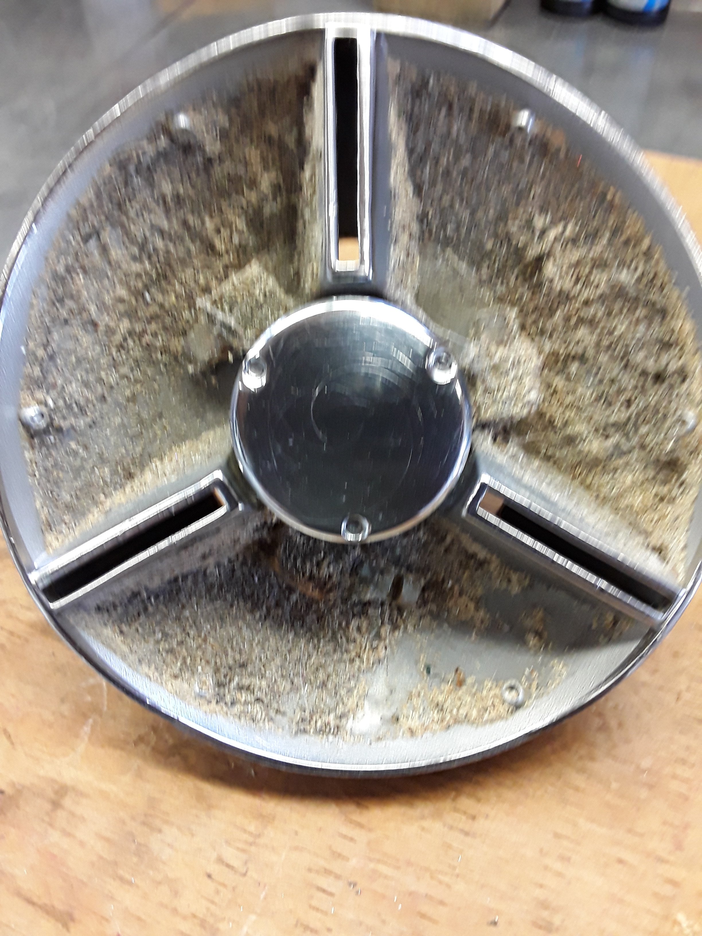

I have several cleaning heads, all of them are choked down to one jet. Each of the heads has a different jet size from .5-1.5 increments, depending on soil load. I also control flow with the valve I removed from my SS hand piece and put on my lead hp hose.
If you look at the picture of the cleaning head you will see the ss glide on the bottom of the brass distribution chamber which allows me to edge over the bullnoses. It wouldn’t be possible to do that with the stock heads.

I didn’t see one picture in this thread that I would’ve felt the need to pull hoses for.
You need a more aggressive scrubbing pad for your Odyssey. The MF pads from TOPS aren’t enough.
Either get a CRB or use a tan scrub pad, then onto the Glads or a better MF extraction pad, like Polar Pads from encapstore.com
For the nasties, you might try adding a splash of ammonia to the PCP to up the ph a bit. But that should be rare.
Also, during the scrubbing phase, OP machines scrub best when you push them faster, so they have that bite on the carpet.
When you extract using pads, go slower.

Ps: invest in a stepdad, it’ll change your life on stairs. The stepson doesn’t have an enough head weight and doesn’t have enough power to handle putting your own weight on it.
