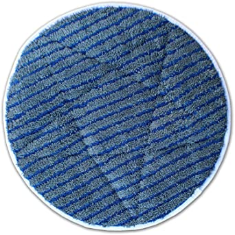

The ”Bucket Test” is what really converted me, and I suggest you take the test as well. Go clean 500 SF of dirty carpet and put the blue microfiber pad in a 5 gallon buck of hot water, and let it sit for a few minutes, then stir the water with a pole and watch that water turn as dark and nasty as what comes out of your truckmount’s waste tank…
If you don’t understand after that display of gravity defying logic, than perhaps you might want to consider a career change to window or rain gutter washing.
Better yet, go visit that job a month later and let your mind soak in how great the carpet STILL LOOKS.
No wicking, no dirty dish rag stench for weeks after cleaning, far less resoiling…

This blue microfiber?
You used the wrong pad
You used the wrong juice
You should have made more passes
You didn't pre vacuum enough
It would have all came out in the post vacuum
Your heart was just not into it
You just don't understand
What else will those lying dopes say?

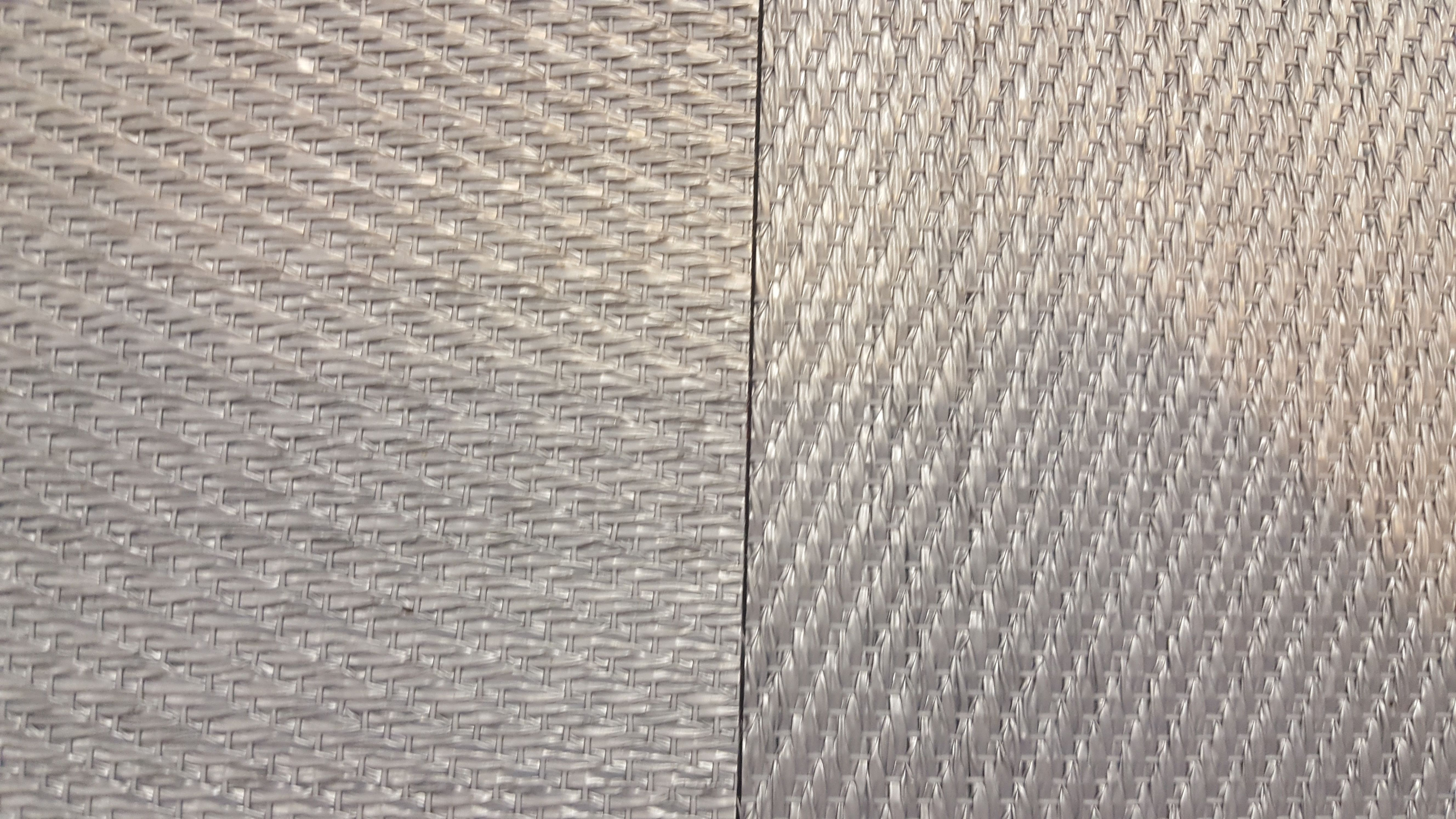

I'm going slightly off track here, but Mikey started it with water.
I have a large Health department job that I've been doing for a number of years.
Their lunch room has synthetic carpet tiles which no other carpet cleaner could get clean.
I wet down the tiles with WATER, the janitors had already left plenty of detergent on the tiles. 😉
I then went over it with my CRB ........ Perfection.
That won the job for me.
These are the tiles, dunno why two printed.
Forget the bit about two, just the one photo of two tiles show in the post.
