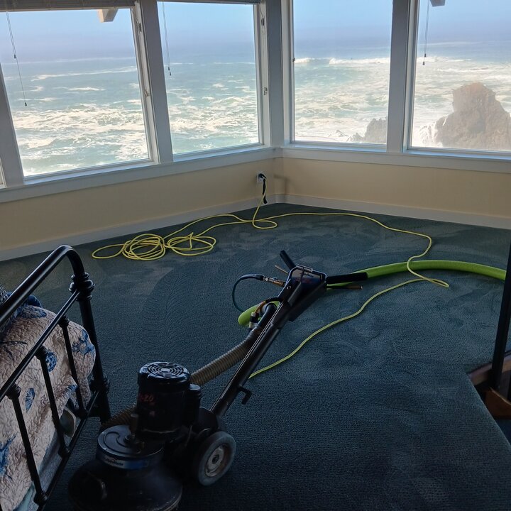

I don't know enough to get into the fray and obviously It's rare, but would a Rotovac be worth the nasties and this carpet occasionally?
We have the RotoVac 360iBH for the nastiest of carpets- But You MUST clean the entire area with the wand again. This is because the 360i will leave behind dirty water in the carpet.
We use a CRB for moderate soiled carpets because 1 crew member and be scrubbing while the other is cleaning.

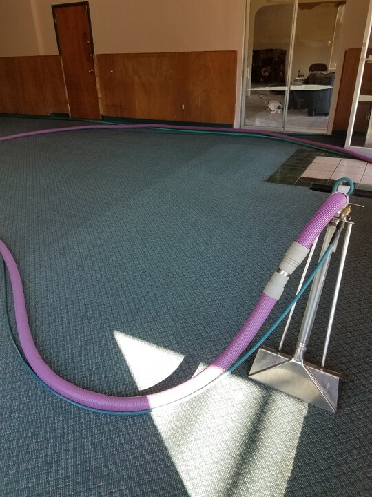

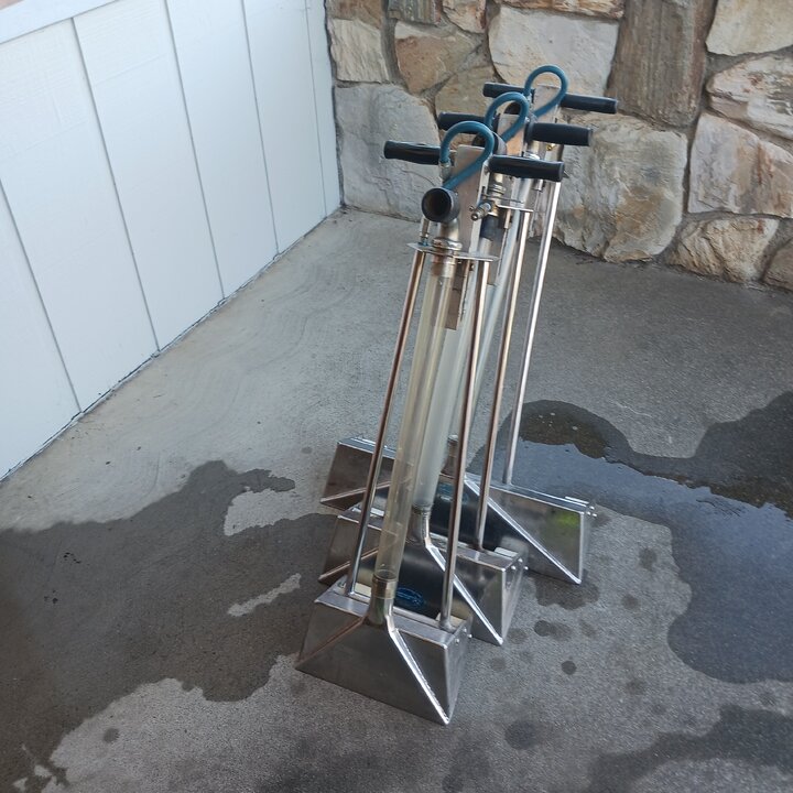

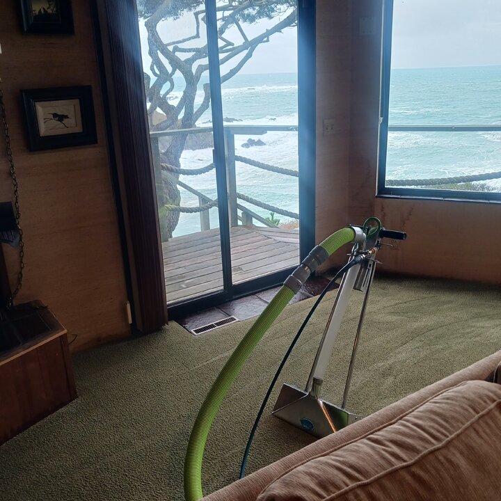

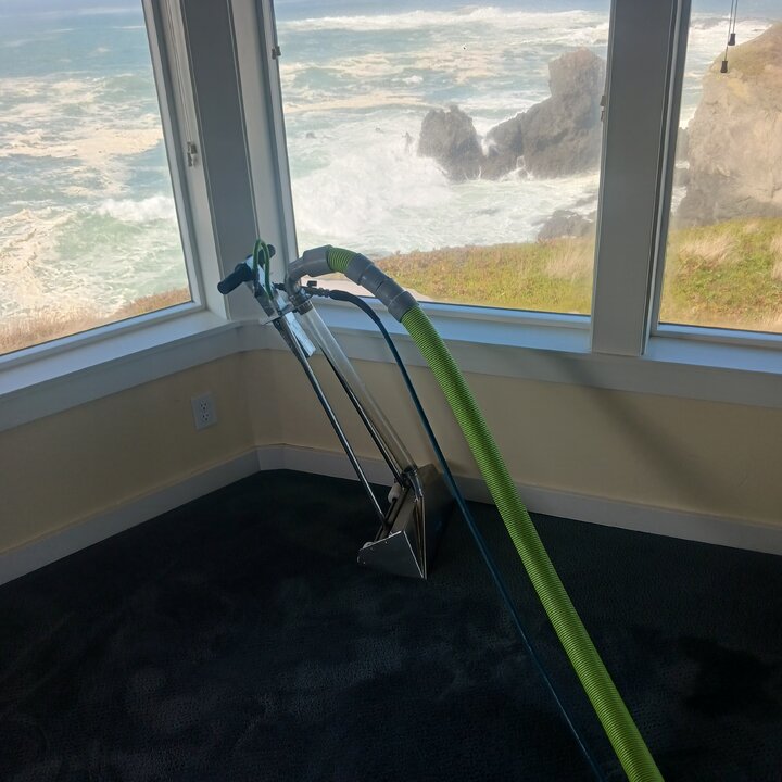

Those things look sweet Dwain-o. Are there any good modern makes of drag wands?
Not to my knowledge. Ive used drag wands since my beginning. The 16" (middle one) is the tool used on every job . Because it's way lighter, the 12" (front) is what i use one area rugs and in tiny homes,5th wheels and large rvs Because its more maneuverable. The big 24" has the same weight as the 16 but 2more jets. To tell the truth i just got it in a deal i found on Facebook and don't really have must experience with it.and theres a company in Utah that goes around the country cleaning Mormon churches and uses them exclusively. Im trying to find them and see if there intrested in buying the one i have. I first clean with a rotary then rinse and dry with a drag wand one of the nice things about themis they go right to the edges and corners (no edging) also they dry really well so well that if you were to stop and continue spraying they will pickup virtually all the water they put down . And the 2' clear tube gives you a easy clear view to monitor your progress i own several of the 16" but only one each of the 12&24

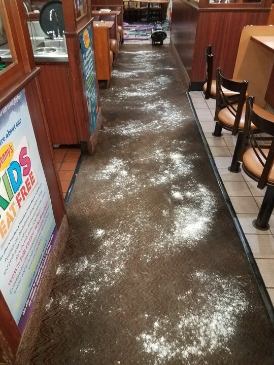

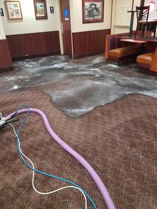

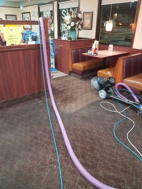

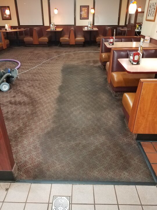

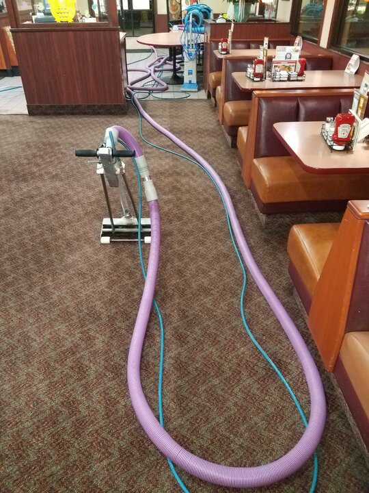

How long does it take to clean that restaurant?
That was a larger Dennys that only got cleaned when corporate got down on them. It took about4½hours with a wait for them to close one side and open the other they were open 24hrs. Its probability the worst ive done. The last person that did it left so much soap that i went thru a whole small bucket of defoamer

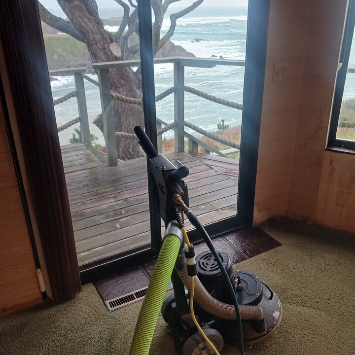

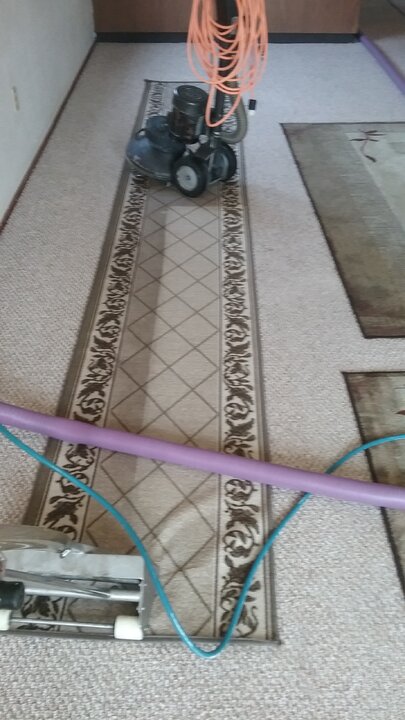

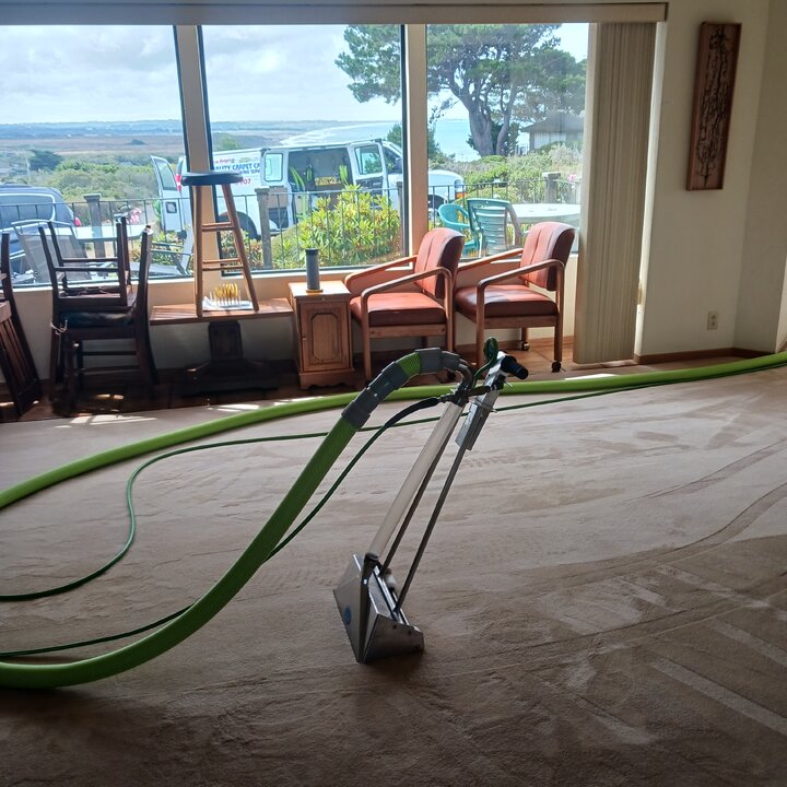

I don't just clean with the drag wand. I first lay down prespray then with my machine injecting emulsifier i throughly clean and dry the carpet with an rx20. After that i switch the machine to a acid rinse and completely redo the carpet with a drag wand. So i first clean n dry then i rinse n dry. "Two timen Dwaino cleans every carpet two times". Area rugs get only dragged because the rotary just wads um up but i drag um twice generally speaking most of the time in two different directions

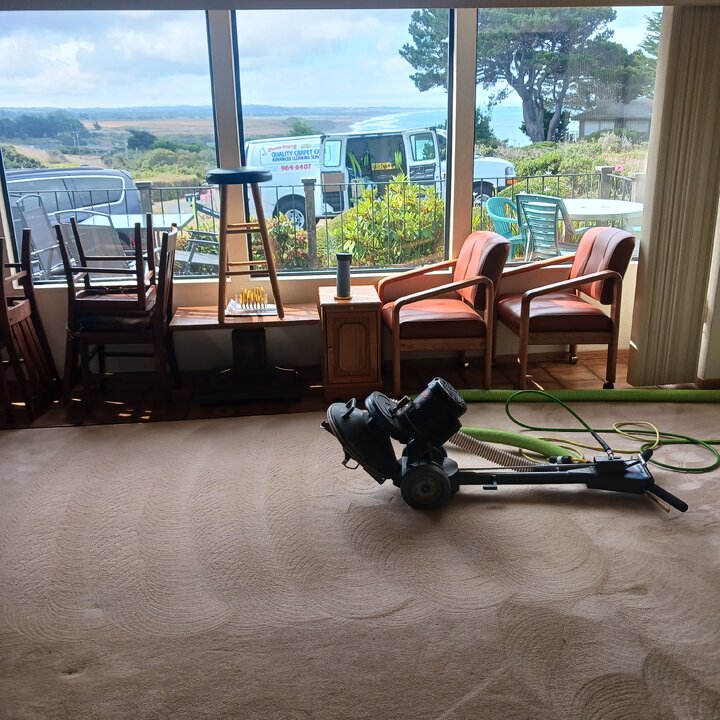

20230902_110614.jpg 20230902_113914.jpg 20230926_112346.jpg 20230926_113804.jpg 20240106_122223.jpg 20240106_124323.jpg
Reactions: frank fratto
