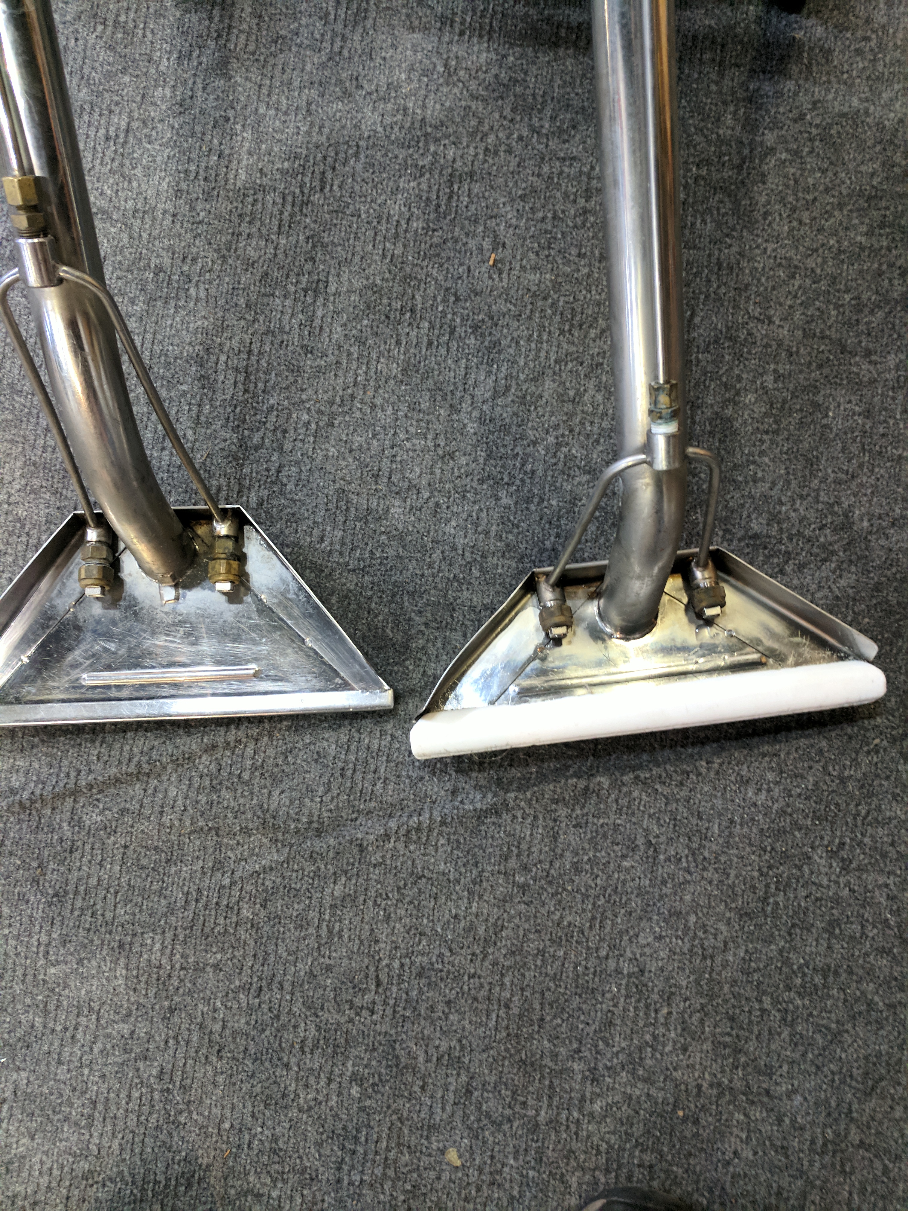

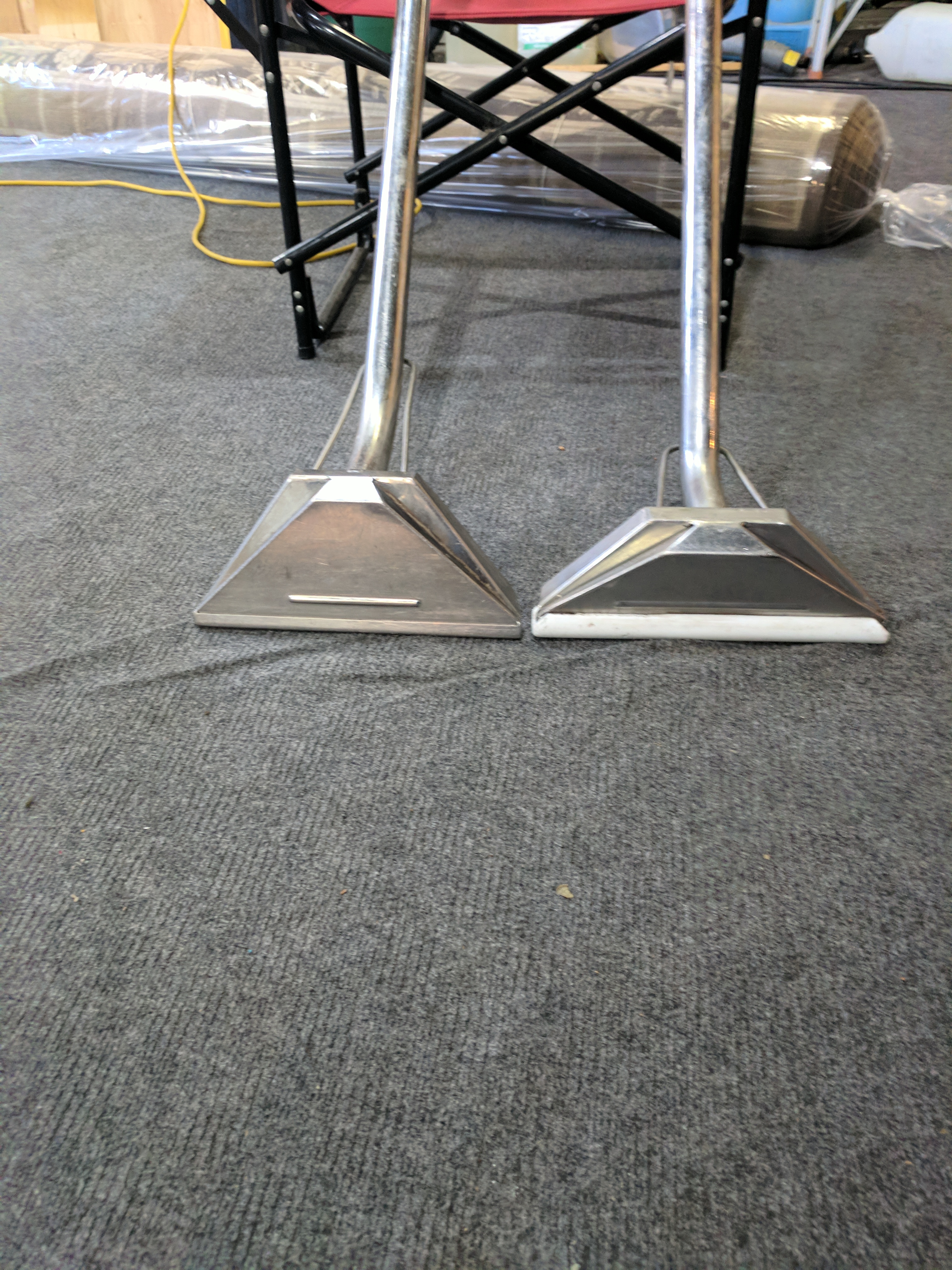

Here's a couple of aw29's. Not all are the same. One is a low profile, with the Jets closer to the carpets, minimizing heat loss and enabling you to get under furniture easier.
Reactions: Sierra Clean Care
Jim Williams
Cleaning Professional
1,465
Jim Williams
I have the low profile Westpak version. It gets under furniture great and cleans really good with those jets close to the carpet. I only use it in cluttered furniture houses. I prefer the single jet Hydrahoe in open areas. For some reason it feels better to the old back muscles.

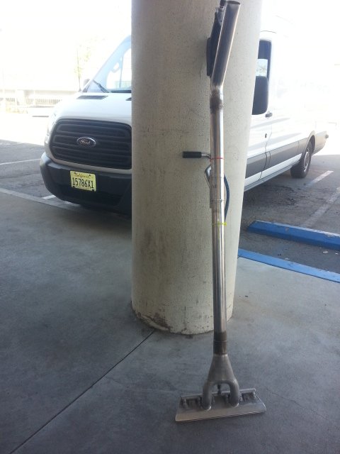

20 YEAR OLD 16 INCH CASTEX WAND............WITH A GLIDE!
WOMEN LIKE A "BIG" 16 INCH WAND!
THEY WILL SMILE AS THEY SEE YOU PUSHING AND PULLING THAT BRUTE!
