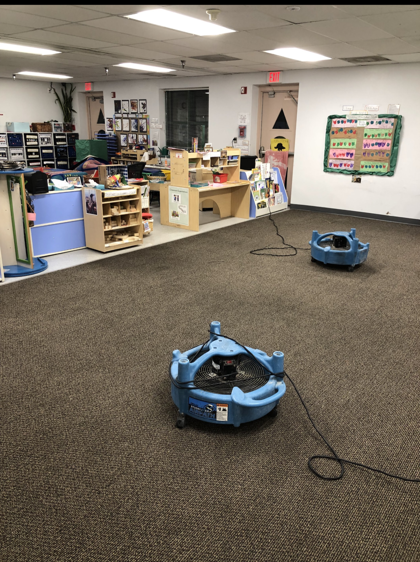

When I clean CGD that is pretty nasty, I get a cotton pad semi-wet and watch it turn black, while still not getting the carpet wet as HWE. But since I do get it more damp when using a wet pad, I just run a MF over it after.
Seem to be working because my commercial side is growing and the clients rave when I check on them.

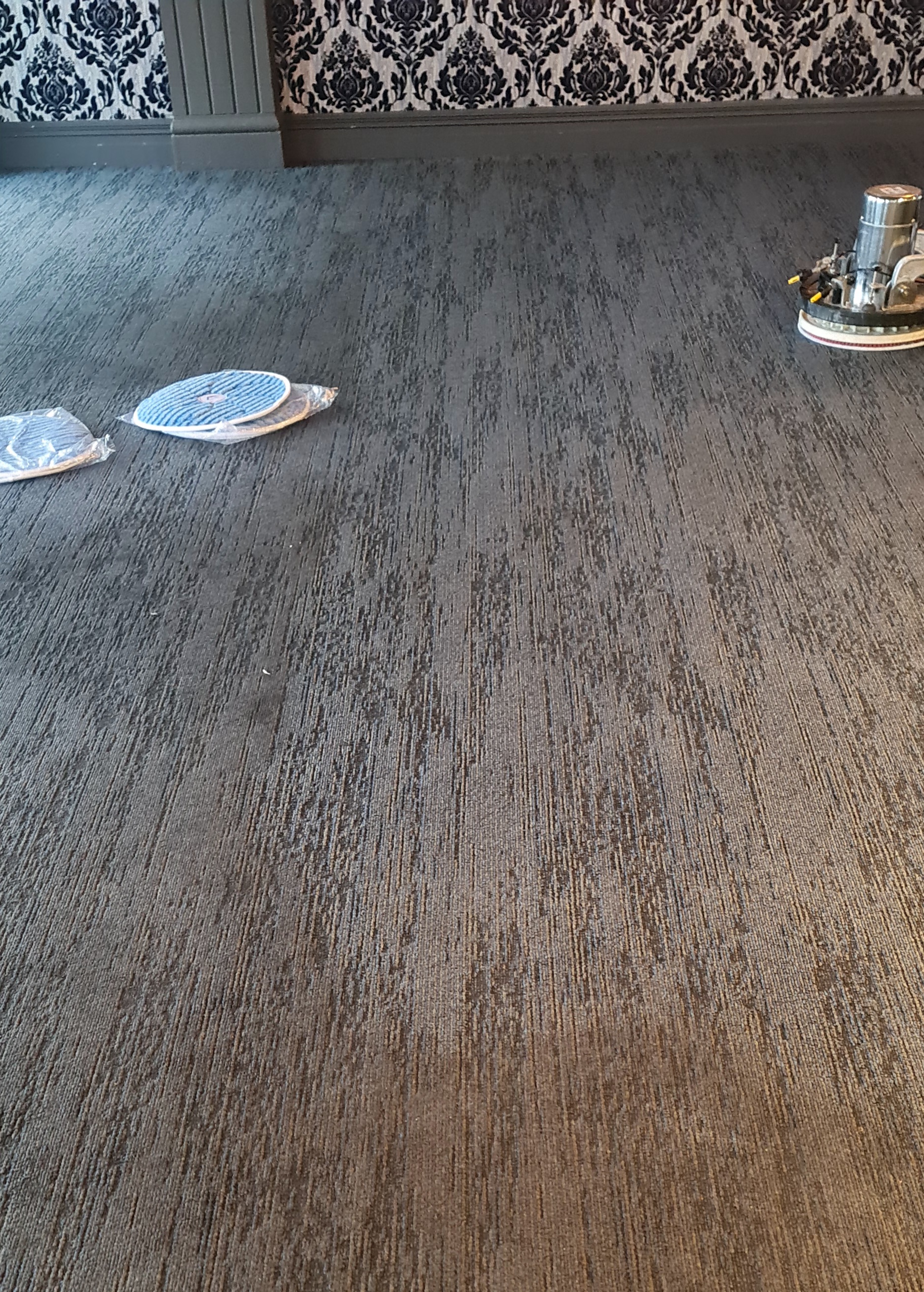

This is the thing. It's really a process for commercial carpet. That's where it works best. Like you, my commercial side is growing. Friday I have another 10 story building to do, Saturday, I'm giving an estimate on a 14 story building. I have a 32 story building to schedule in as well as 2 towers downtown in August.

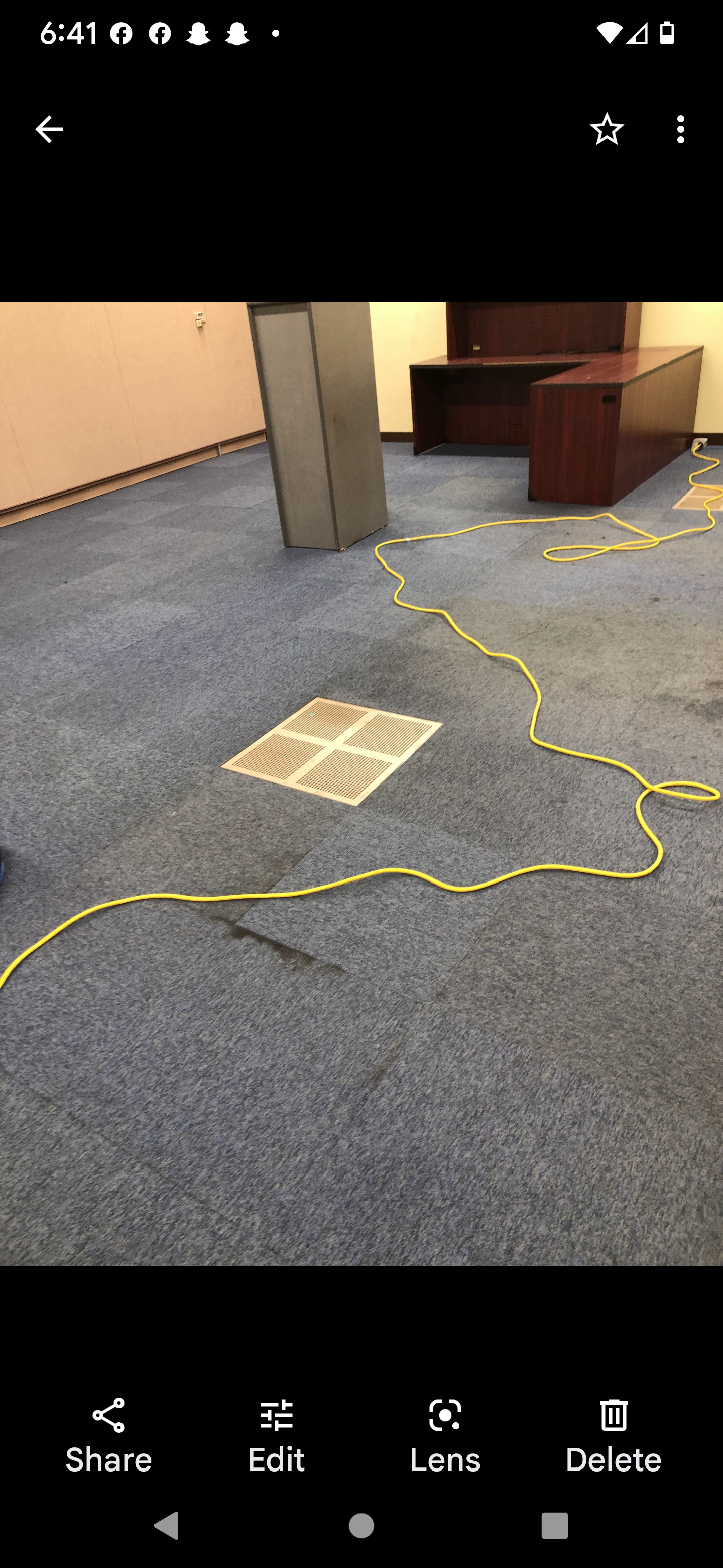

I've done both, the vlm came out great there was no way to run hoses doors locked government facility.
Would've been 350 ft run easy
Basement area that would have been swampy.
My commercial jobs dry fast!
View attachment 116394 View attachment 116395

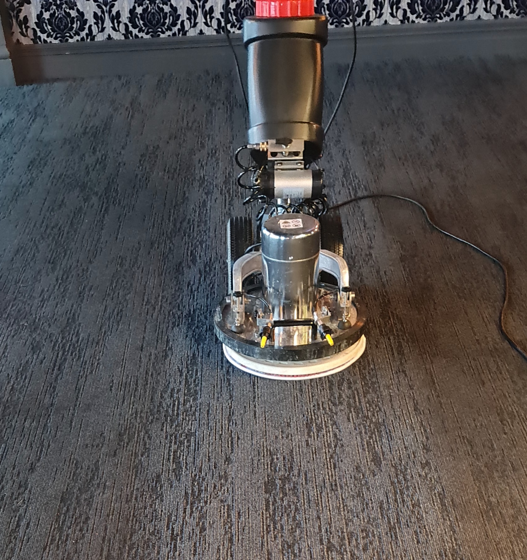

Are you running weights on the Vibe? If not, you should… the cleaning difference is big.
Meter Maid
The Undetective
Nov 29, 2017
3,860
Dayton,Ohio
Okay. I don’t. One weight? Enlighten me. What about friction?
Orbot sells a weight kit for it. The problem with your machine is it only has about 35 pounds of head weight, which is about half of the Trinity machines of comparable size. Head weight to VLM is like psi to HWE. So even if you put the entire weight kit on your machine, you’re going to be just above the head weight of competing machines.
Think of your machine with no added weight as cleaning with a wand at 200-300 psi.
Reactions: SamIam and Mikey P

Who sold it to you?
Good grief
If I sold those machines, I would practically beg everyone to buy the weight kit. When I first got an Orbot, I thought it cleaned like shit, and then I learned about the weight kit. Problem with the kit is it pain in the ass to put on and take off, so I just left my kit on, but it made the machine weigh almost 150 pounds.
115,977
You know who. Don’t throw rocks! I could’ve ordered em. I wasn’t using it as a primary tool, so I wasn’t concerned.
No, I don't know who. But based on your response I'm guessing encap store and I honestly thought the weight kids were just included with these things as they don't seem to work without them
