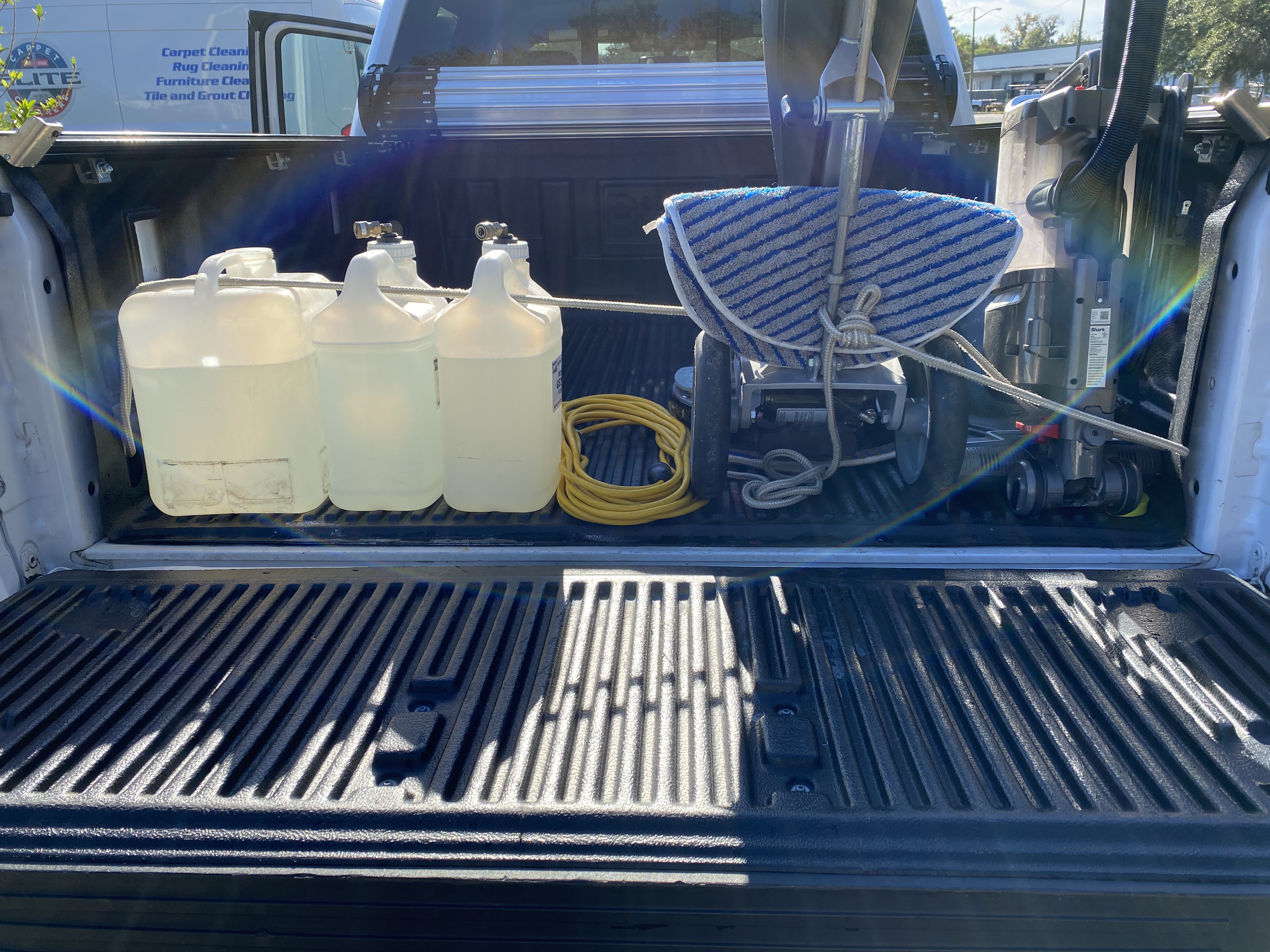

I use it occasionally on commercial. Today was one of those days. Small office in an Auto Parts Store. Carpet squares, so I always hold my breath when cleaning it for fear I’ll catch an edge of a square.
Previous cleaning of it have always transformed it back to new like conditions. I’ve always been amazed at how long it takes for the site tube to stop showing soil. Today was finally the day when it started happening. So, I had to stop and finish with the wand. It didn’t look nearly as good this time.
