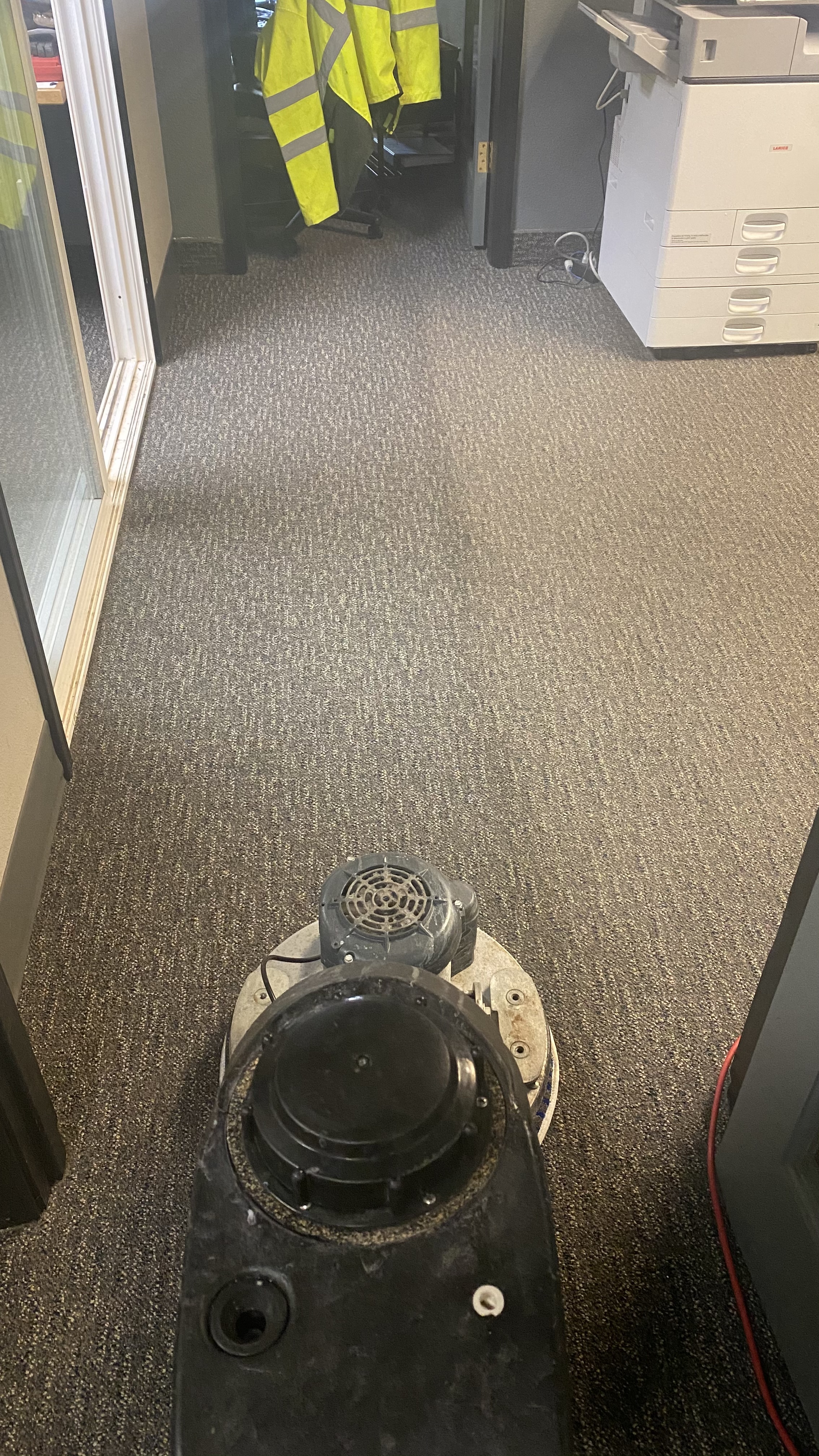

Got 4k sqft to clean today. Gotta love it.
In your pad. Right? Of course that's not possible.
Yea, you pickup some but just as when you use a Cimex, the majority is redistributed and hopefully removed through regular vacuuming.

You're either real dumb, real ignorant or just being an asshole but these microfiber pads hold a shitload of dirt

However I'm NOT foolish enough to believe that rubbing 2-feet of fabric over damp carpet is removing all the soil, as you run across it for a micro second. 🙄
How's that any different than running a wand over it for even less than 2 seconds? you're a fool if you think it's any measurable amount more..
I'm removing a shitload of dirt with these op machines
That's exactly my point against a wand. A rotary or Zipper Spinner is far superior in rinsing than even two passes with a scrub wand.
A shitload of dirt? Maybe you are, I can't say you are or aren't. But I can tell you you're leaving 2-shitloads just rearranged to hopefully be removed later, if your clients vacuum regularly.

As long as the check clears. They’re happy enough to use me yearly.
It is a great maintenance method and works well in commercial settings. The regular vacuuming large facilities do daily continues to remove the soil dislodged.
We cleaned 100's of thousands of sq/ft with it. It "looked better" than most other methods.
Cleaner...
