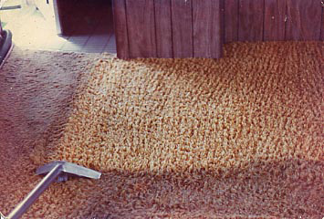

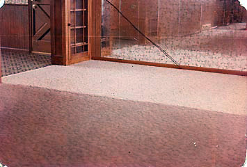

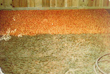

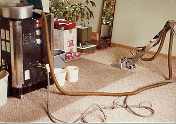

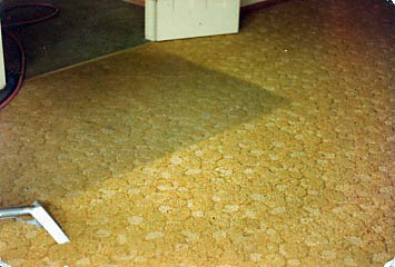

It's probably wrong to call it a rinse. When I started in hwe, we didn't have presprays. We used an emulsifier metered through the truck or portable. On really dirty carpets we would crank it up. Left a lot of residue behind. When presprays became popular, we had to learn to adjust our emulsifier to match otherwise, we would end up with a soapy mess. I use a heavy presprays most times followed by a finely diluted alkaline emulsifier that dries to a crystal. I have found it cleans better than just water and removes more prespray than just water. I am always open to new ideas but that's where i an after almost 40 years in this industry.
I have a similar experience. In 1970 I just used a carpet extraction chemical through the equipment. No pre-spray. These pictures are the results.
85EFD0B9-2D38-4BFC-A575-F21EC5AAFC4E.jpegE2037F25-5C89-452A-BDD9-33B0E6236C35.jpeg80D0B739-A0D8-4EB2-8949-8E5454461ADA.jpeg5C90CECB-A863-49D7-AFAD-E76F2B27F98F.jpeg
They're pretty cheap so I like using one.
don't overthink it, Chris.
If you're using quality pre-sprays, a little alkaline emulsifier in the stock tank is all you need .
Like Prochem Dry Slurry (one of the best)
IF using quality pre-spray, you only need 1/3 to 1/2 of what's suggested to rinse with.
and that is mostly to condition the water that aids in rinsing
I'm really surprised you're able to clean after using that wand in the pictures 49 years ago. Hats off to you Loren
that Steamway flood jet wand had some warts, (jet distortion on some cut piles) but it was a flush monster that carried heat to the fiber better than any wand on the market
and really wasn't a "man killer" to push like an unglided Ti
