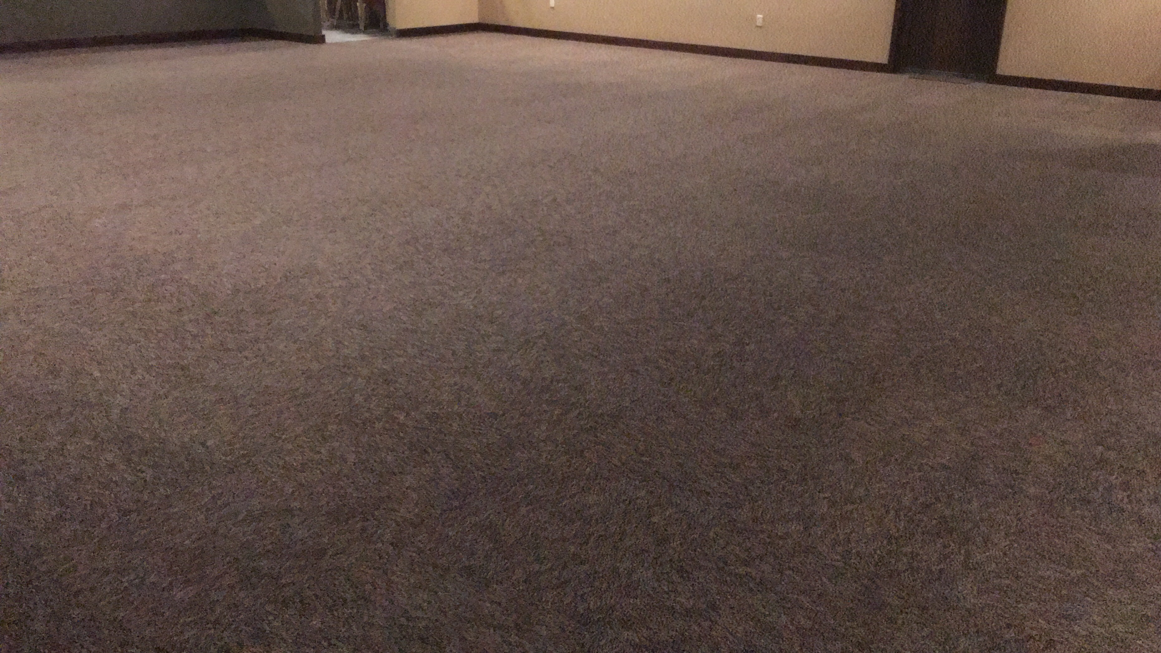

I cleaned this Friday night. I clean this every quarter. This place is always bad. I'm the fourth cleaner they've tried and also the last :) It's my Mongolian Grill place. I scrub, zipper, rinse, and protect, no blow and go for me. @anon , Wow, loading video here is now so much easier!!!!!! Good job sir.
