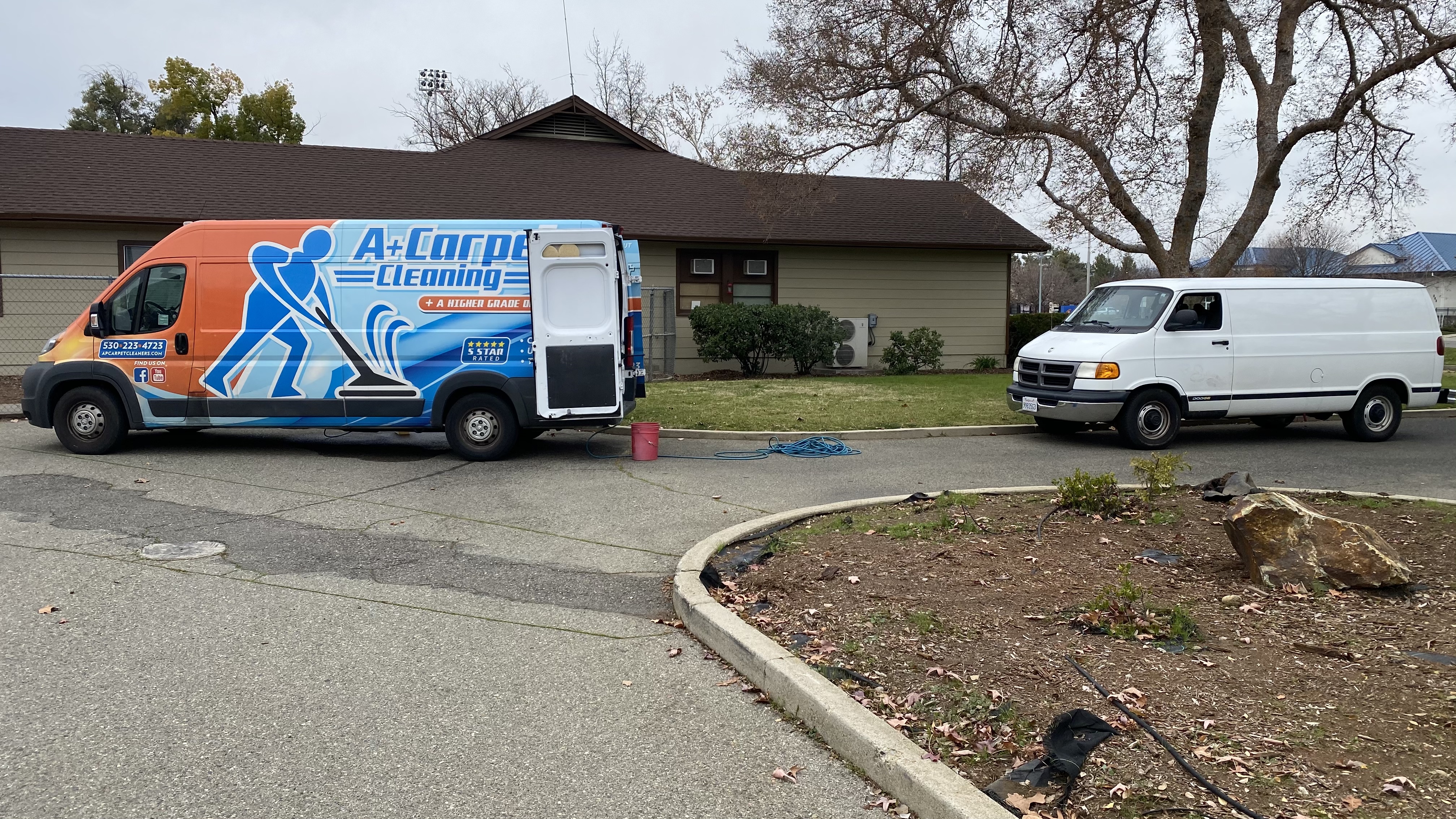

I don't know. I have a huge cal-fire job today with beauty shop boy. It's his last day. I'm not sure if I'll use my Zipper SS or my CX15 today on the long hallways. Decisions Decisions. Maybe I'll encap
Beauty shop boy. lol

We hwe part and encapped most. Zipper stayed on the van.
117,324
Sounds like spanky let you buy that van knowing full well he was on his way out.
