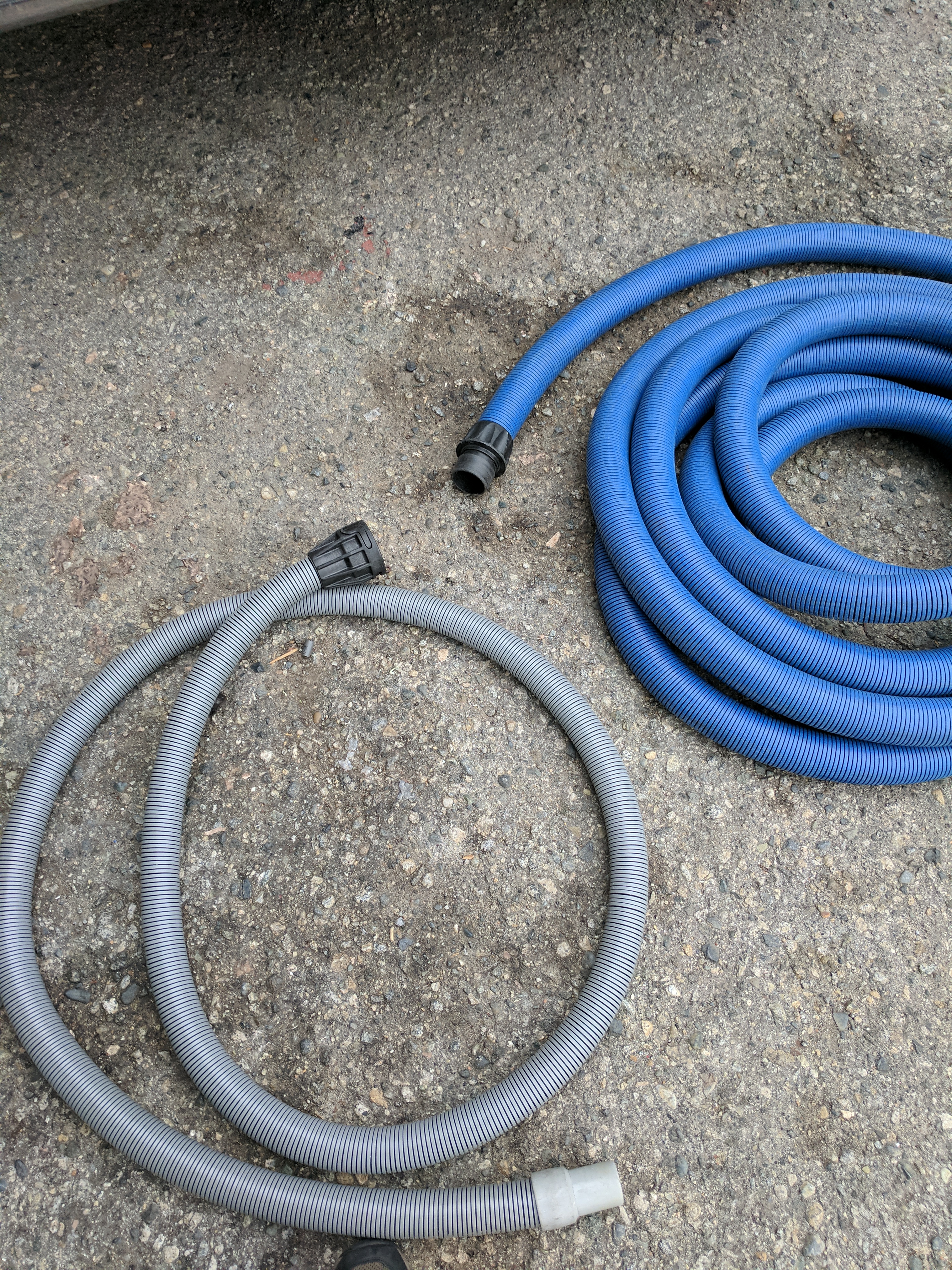

I'm thinking about just using this 2"-1.5" reducer I just found and connecting 2" inch hose to it, since I don't have the whip, or any 1.5" hose.
There's actually a youtube video of a guy using a whip and then connecting 2" directly to the wand via the reducer. You could hear the difference for what that's worth.

I have dedicated whip hoses on each tool that requires one, namely turbos, stair tools and upholstery tools.
When I get the Devpro, soon, it will be 12x1.5 like the loaner. I prefer 2", but the 1.5 dazzled us. I also had issue with the tapered hose and will instead make a whip like Mike showed in the video.
