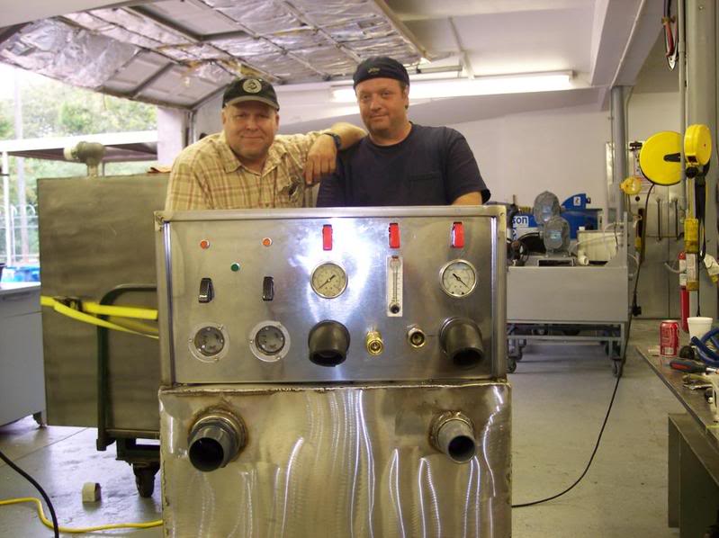

Our newest design on the Savage Electric Truckmount (The BEAST & E-BEAST), utilizes newer design principles in that the footprint of the truckmount is much smaller than the original, but there is no compromise in power available for cleaning - still volcanic heat, and great recovery, with an all new APO that has proven to be the most reliable APO (30 GPM) I have ever seen in my 24 years in this industry.
We have managed to get the system down to 1 -15 amp cord regardless of the cleaning distance. It will still outclean many large gasoline truckmounts, but at 1 cord, it is just simple to use, not power hungry, but delivers results that make your customer smile. That is just what I have observed using this truckmount for many years now.
It requires very little maintenance, and is very reliable, with an "at cost" replacement parts list for customers when they need a part for it.
