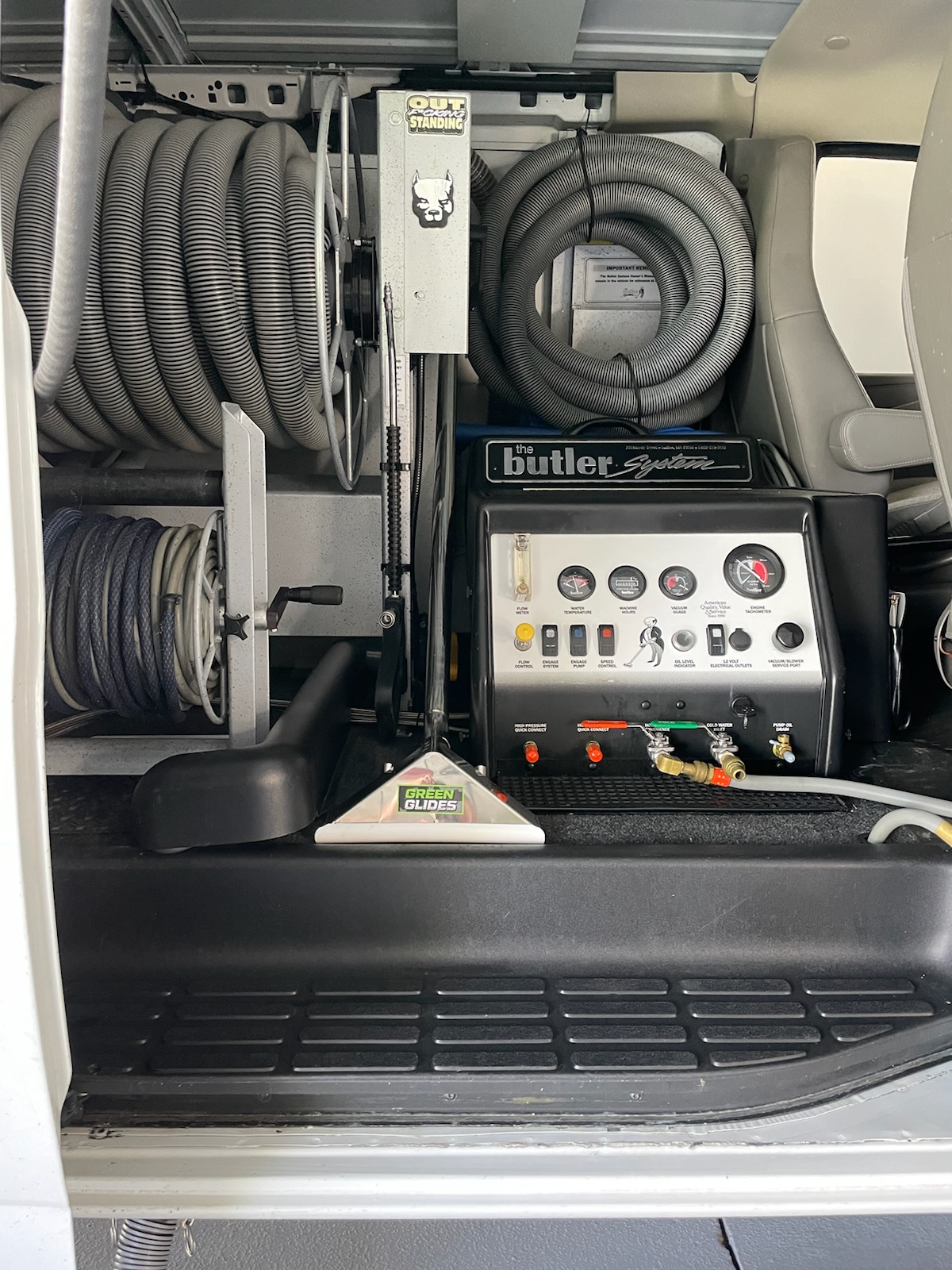

Giant truck mounts, 4 to the door, mega wands, with mega flow..
In the long come to mega complaints of slow drawing and wicking.
Why isn't it just instinctual that we turn down the water and use agitation, dwell time and better chemistry to please our customers...
I can't believe the results I'm getting with my 4 flow wand, and some balance.. IMG_20240523_141647.jpg

For now all I have is good agitation, dwell time, and chemistry. Maybe it's a good way to start.

6 flow has been our go to for many years. Flushes well, even smaller truck mounts can vacuum well enough to leave the carpet dry enough to avoid wicking. Just need to pay attention to what you are doing.
Time/Efficiency.
Agitation and dwell time require more time if they are going to replace flushing and agitation via impact. While there are exceptions there is usually an upper limit to the number of dollars a customer is willing to trade for your time there carpet cleaning and you want to make $x.00/hour.
Why wouldn't you want to clean a house with an RV jr? or a bucket and a damp brush...

Makes me wonder if your four flow hard surface wand isn't putting out twice of what it should, I'll send you some '01s to see if that doesn't fix your problem
Thanks Mike I appreciate the help. I got my portable running so now I can get back to figuring out hard surface rinsing. A two flow might allow my portable vacs to keep up with it better, flow rate has to be in proportion to suction?

RotoVacJr to the rescue. I have been continually fine tuning my procedures for several decades. I have mentioned on here several times exactly how I achieve the fastest unassisted dry times available.
