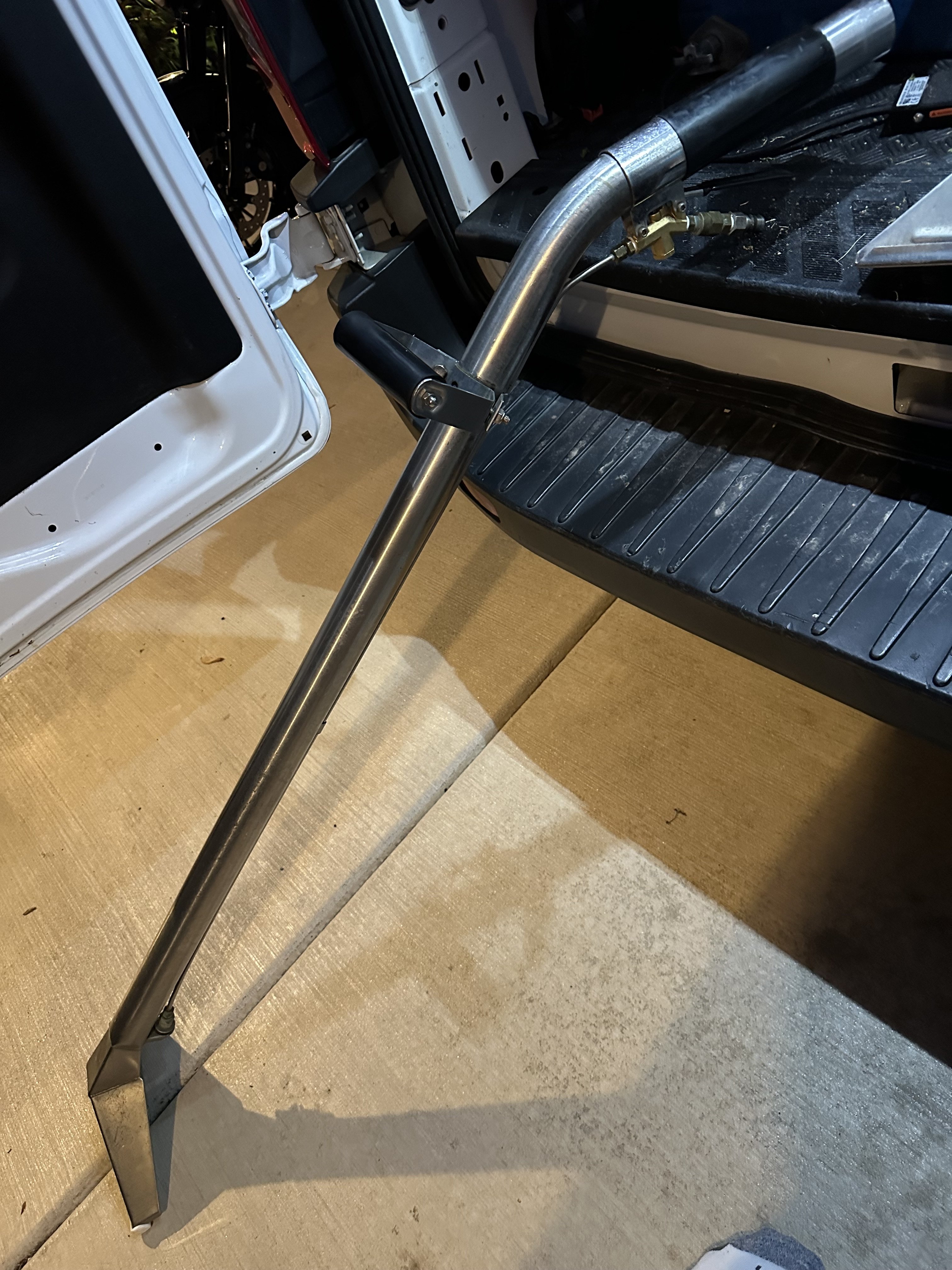

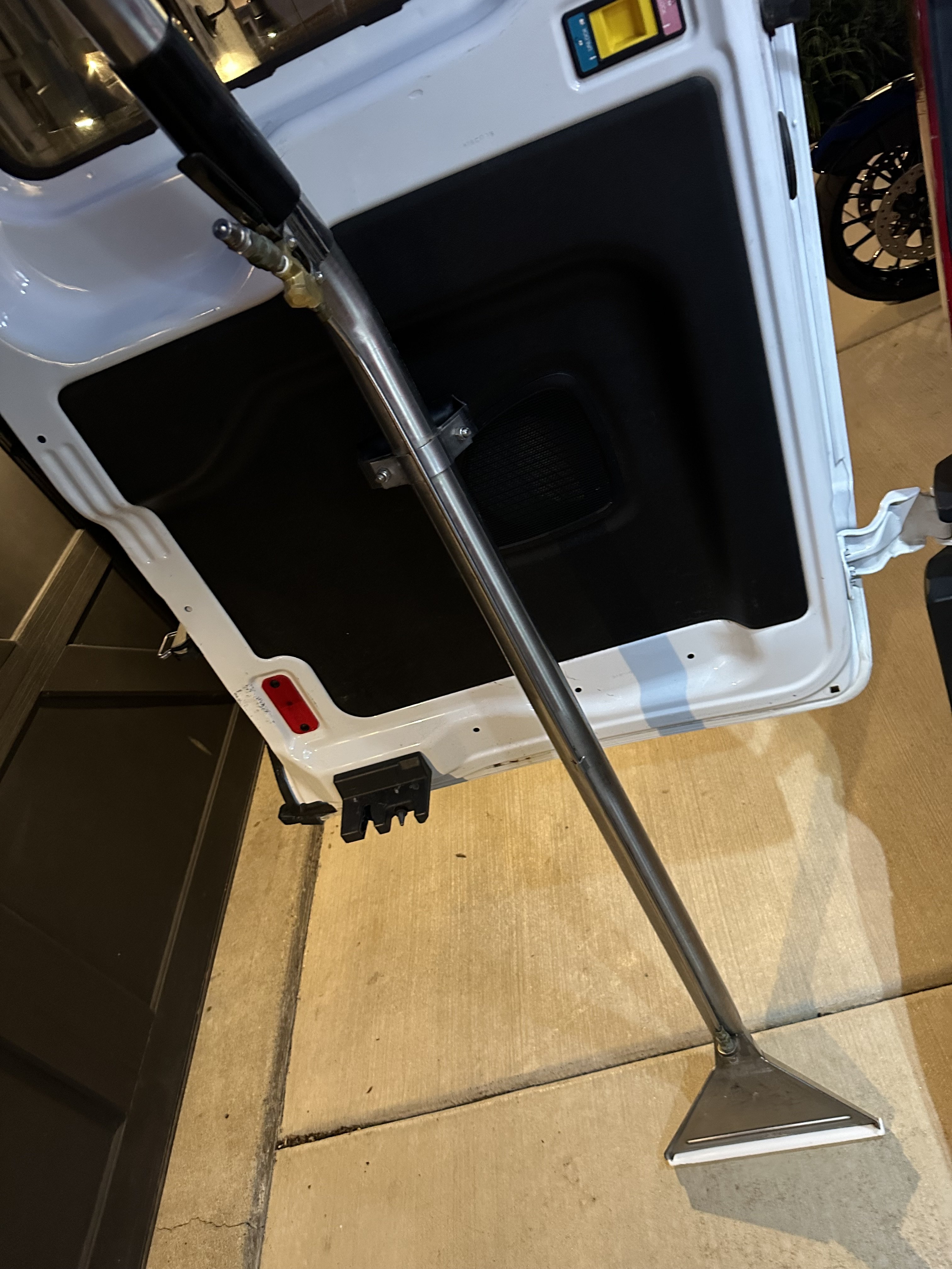

A full 2" Hoe?
Pics please
Greenie ordered it for me back in the day. I also have a 10 inch Prochem wand (I believe) that I bought from Brevick that is awesome for cleaning area rugs, no glide needed.
