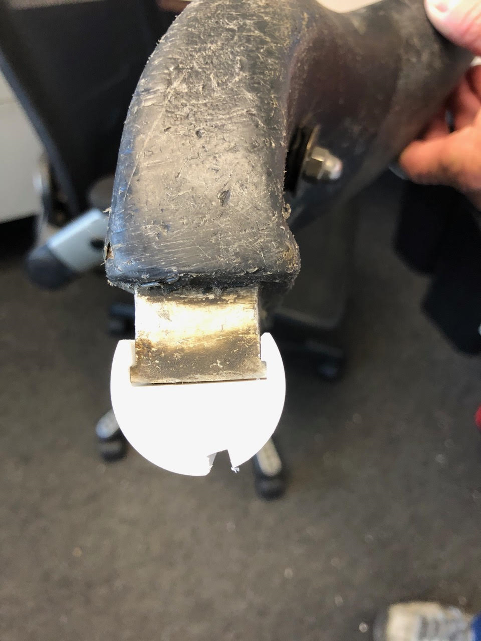

PMF, DANG, Conway and Westpak would have made all their wands with a slip fit for glides?
Only Zipper and HydraMaster appear to be paying attention.
Here is an internal fit brush glide on a SSTi, Teflon conforms and goes in easy, Delrin, not so much, back to the drawing/cutting table....

"slip fit" example, set screw holds it in place.

towards the end of Lisa's GG career, she started asking cleaners to provide measurements of wands rather than use the actual wand for fitment devlopment.
Its a bit shocking at how off a few popular Glides were. One in two hundred would complain, and we thought they were the crazy one, turns out they were right and the other 199 idiots would just heat up the glide, bash it on with a hammer and use goop to seal up the leaks.
I'm quite proud of our current, corrected line up now...
