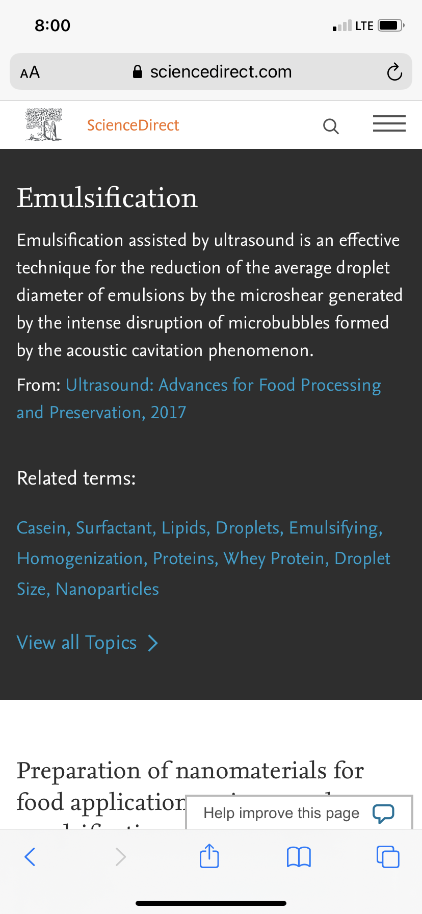

Have another cup of Joe, and lets hear your thoughts on quantum physics and how it relates to emulsification
