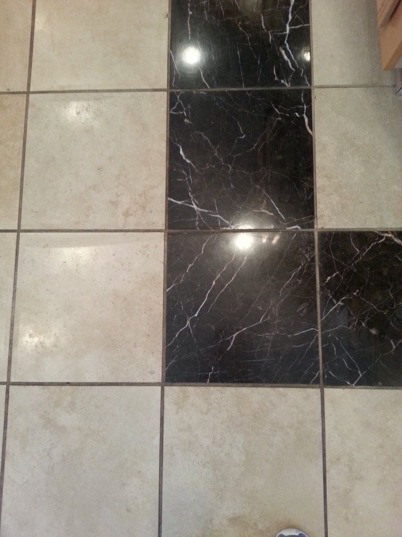

Hey Mikey would you use regular tile cleaner and a spinner on this marble tile?
50,038
Procyon, Power Max, Flex w/citrus, whatever is mixed up already.
Don't stress over it.
