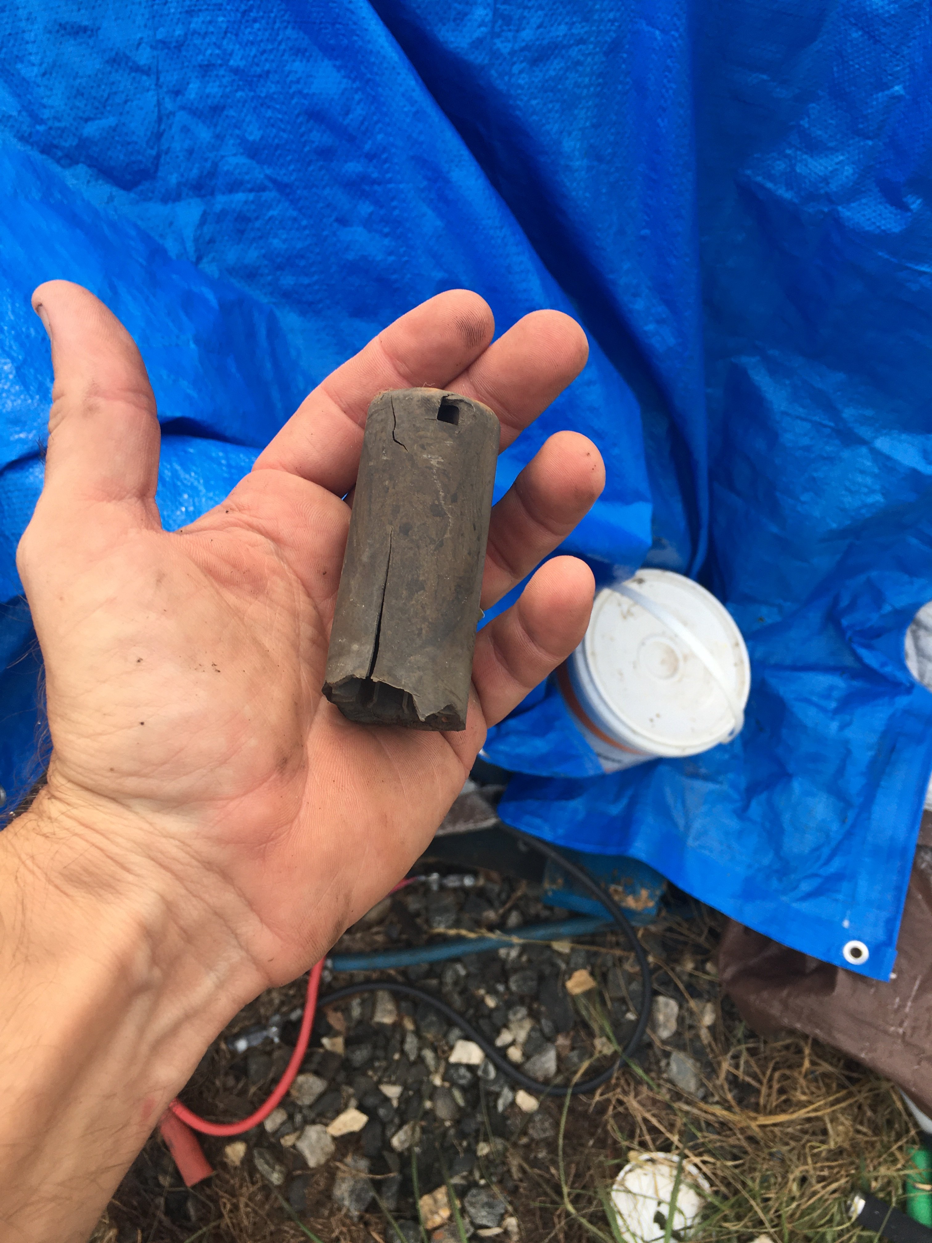

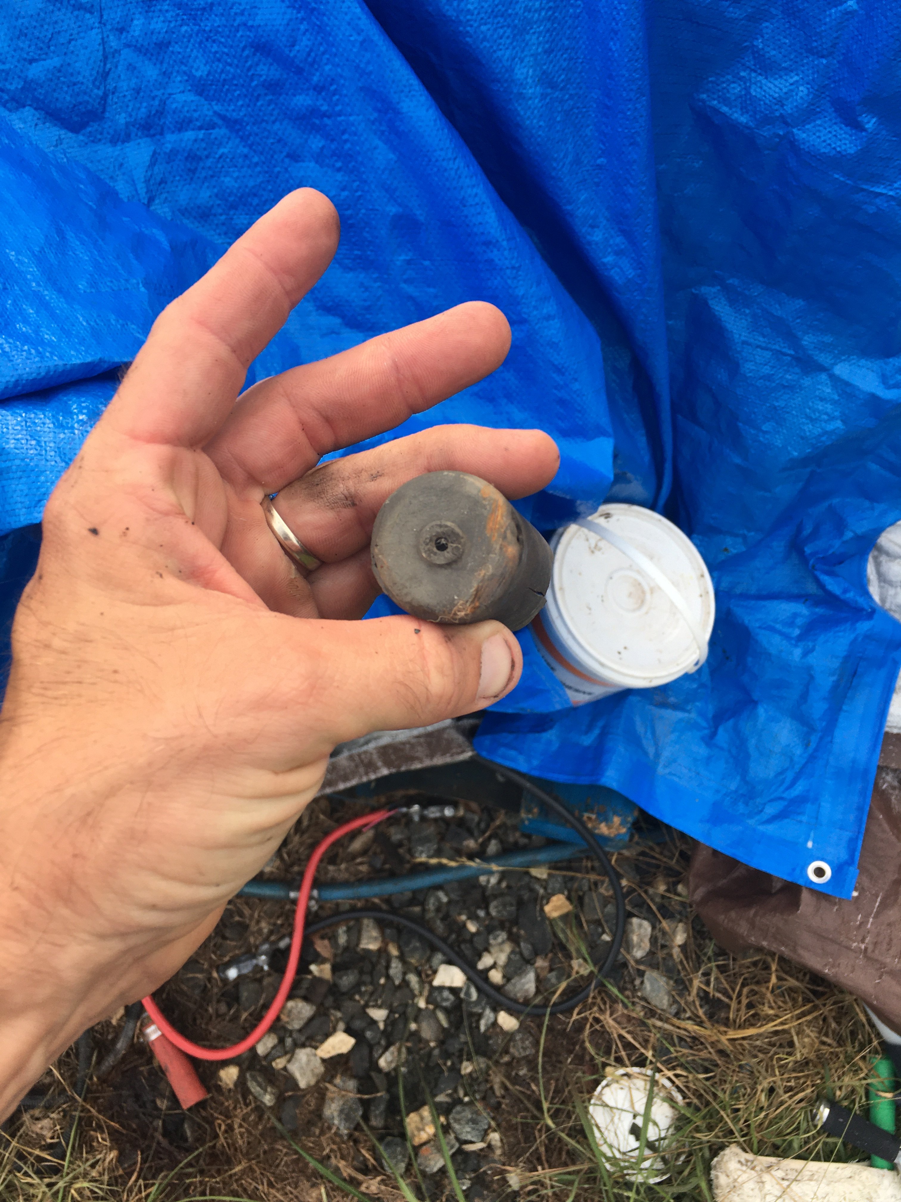

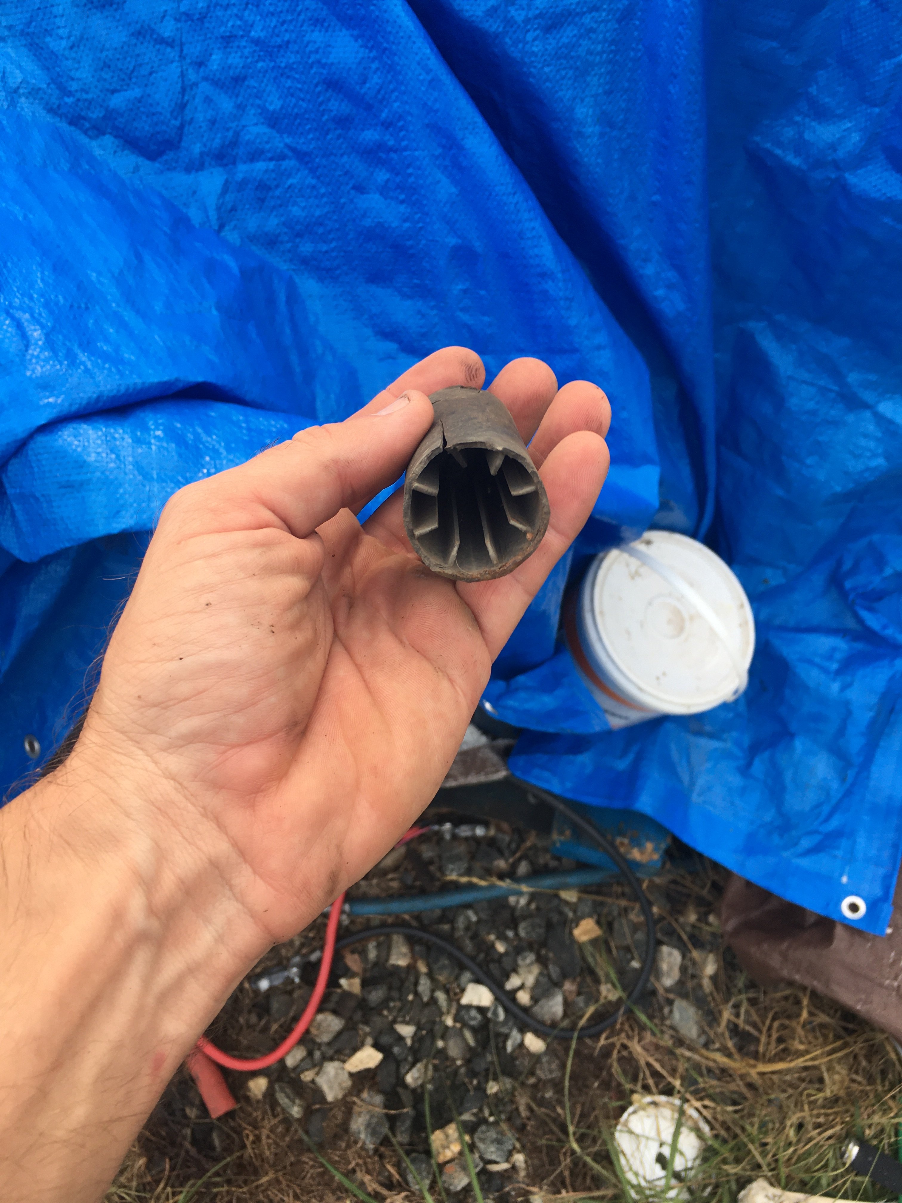

and on my spare parts machine, I discovered this thing sitting in the silencer when I removed the blower a few weeks ago. There's no way it would've survived in one piece if it was sucked in through the blower. It had to be purposely put in there to do nothing but rattle. If the truck mount won't stop rattling, just go buy another one.
View attachment 118250 View attachment 118251 View attachment 118252
You guys never replied to this comment on how this could've ended up in the silencer in one piece on my scrap machine I bought. Any thoughts?

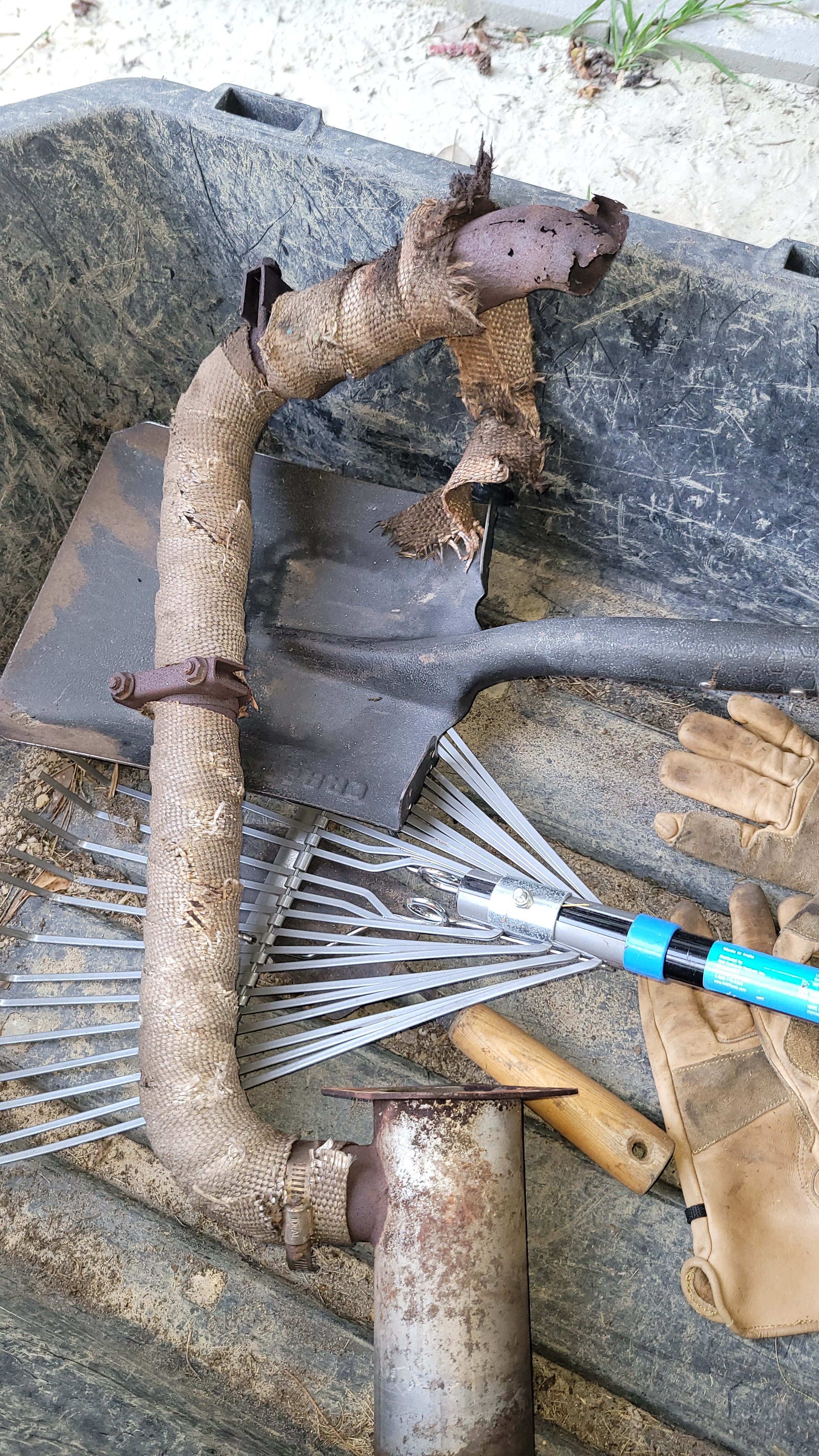

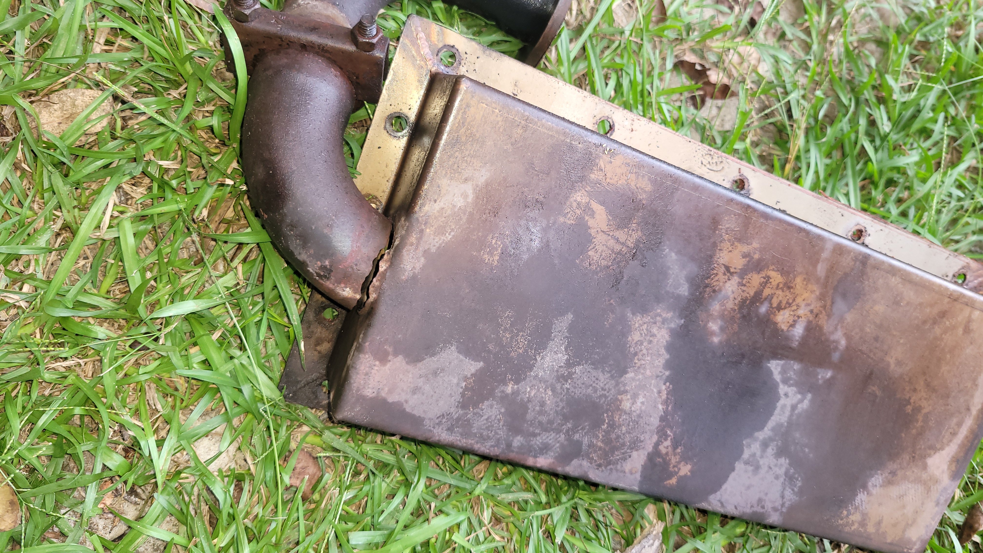

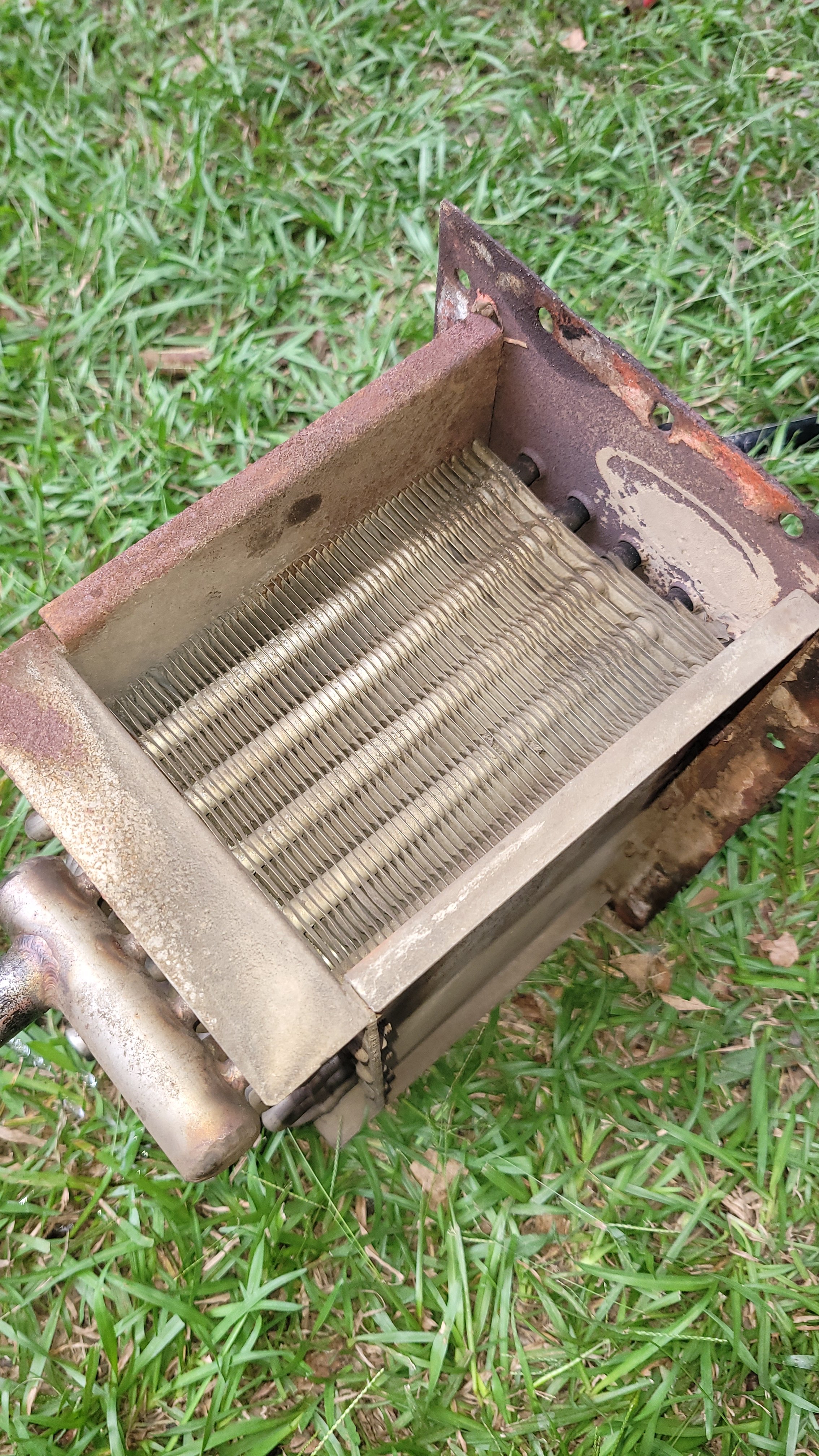

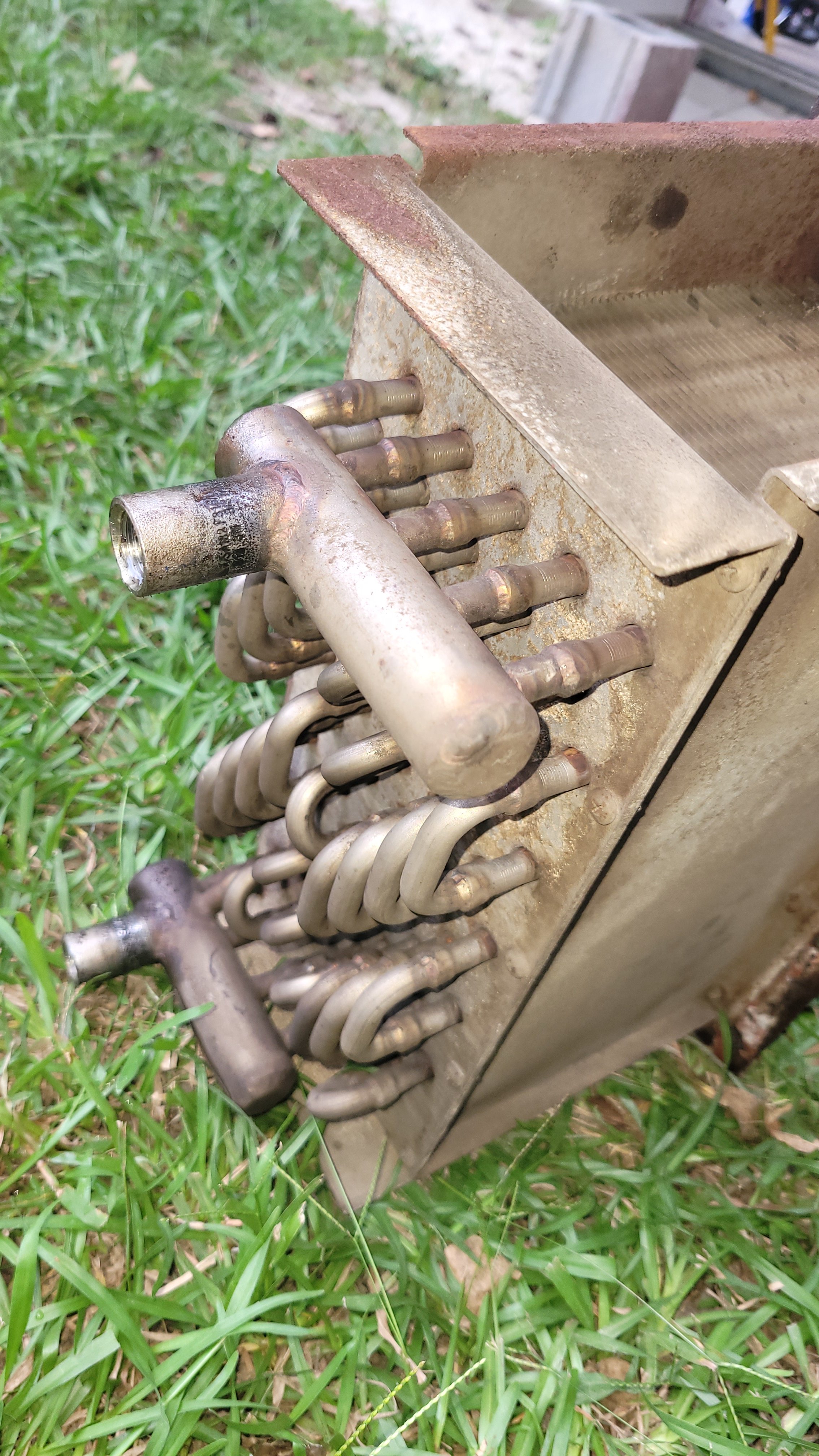

Amazing what 1 bad wire will cause but it's running great now I just need to get my heat exchanger welded back from where the exhaust ports rusted through. Also for anyone looking these are the best price I've found on the oem wires that won't melt through.
In better news the heat exchanger on mine is in perfect condition just needs a little love lol. 20230807_170813.jpg 20230807_175756.jpg 20230807_185004.jpg 20230807_190234.jpg 20230807_190259.jpg 20230807_185042.jpg
