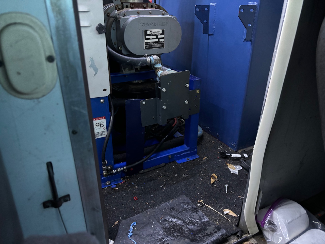

I’m taking it to the forklift later this week to move it. Rubber mats underneath are getting pulled up.
The waste tank was behind it but I think I’m gonna move it to the left side of the machine for better mounting space and ease of access to the rear and right side of the machine.

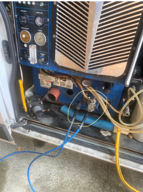

How do I remove the wires from these switches on the front of the machine? My water pump switch needs to have one of the wires pulled out, cut to fresh wire and put back in. I don't know how to pull that wire out of the back of the switch

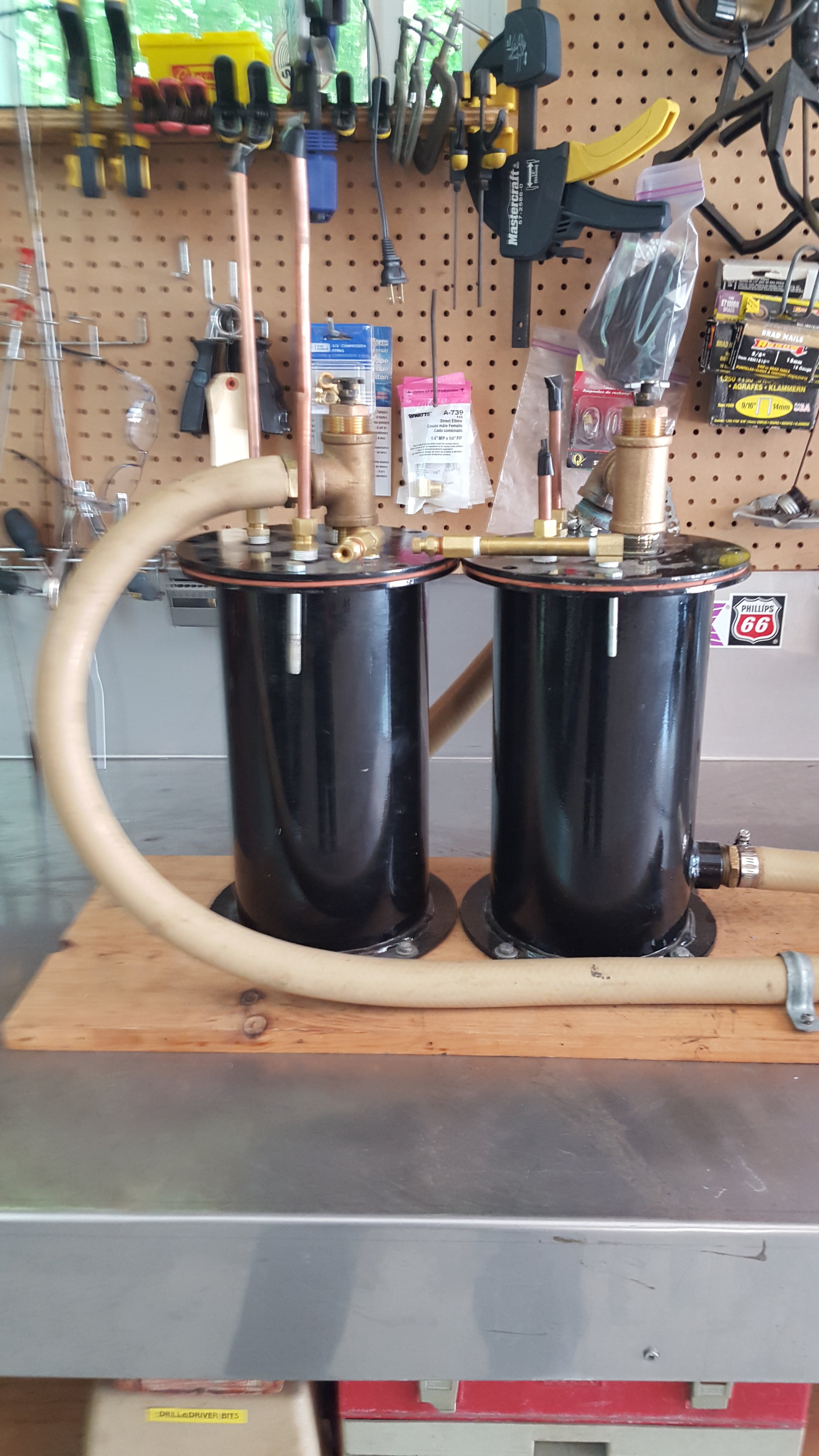

Doing a little adjusting
The coolant heat exchanger was just a last minute slap on. I never had time to properly mount it. So here’s the before and after. I bought the wrong color paint for it to 😒

On my setup, I put a 1” tee athe high point of the exchangers, and can fill with a funnel, then cap the tee. There are petcocks on the two exchangers that can be used to bleed air also.

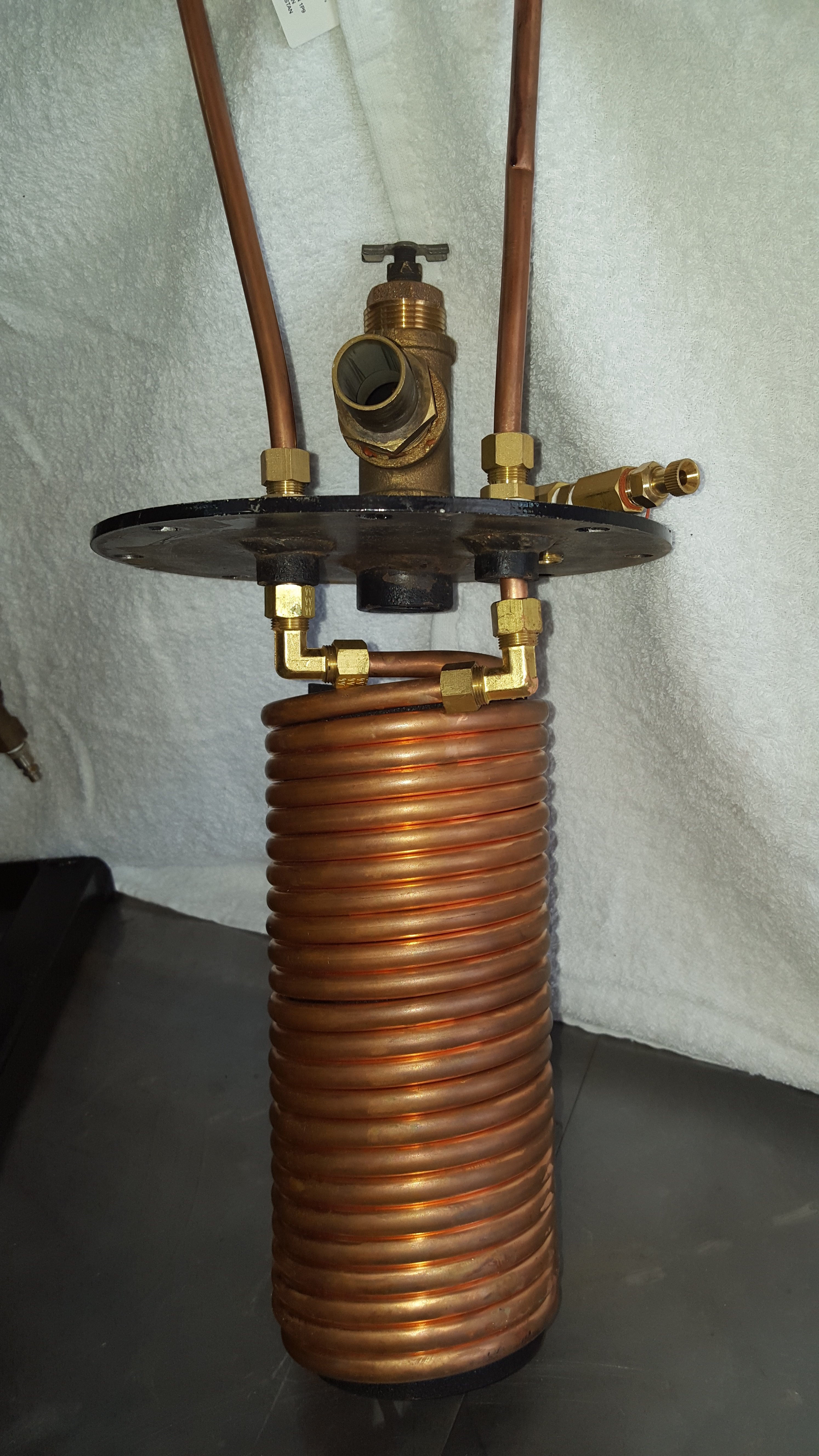

I would think most of the clutch drive units may have been designed off this brand.
These are from my AquaTech manufactured in Kelowna BC. Cleanco bought out the company years ago.
I rebuilt these years ago, and have never installed them yet. I had the coils wrapped by a company in Toronto.

Looks like a solid design. Just keep the pressure under 1200psi since the coils are copper. But two coolant heat exchangers should give you constant, reliable heat
