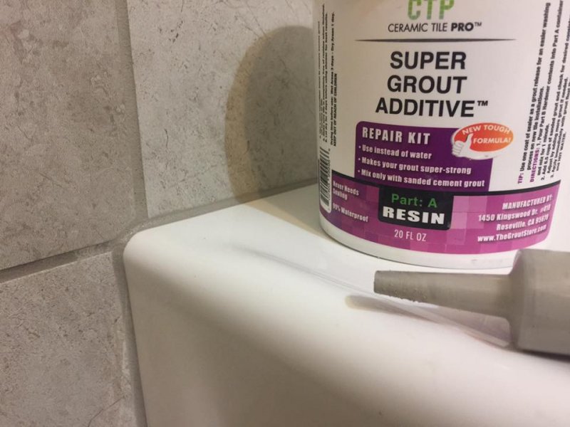

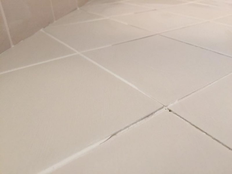

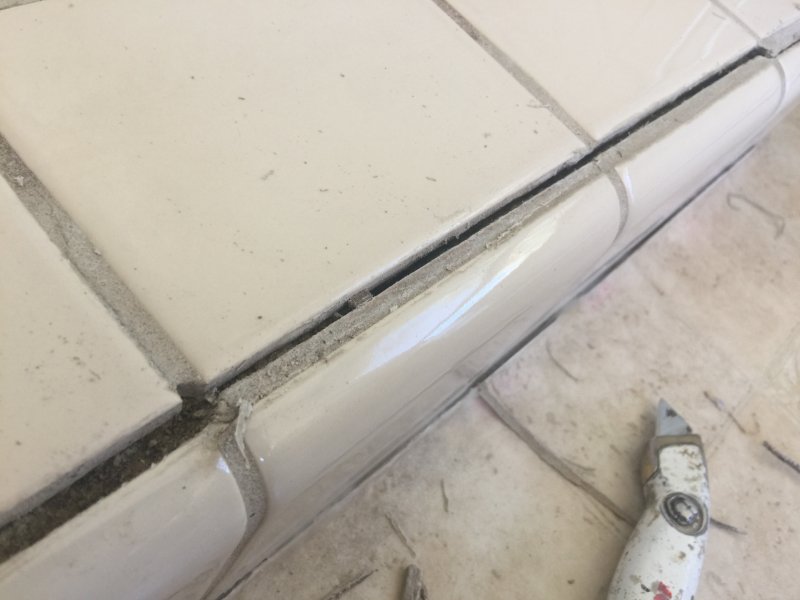

Two of these, some tile floors, kitchen counters and coming back to install Super Grout in the floor to tub joint.
You shower guys should try this stuff if you havent yet..
View attachment 74851 View attachment 74852

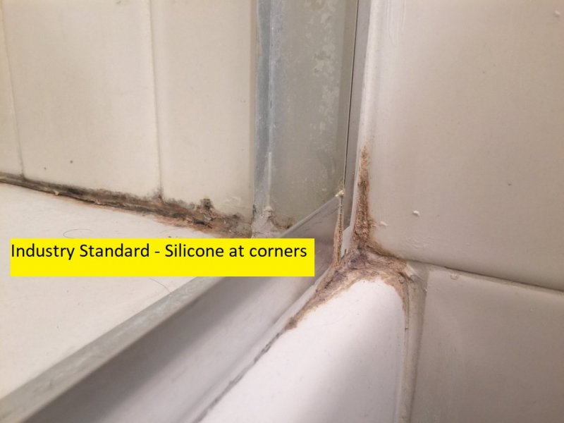

Interesting product. Couple questions
So the porcelain tub to wall tile interface has a lot movement.
How much movement will this allow before failing? breaking or losing bond. How flexible is it as a percentage?
One concern in walk in showers is floor perimeter caulk trapping water in substrate, whereas grout allows vapor transmission.
Does this product allow vapor transmission?
And if it does not, is there mold/ mildew inhibitors to keep product from staining from the inside out. Like caulk
Must the joint be completely dry before applying?

It is not flexible, it’s just the opposite, extremely strong but if you have excessive movement it may not be your answer. If you can easily move the tub or similar suggesting that it wasn’t installed securely, I would let the customer know about that and let them decide if they want to use caulk that may develop mildew issues or the epoxy which may develop a hairline crack that you may be able to fill-in.
It does do a great job on any and all corners with minor expansion contraction without cracking. It is a good idea to vacuum any wet areas to allow the epoxy to bond properly. I don’t know if it allows vapor transmission but can ask my chemist and let you know.

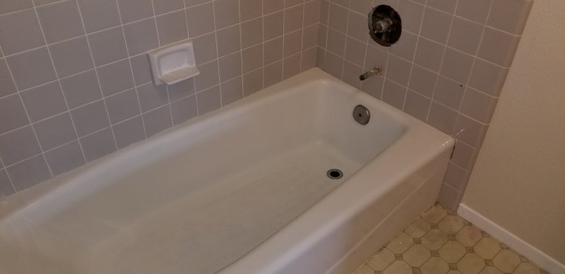

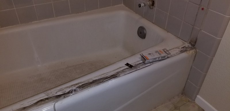

Nice job on the shower @Mikey P .
I would have used Spartan Foamy Q&A to get all that crap off from the door frame.
I don't do a lot of re-caulking but would have just used some clear silicone. Easy 'nuff just to fill the bigger voids as you go along and the appearance is very forgiving.

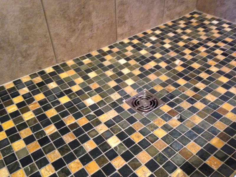

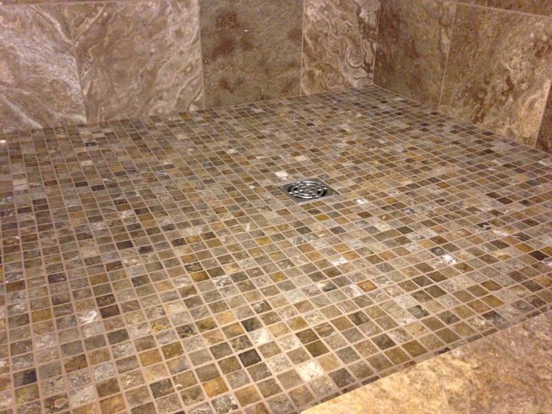

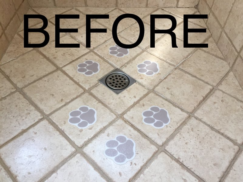

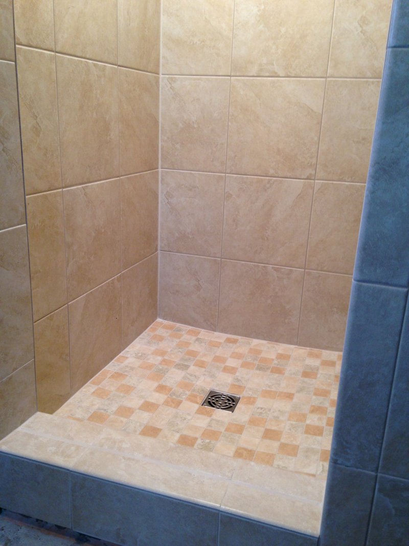

Since Super Grout Additive® is a true Epoxy, you can grout complete shower floors too.

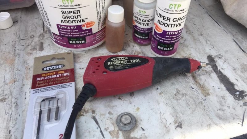

@Jason Pettinato Ive been watching a bunch of your youtube videos for a while now. One question I had was for removing old grout. In one video you removed it very easily with just a razor knife on some unsanded grout, if it doesnt come out that easily what is your tool of choice?
I saw one guy on youtube with a multi tool that he attached a shop vac to which seemed pretty fast and no mess. What do you think about the other electric tools? do you prefer to just remove by hand?
Its always a pain kind of for me, looking for a better system that is faster and clean as possible

@Acp , for unsanded or tight joints you can use the Hyde Regrout Tool with the pointed bit. Sanded or joints 1/8”+ a makita 4” angle grinder with diamond blade but that is very dusty and you have to be careful not to damage tile.

The muti tool rocks. I have a Fein tool and you can adjust power but I'm sure any other MT would work. You can buy diamond grout cutters in an assortment of widths to match the job. I do the clean out or grinding with a shop vac running at the same time to catch the dust.

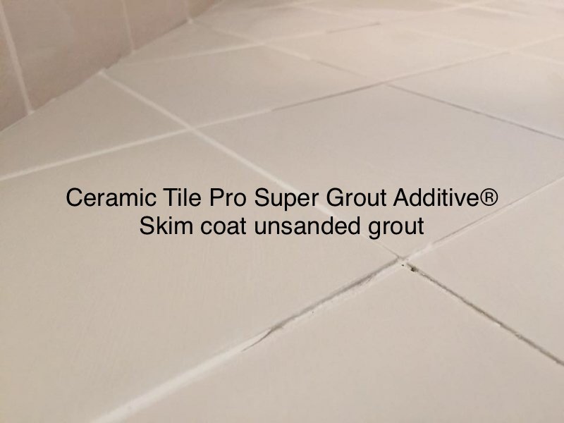

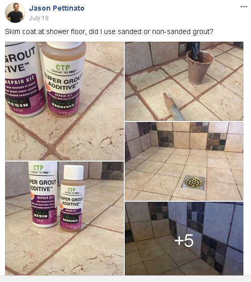

How long has your product been out?
How many shower floors has it been tested on and for how long?
The skim coating idea has me thinking...

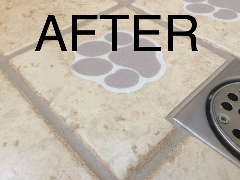

@Mikey P , Ceramic Tile Pro Super Grout Additive® has been out for over 6 years. I have personally tested it in my own bathroom at shower floor perimeters and vanity counters where tile meets backsplash. I was always having an issue where the side wall of the backsplash would continually crack. There was a pocket door on that wall so there was very little support and you could move the wall back and forth with little effort. I noticed that the epoxy grout was strong enough to withstand that movement and years later, it never cracked again.
You can skim coat over CLEAN grout. I will offer this option to my customers if the grout is badly damaged or just won't come clean. I specialize in shower restoration work so most of the repairs are shower floors which happens to be one of the hardest areas to restore. We all know that.
