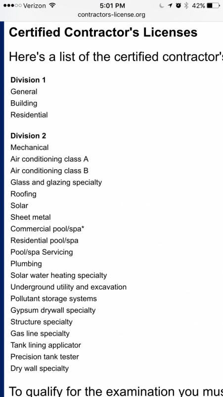

To answer your question. There is no such thing as a liscence for a tile contractor in FL.
So no.
So, TCNA recommends caulk? Your answer was vague.

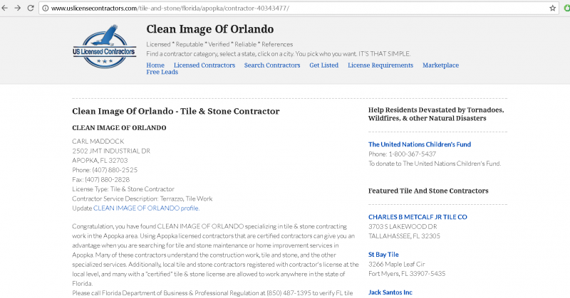

Wow, ok
Why Florida doesn't require a license to install tile is beyond me. So does that mean any Joe off the street can simply open a tile installation business? That doesn't fly here over in California, anyone caught working without a contractor's license is fined, no warnings.
What's also interesting is how your business listing has you as "
Clean Image Of Orlando - Tile & Stone Contractor".
I would post a link but this is my 24thth post and apparently this board requires 25 before posting links. you can see the link in the pic.
Let's not start doxing people..............

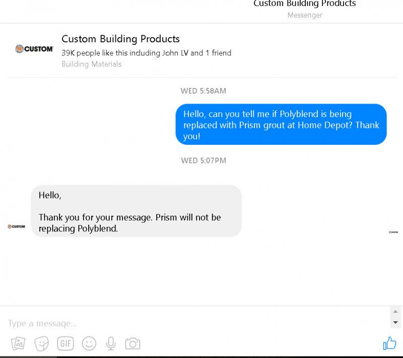

problem is that I know where this guy is going on this issue. I've dealt with it on other forums. He's posting information that is not true. Polyblend grout is available at Home Depots.
There's no intention of replacing it with Prism grout. I messaged Custom Building Product directly through facebook messenger where they confirmed what I have been saying.
I respect other individual opinions but have no problem expressing my views and will continue to do so if need be. Were all big boys here so a little heated debate is good.
The only threats I see are from you telling me I'm moving on if I don't shape up. I'll do that for you.

Boy, some how I missed this.
In response to Jason
- I am a contractor according the definition:
—a person or company that undertakes a contract to provide materials or labor to perform a service or do a job.
And I am liscenced to perform these services.
I don’t know about that website you posted.... I challenge their “verifying” as those phone numbers are pretty old, 1is dead other not been actively used by me in over 15 years.
