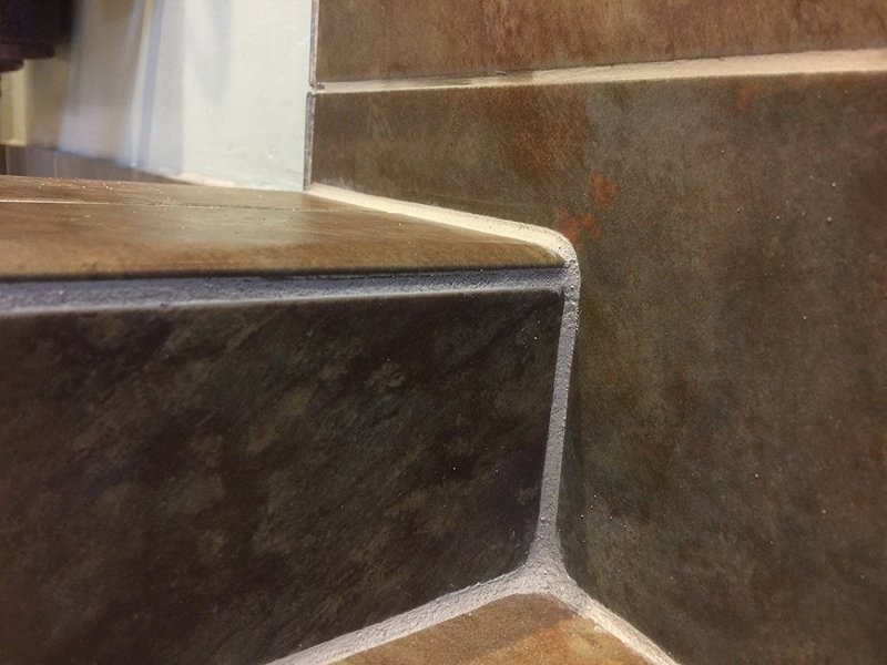

@Jason Pettinato in the videos I got the impression super grout additive was a substitute for silicone caulking on the joints, but you mean your using to skim over grout in shower pans?
The other video it looked like grout bond was used for re grouting the shower completely.
Oct 12, 2017
26
Roseville California
Jason Pettinato
@Acp, yes Super Grout Additive® is used to replace silicone and caulk. You can also skim over existing clean grout.

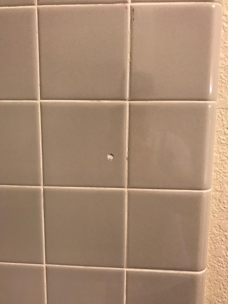

115,966
Jason my guys tried filling holes left over on a tub enclosure wall from the mollies.
They could not get your product level with the tile surface, it sort of dimple'd in..
Any tricks?
Reactions: Jason Pettinato
Oct 12, 2017
26
Jason Pettinato
Any tricks?
@Mikey P , here’s a tip. Pack those holes first with a thick mix of grout/water as a backer, then mix Super Grout Additive® as thick as possible for the final layer. Have your guys apply more epoxy on this one.

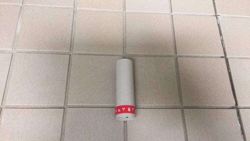

1 more question for ya. Say you walk into a new job and your going to skim coat the shower pan or an area and want to match it to the current grout on the walls or theres a color in general you need to match elseware in the bathroom.. what would be your technique for matching the color perfectly? any tricks you can share?
Oct 12, 2017
26
Jason Pettinato

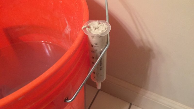

@Acp , get yourself a grout color chart and find the closest color. @Caulkmaster will mix different colors for custom matching. I always save any remaining epoxy as a sample and label them for future reference. Tip: let the remaining epoxy dry in the syringe overnight then remove it for a perfect cylinder core sample like in the pic.
You can also use the bucket to hold the syringe when filling. It frees up your hands.

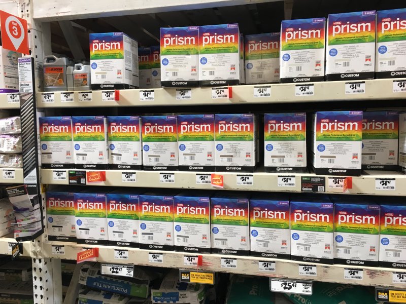

You must mis read my post Jason....it’s a hydrolic based cement.. what we used to use in my former life for under water repairs on concrete pipes.
Think of it as grout on steroids.
And yes-FACT- our local HD stores only sell this as your only option for cementitious based grout. I’m sure you still go to website and get it....
Simple economics... and long overdue.....why carry 2 of every color...
The Mapei. Version of the same (FX) however will scratch polished TML

I’m not a slab guy but I agree that there are polyester products for seams that are better suited.
As for Home Depot no longer selling Custom Building Products Polyblend grout, sanded and unsanded, that is not true! Cement based grout is considered the staple of all grouts and the discontinuation of such is highly unlikely.
Well......truth be told...... looks like you might want to follow up with trends in your field.

Interesting, all the Home Depots in my area haven't changed over. I still see Polyblend in the left side of the pic you provided. both sanded and unsanded. I can understand why they are doing it to simplify the grout selection process. Maybe I'll have my chemist do some testing with this stuff out of curiosity. Thanks for sharing!

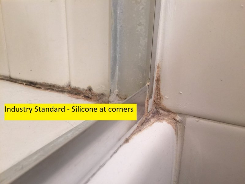

Dosnt TCNA recommend caulk for change of planes in shower?

Industry standards are outdated and have been for several years. It's a fact and the pro's that run tile/grout restoration businesses no longer have to use low quality products that typically result in call backs.
Here's what the TCNA recommends for change of plane, right out of the handbook. Industry standard but certainly not Industry wide!
